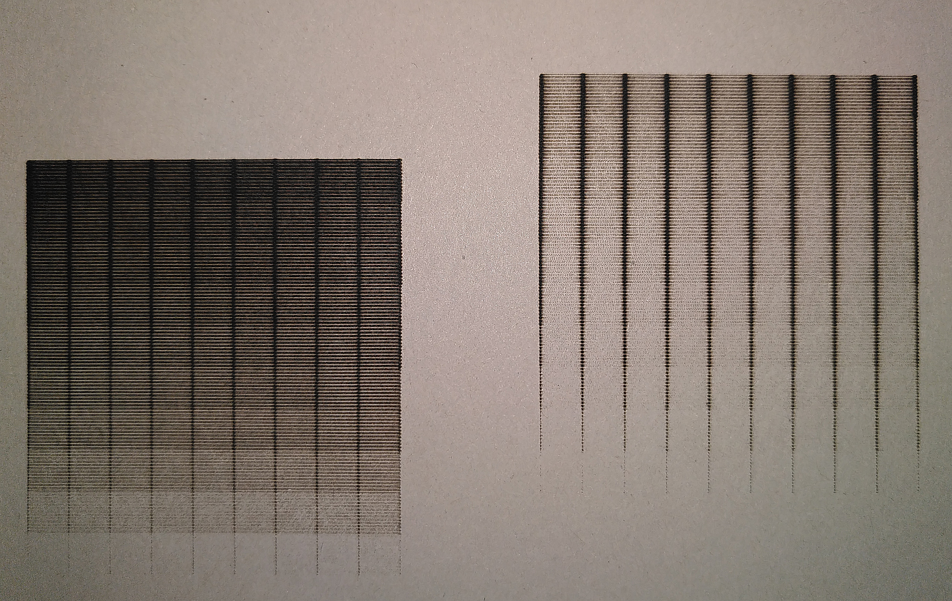

OK folks,
started to dig deeper. I wrote some G-Code that creates a 5x5 cm square, divided in 100 5x5 mm squares, each having 1% more in laser intensity: [GraySquare.nc](https://forum.snapmaker.com/uploads/short-url/sziS6earanYcHfIxUpLo6m9mvAp.nc) (70.5 KB)
I printed it with feedrate 10000 mm/min and 20000 mm/min on plain light gray cardboard. The results are… interesting, but, sorry to say, rather disappointing:
 ![grafik](https://us1.discourse-cdn.com/flex022/uploads/snapmaker/original/2X/2/2555e6c61a156d25e576cc9470e2464e78031290.jpeg)
While I in general was able to produce gray tones, they _look_ dithered.
Two possible reasons:
- PWM is so slow/lo frequency, that the head movement resolves the individual pulses. That would actually be shockingly slow PWM!
- They do not do PWM, but calculate a on/off pattern for the given intensity and feed it to the laser in software, in other words, they do software PWM - that would also be shocking - any modern MCU can do hardware PWM - why do software PWM?
Also, you can see the effects of decelleration and acceleration - the head slows down after each movement command. This is what produces the dark lines, they are not part of the GCode. I guess this is something you could work out.
I don’t think that’s the road to success, but I have another idea up my sleeve, will try this the next days…
As of now: [@staff](https://forum.snapmaker.com/groups/staff), please tell: Are you doing software PWM? would it be possible to switch to high frequency hardware PWM? Or is the laser control pin/power transistor not capable of that?
I sicerely hope they can do hardware PWM…
A bit unhappy right now…

@Hauke: Nice work! I agree that the finished result looks dithered. After accurately specifying the energy level and area in G-Ccode, the set value of energy is contaminated by one or more of the processes used for depositing the energy specified. I look forward to the results of your next test series. Thanks, I appreciate you taking out the time to work with this issue.

**Post date:** [September 3, 2020, 3:18am UTC](https://forum.snapmaker.com/t/laser-true-grayscale-instead-of-dithering/8881/11 "2020-09-03T03:18:16Z")
Thanks for taking time to test that out, @Hauke
I hope this info helps, it may just be repeating what others have mentioned in a different way.
I would think if the power PWM is constant but velocity and acceleration vary, there is no way to get a consistent gray scale line.
If you made velocity constant (with zero acceleration), a single PWM should give a more or less uniform output. However turning and changing direction would suffer (unless you went slow, maybe took the power down too).
Alternatively, there would need to a map of velocity to PWM in order to produce a more or less uniform line.
A final option that comes to mind (granted it would take much longer) would be to laze several passes, each one adding another layer of darkness. Each pass would add more contrast, and would always tend toward less information.

**Post date:** [September 3, 2020, 7:52am UTC](https://forum.snapmaker.com/t/laser-true-grayscale-instead-of-dithering/8881/12 "2020-09-03T07:52:24Z")
> [@ODINITE](#):
I am rather sure that with a bit of G-Code tweaking I could get velocities constant enough to not have the adverse effects of acceleration and decceleration. Did not bother yesterday to solve this, because it became clear to me that with the current PWM I would not gain anything. Multiple passes might improve, but only for materials that blacken slowly. If they go dark fast, even one pass might be a problem in darker regions.
What I will try the next days is to play with a combination of laser power, dwell time (like in the dot mode of Luban), and perhaps even slight defocusing of the laser. I guess that might work, but it will be _much_ slower than the mode above. The 5x5 cm square was done in ~5 mins, I expect the “dot” method to take hours to draw the same square… Which is a pity, because with fast PWM I’m 99% positive that my method above would just work, and imagine what this would mean for the speed to laser down an image!
Finally some tweaking needs to be done since the blackening is most likely a process following an exponential curve, but when I reached that point, I’d already be very happy…
**Post date:** [September 3, 2020, 8:21am UTC](https://forum.snapmaker.com/t/laser-true-grayscale-instead-of-dithering/8881/13 "2020-09-03T08:21:24Z")
Just did a bit quick’n’dirty research - as expected STM32 microcontrollers (which I understand is what Snapmaker uses) are well enough capable of hardware PWM at higher kHz frequencies. Doing the math:
Suppose movement speed is 100 mm/s, then:
PWM = 100 Hz --\> 1 pulse per mm --\> unbearable bad
PWM = 1 kHz --\> 10 pulses per mm --\> assume 10 pixels per mm --\> 1 pulse per pixel --\> 255 grey tones possible with 8 bit pulse width, assuming that the material reacts perfectly (which it would not)
So I’d say 10 kHz PWM would give the necessary flexibility to account for material variations, perhaps higher resolutions etc. And of course: The more the better! And most MCUs are absolutely capable for high frequency PWM.
