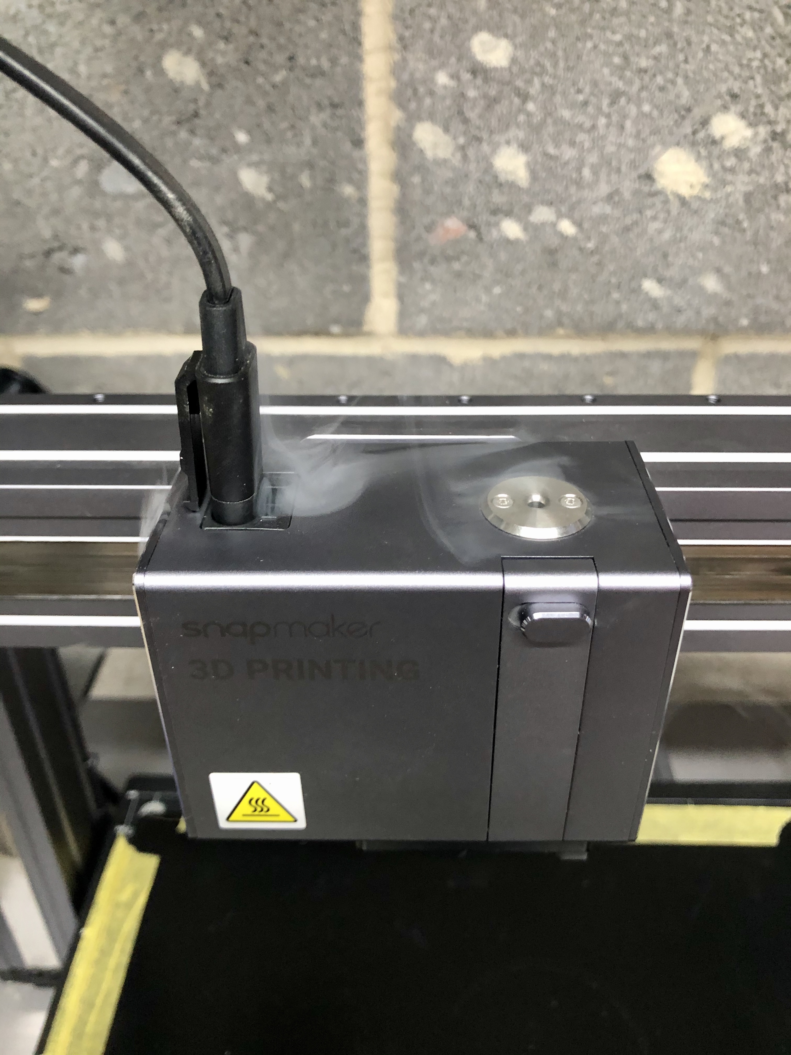

I received my Snapmaker 2.0 A350 early this week. I started with 3D printing an all went fine (mostly).
I decided to test out the laser function. Installed the laser toolhead and bed, and as soon as I turned on the power, the laser head went BANG and smoke shot out of the laser hood and cable connector. The laser head is fried.
And unfortunately, when I switched back to the 3D printing head, now the filament feed motor will not work. Other toolhead functions work (nozzle temp, proximity sensor).
It looks like the exploding laser head damaged the controller.
Anybody else had major issues like this? How has the manufacturer responded when you have defective modules?
Good luck all!

The only descriptions I’ve seen here like this are when the tool cable was plugged in backwards.

I see what you mean about the cable ends. It was a poor design choice to make the connectors so symmetrical.
But I’m absolutely sure that the head was not plugged in backwards. I distinctly paid attention to having the locking tab facing the right side of the machine when I plugged in the laser head.
The CNC head is working. I was a bit surprised since the printing head stopped feeding filament.

Update: On my last round of messages with SM support they agreed to send me a new laser head and controller under warranty. They sent me “diagnostic” firmware to try, which basically re-directs the toolhead to the Add-on1 port. Under this port the filament feed stepper does function, confirming that the controller got damaged along with the laser. An advantage to this is that now I can use the 3D print head under the re-directed firmware while waiting for the new modules.
So I had to push a bit, but the company is honoring the warranty. They must be losing significant money over this poor connector design (and I suppose I must have plugged the laser head in backwards). That’s too bad. The fit and finish of the machine is otherwise impressive. I look forward to further exploring its capabilities.

You’re lucky. The same happened to me. I immediately admitted to possibly having plugged in the plug the wrong way around. Here’s what I got for a reply:
If you connect the machine in the wrong way, the laser module burns out and the issue laser module damages the controller.
That is why the gear in the printing module does not rotate. But the printing module itself is fine.
So now you need a new laser module and controller.
