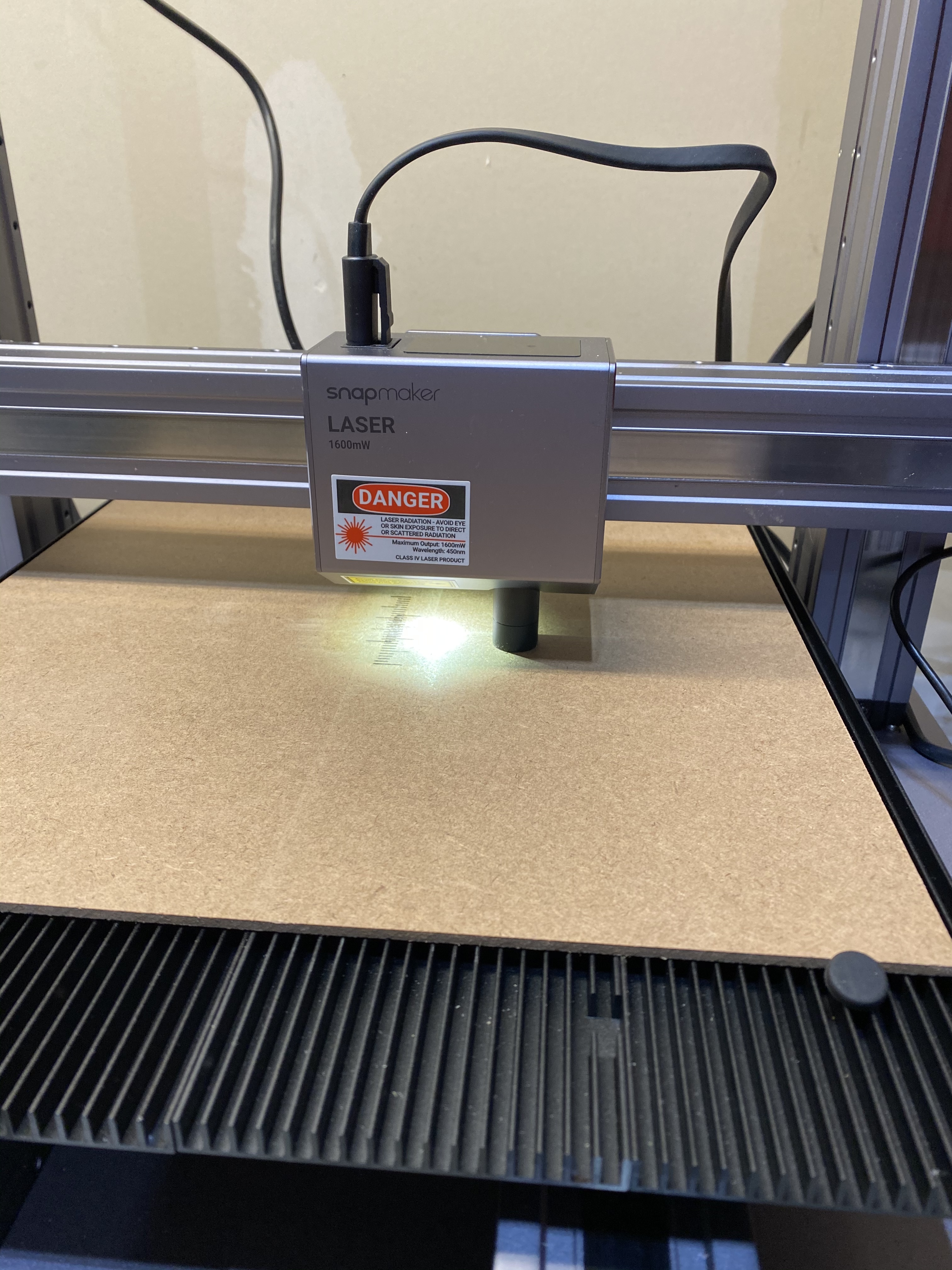

Hi, I just got my A350 and assembled it. When doing the initial calibration the laser module just smashes into the work surface repeatedly.
I have tried it a few times and it does it both when laser engraving the lines for the first test and then sometimes it will laser engrave but when the camera goes to check the work it smashes into the work surface.
I have turned it off and waited. I have unplugged the module and I have hooked it up to my lap top. Nothing seems to work.

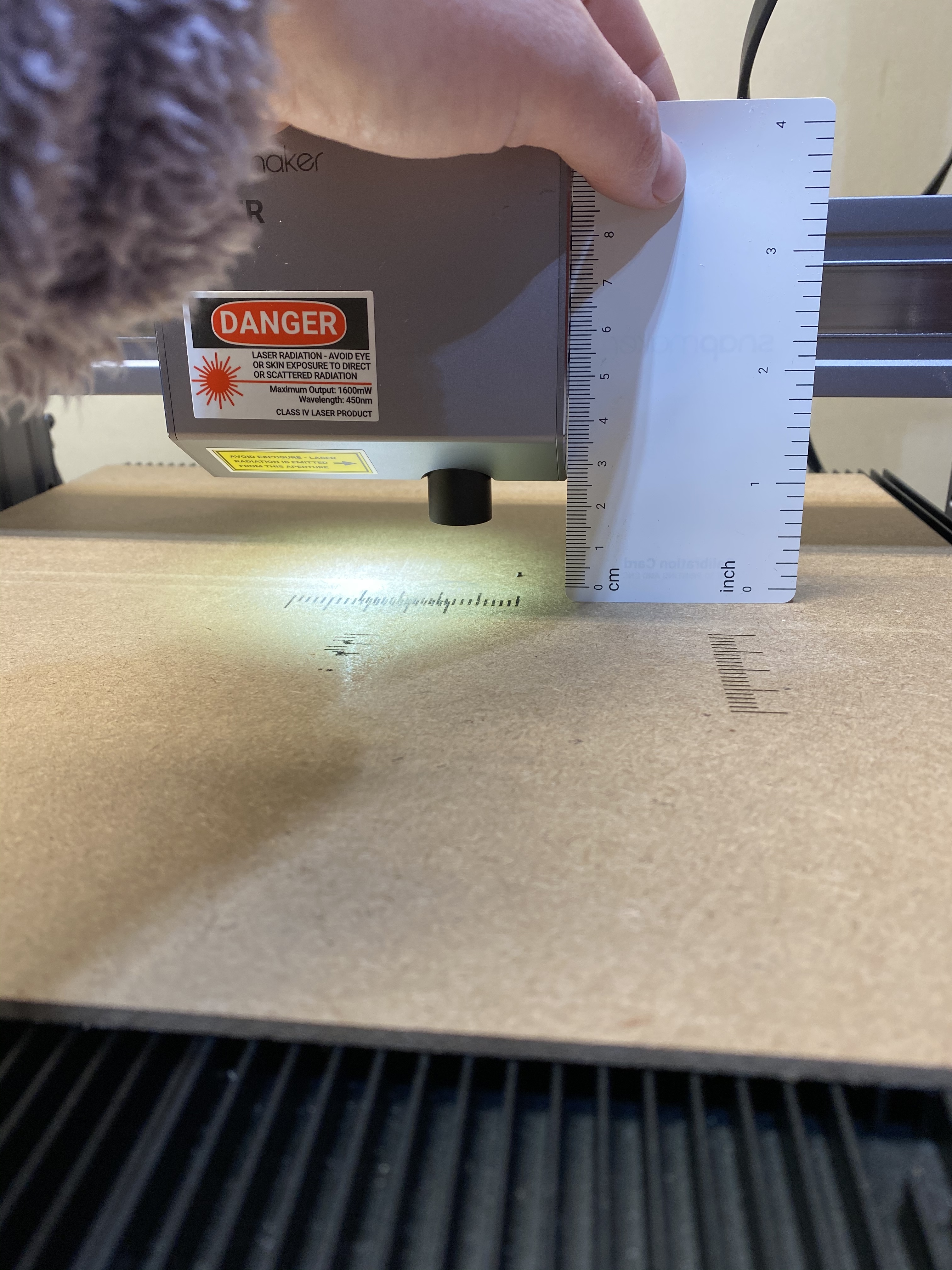

If you manually jog the controls on the touchscreen so that it’s close to the bed, Z height wise, about what Z value is that?
My focal length is also about 24mm, and if I jog to a Z height of 24 (without the lens hood on, I just keep mine off) there’s like 5mm or so of clearance.

1. take the lens hood off and retry. It looks like you’re getting a burned line, so it’s close to being correct.
2. I was referring to jogging the controls outside of calibration, just the normal controls option from the main touchscreen window. You can’t move Z when setting work origins
That coordinate of Z 34 seems a little high for how close it is. I know you said the nuts are down, but could you post a picture of the platform underside anyways?

1. I’ll try the lens hood. It’s like it that much too close to the material
2. I can only move the x axis (laser module right?) down it will never move up.
3. I am using this to set up [https://youtu.be/Spya1Zs2xsU](https://youtu.be/Spya1Zs2xsU). So I touch the laser to the work surface when setting to work table height correct.
4. I assume i am doing something wrong. This is my first attempt at anything with this machine.

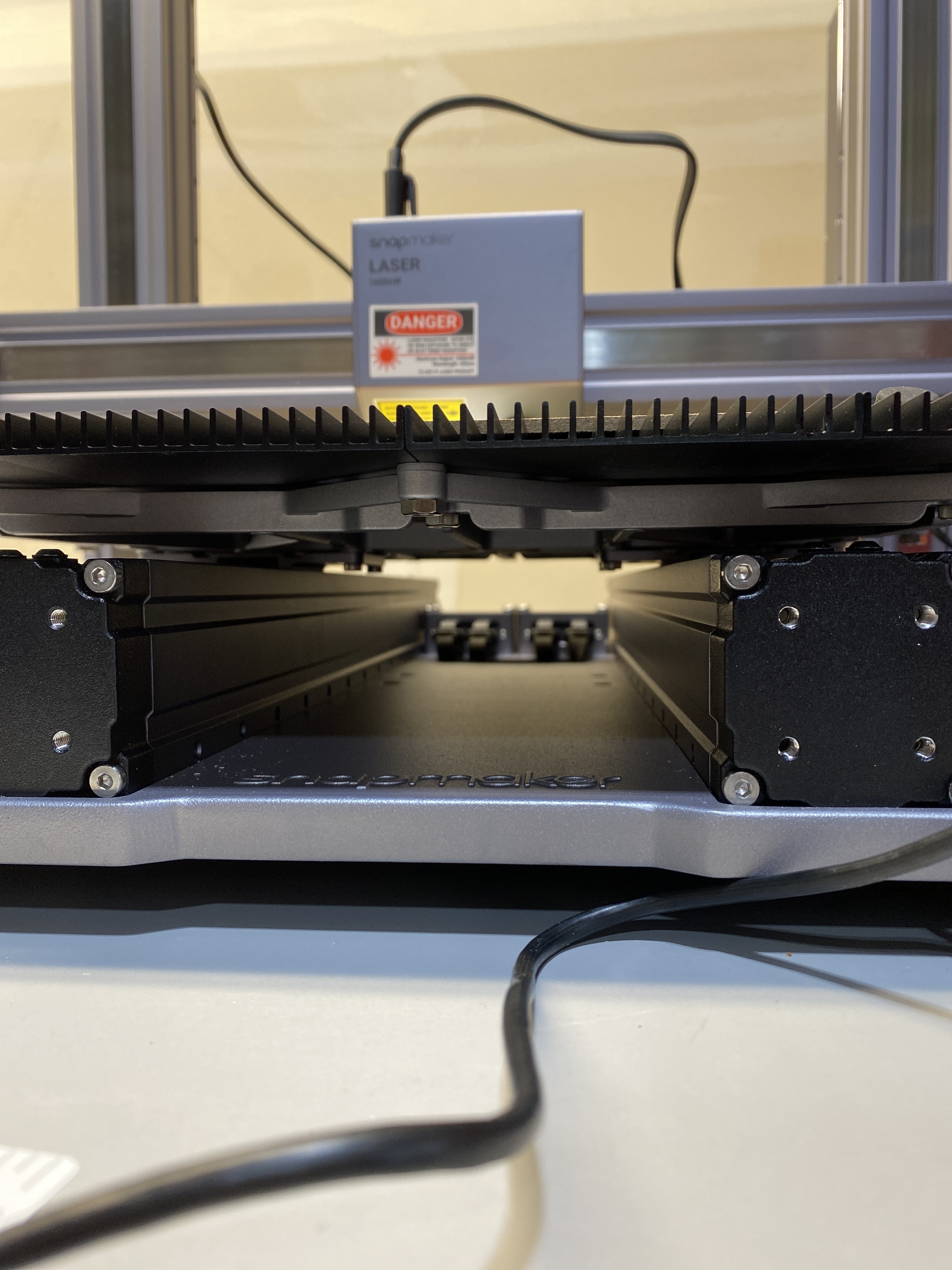

I took the lens hood off and it lasered fine
It checked the lines and failed so I picked the best one
Then It lowered again and smashed into the table

You picked the line on the far right? The right side is getting higher, so that’s indicating it’s too close to the bed. If you picked the far left that would lower the laser closer to the table.
You can always go into the touchscreen settings-\>laser focus (or laser height, can’t remember the name exactly) and raise it 5 or 10mm.

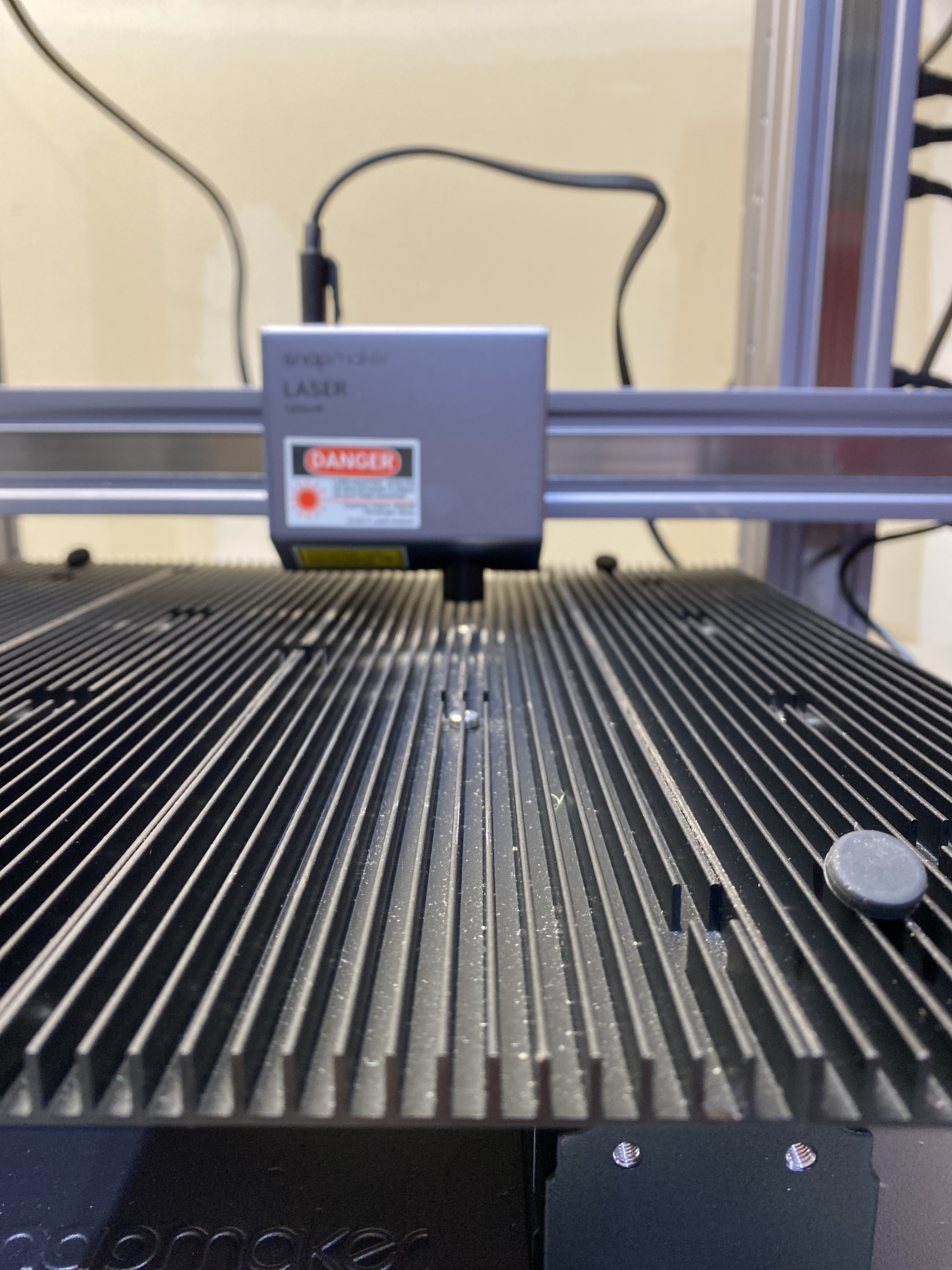

Also, can you post a picture of the underside of the platform?

The far right looked the most crisp to me but honestly they all look the same but that makes sense.
I can’t set the original manually because I have to finish the initial laser set up. But in the set work origin I cannot go up on the z axis at all.
I think there is an issue where the machine thinks it is versus where it actually is.

I think the height is determined when you do the calibration card. I do that without the lens hood also. There very well may be something wrong, I don’t know. But just pretending the lens hood didn’t exist worked for me.
Also the auto calibration is super buggy sometimes, try setting it in the touchscreen settings to manual calibration. It’ll ask you to jog up and down to get the tightest laser spot, then do the +/-5mm pattern from wherever you set. That’s what I do because half the time it chooses the wrong line automatically. Some people here on the forum have told me it’s a firmware bug but I don’t want to downgrade since it’s like the only problem I’m having.
