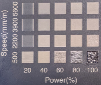

Hi folks,
I had a project where I mixed 1.6W laser, 10W laser and 40W laser, and I had a lot of setbacks and frustrations, which I decided to investigate a bit further. Here the results - spoiler: Inline power implementation for the 10 W is buggy, and trapezoid power implementation is not working or buggy.
First test: 1.6W laser (5000 mm/min, 100%):
 ![grafik](https://us1.discourse-cdn.com/flex022/uploads/snapmaker/original/3X/3/5/35f6c3576763b68554fdfbc45e279e523e6aae48.jpeg)
From left to right:
- Lightburn, 10% oversan, bi-direcional line fill, constant power
- Lightburn, 10% overscan, **uni-directional line fill** , constant power
- Lightburn, 10% oversan, bi-direcional line fill, **inline power**
- Lightburn, 10% overscan, uni-directional line fill, inline power
- **Luban** , 10% overscan, constant power (bi directional, cannot be changed)
- Luban, 10% overscan, inline power (bi directional, cannot be changed)
On constant power, the laser slowed down at the edges, and trapezoid power does not properly compensate. You get deeper burns at the edges.

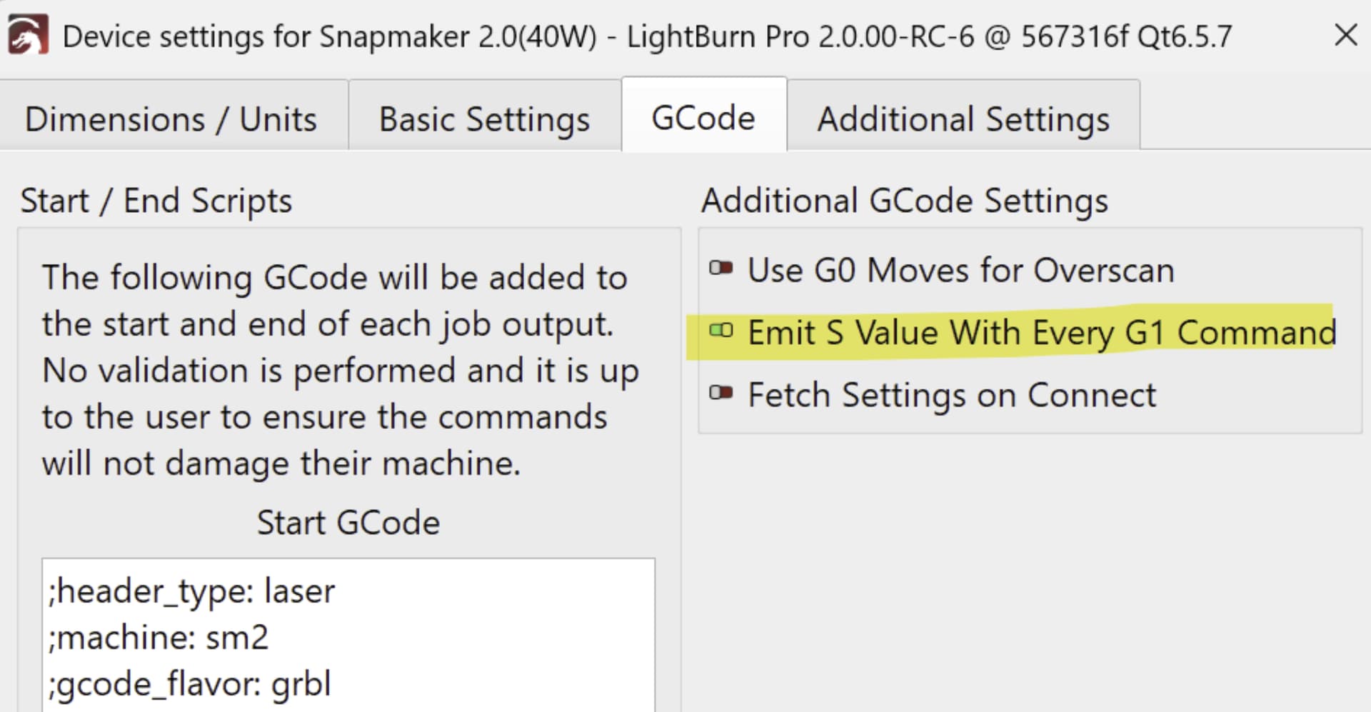

**Author:** ![Aaron.F](https://sea2.discourse-cdn.com/flex022/user_avatar/forum.snapmaker.com/aaron.f/32/29077_2.png) [@Aaron.F](https://forum.snapmaker.com/u/Aaron.F)\
**Post date:** [May 9, 2025, 1:07pm UTC](https://forum.snapmaker.com/t/laser-frustrations-and-bugs/39366/4 "2025-05-09T13:07:01Z")
With newer Snapmaker Firmware you do need to use the GRBL Device Profile.
The “Snapmaker (Marlin)” Device profile was made for older Firmware versions when they were still Marlin-based.
Snapmaker posted newer .LBDEV files [here](https://wiki.snapmaker.com/en/general/manual/use_ray_with_lightburn_guide).
These device profiles have an error:
You must activate ‘Emit S Value with every G1 Command’ in the Device Settings:
 ![image](https://us1.discourse-cdn.com/flex022/uploads/snapmaker/original/3X/2/e/2ee3f3318cc69c6afeda7dcc1fbaeaa031670021.jpeg)
See this post for more info:
> [@Full Lightburn Control Guide](https://forum.snapmaker.com/t/full-lightburn-control-guide/27638/439):
> Hi Everyone! LightBurn chiming in here. It appears that with a recent firmware update, all Snapmaker devices (not the Ray, which already was GRBL) now present as GRBL devices, rather than Marlin. This has the lovely benefit of breaking comms with LightBurn until a new device is created. Any Snapmaker devices currently using the Snapmaker Device Profile or Marlin device profile in LightBurn will no longer work after this firmware update. LightBurn users need to be especially aware that if you w…

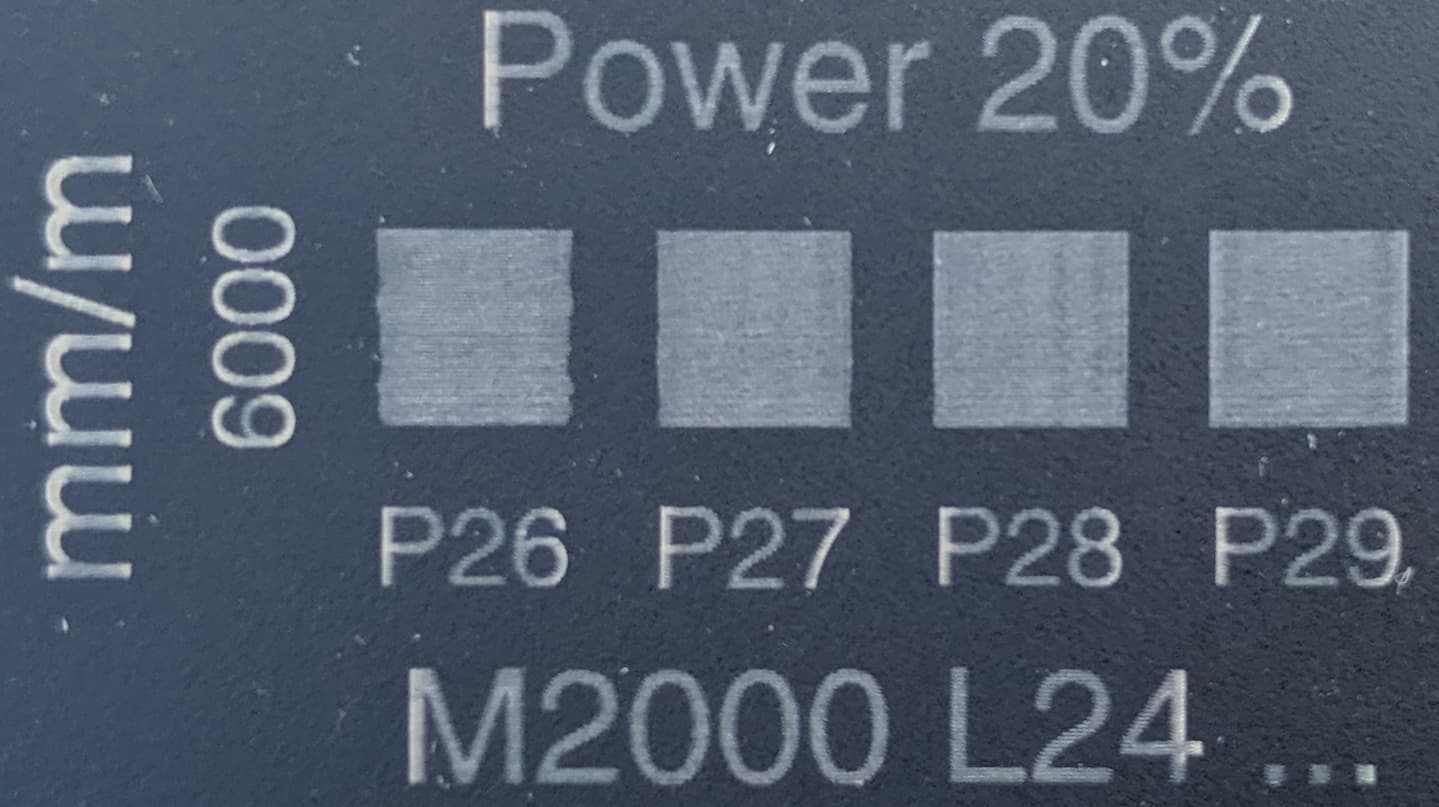

**Post date:** [May 9, 2025, 1:14pm UTC](https://forum.snapmaker.com/t/laser-frustrations-and-bugs/39366/5 "2025-05-09T13:14:56Z")
I got some interesting results for you. 🙃 I was going to do a test of using `G0` for overscan, and decided to rerun the test with `M4` as well just to see what the hell. For reference; I’m using GRBL-M3 in Lightburn for this test. It seems doing a find/replace of `M3` to `M4` using this profile actually works fine. However, the regular GRBL (no M3) with variable `M4` mode does not. 🤔
Anyway the results! I purposefully ran the power a little light so variations in power would show up better. 0.5 fill to identify each line, along with a line mode for an outside trace. This is with a 10W.
Bottom left; Regular M3, no G0 for overscan.
Bottom Right; Regular M3, G0 for overscan.
Top Left; M4 swap, no G0 overscan.
Top Right; M4 swap, G0 for overscan.
 ![PXL_20250509_130111634](https://us1.discourse-cdn.com/flex022/uploads/snapmaker/original/3X/c/b/cbbd832e88fc03affdcb10f5cdbf39019cecd5f6.jpeg)
That top left with `M4` looks pretty clean and even. Bottom left was pretty much as expected for `M3`, corners a bit darker, but otherwise good. The `G0` for overscan in the bottom right was a bit of a shock… _why_ are the edges darker. However, both `M4` results look decent, and the very tips of the corners seem to fade slightly, so the power is pulling down a smidge as it should.
**Post date:** [May 9, 2025, 2:01pm UTC](https://forum.snapmaker.com/t/laser-frustrations-and-bugs/39366/6 "2025-05-09T14:01:54Z")
I’m surprised that the M3 squares look differently. I would have expected the left bottom to look the same like the bottom right, as the laser should accelerate and deccelerate at the edges in both cases.
Would you mind to share the GCode? Would love to understand this…

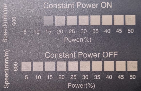

**Post date:** [May 15, 2025, 8:58pm UTC](https://forum.snapmaker.com/t/laser-frustrations-and-bugs/39366/11 "2025-05-15T20:58:06Z")
MAN!
This device is driving me _crazy_!!!
Now that I finally understood what others grasped much faster than me, i.e. that M3 is constant power, M4 is adaptive power, and that inline has no immediate connection to it, I thought I’m ready for repeating my experiments with the 2W IR laser on black acrylic and PCB etching. So I wanted to see if I could get true greyscale, repeating [this experiment](https://forum.snapmaker.com/t/laser-inline-power-processing-slow/38563/3). Results were confusing, so I went back to systematic tests. Ran a test pattern - was rather surprised! See yourself:
Top row is constant power mode ON, bottom row has it OFF (Was running out of space, so had to squeeze the top row in)
 ![grafik](https://us1.discourse-cdn.com/flex022/uploads/snapmaker/original/3X/f/5/f54d934c4ed4c34f9d294acce25f2ce96d1366d3.jpeg)
This is test patterns done with Luban, **not** Lightburn. Looked into the GCode, and it is perfectly sane, the power settings should do 2,4,6,…,20% in both cases. But with constant power OFF, there’s obviously no proper power regulation.
I remembered [this post](https://forum.snapmaker.com/t/laser-inline-power-processing-slow/38563/13) by @Skreelink where he had it that trapezoid power seemed to be inverted - this I could not reproduce. Any square I created, be it with Luban or Lightburn, was behaving well.
Still, something is very odd with the adative power control of the 2W… And I was so happy that with the blue lasers it finally was all understood and working _sigh_
I’m back to really frustrated…

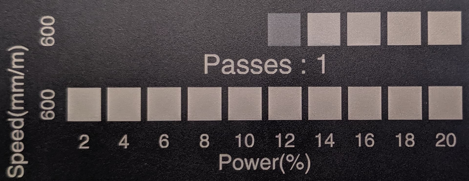

**Post date:** [May 15, 2025, 9:33pm UTC](https://forum.snapmaker.com/t/laser-frustrations-and-bugs/39366/12 "2025-05-15T21:33:52Z")
The 2W is a completely different beast, that’s what I had done the trapezoid power test with (that you linked) and it seemed reverse. i.e. it burned when `M4` adaptive was on, yet `M3` didn’t scratch it. There’s definitely something wrong with trapezoidal with the 2W IR, however, it works correct with the 10W blue.
However, at the same time, even if it worked right, you wouldn’t want to reduce the power of the 2W very much. It’s already fairly low and doesn’t have much wiggle room, and might cause fading in the corners. So a good rule of thumb I’m finding is; `M4` for Blue, `M3` for IR.

My current interpretation is, that the algorithm that calculates the power ramps has this lower limit of 16%. However, my 2W module performs very well down to 11%:
 ![grafik](https://us1.discourse-cdn.com/flex022/uploads/snapmaker/original/3X/e/9/e98f5e78b0c0d855ca46eade1447fdcec620ed44.jpeg)
So power adjustment with speed is not accurate at the lower end - which in a test grid done with constant power OFF shows as white edges for the 20% squares - which I guess is the same as Skreelinks seemingly inverted power ramp:
 ![grafik](https://us1.discourse-cdn.com/flex022/uploads/snapmaker/original/3X/f/a/fa79d85252d576cee991838426e9bb026c7bf56d.jpeg)
This is an issue with constant power off, where the algorithm seems to introduce the lower limit. With constant power on, the laser just takes the power thrown at it, no limit:
 ![grafik](https://us1.discourse-cdn.com/flex022/uploads/snapmaker/original/3X/6/6/668bfef650021e1f14c0c00b04362308a20e1302.jpeg)
So, I explained my theory to support and suggested to change the lower limit of the M4 algorithm. Let’s see what they come up with.

Support got back on me for the 2W problem - with a very helpful answer! You can adjust the lower threshold that is applied for the 2W by the command
> M2000 L24 Pxx
where XX is between 0-255. It defaults to P40, i.e. 15.7%.
As soon as I have time the next days I’ll try this out with the value that seems to be better for my 2W module, i.e. P26 = ~10%, perhaps I’ll compare it to P28 = ~11%.
Will keep you posted! But really glad that Snapmaker implemented it adjustable!!!

Aaaand (drumroll): Success! The command works as suggested by support. So for my module M2000 L24 P28 is the sweet spot. See picture - the text was done with default M2000 L24 P40, the squares as indicated. You can see that the squares are good, and the text is not.
 ![grafik](https://us1.discourse-cdn.com/flex022/uploads/snapmaker/original/3X/6/7/67d5ea2d104eab659f853f2ce026230ef524a9e2.jpeg)

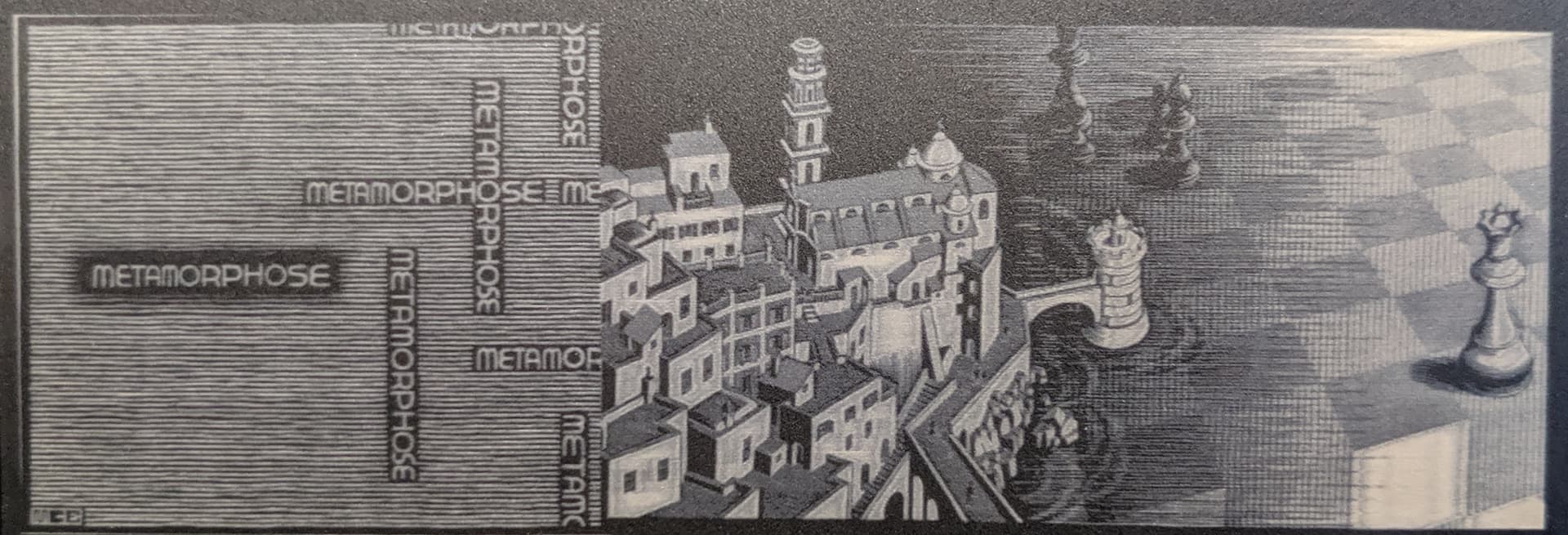

Ah, look at that! Not perfect, but getting there… This is 2W IR laser true greyscale with Lightburn:
 ![grafik](https://us1.discourse-cdn.com/flex022/uploads/snapmaker/original/3X/f/8/f8a3ff8ed9d91a7f0d8b9e01c9fb52844d2dfcb9.jpeg)
True greyscale is _so_ much better than dithering! Here’s the same image done with dithering (you may need to go to 100% view to really appreciate the difference):
 ![grafik](https://us1.discourse-cdn.com/flex022/uploads/snapmaker/original/3X/b/2/b2a7713c6e21b0e83b9a337117976ef554851f71.jpeg)
Here’s the source image:
 ![grafik](https://us1.discourse-cdn.com/flex022/uploads/snapmaker/original/3X/5/4/549757b0339f8b8d5747b4bcd7aa4efe4396a79f.jpeg)
The “why” you can read here: [Laser Inline Power processing slow?](https://forum.snapmaker.com/t/laser-inline-power-processing-slow/38563)
And yes, laser processing _is_ slow. The image shown here was done with base speed 6000 mm/min, which is basically never achieved. I’ll do a run tomorrow with 600 mm/min, which I expect to yield better results - the algorithm for adaptive power struggles in places as you can see. I assume going slower will iron that out, and in effect it will make no difference as to how long the image will take to burn.
