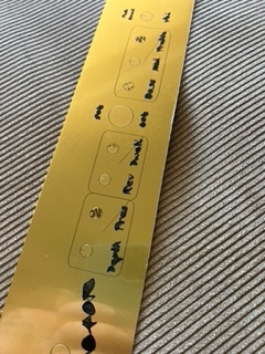

Hi Folks, I’ve been using my A350 with it’s 10w laser for a while now , I etch “faceplates/control panels” for the guitar amplifiers I build … everything has been fine up until now
The machine did an autoupdate, and now the etching is not working properly , here is an example of before
![IMG_6550](https://us1.discourse-cdn.com/flex022/uploads/snapmaker/original/3X/9/b/9be0f96ba938087ed7e07c10c3618468d6b7f5ed.jpeg)
now it’s filling in all the spaces and adding centre lines on the square shapes …
settings are the same as before , what am I missing , I’ve ruined a few blanks now … It’s got me stumped
any help or ideas of what’s going on

The machine is currently running 4.9.1 updates , looking around other posts here there seems to be a problem … I’m new to this so don’t know how to fix it

Did you update the firmware?
### Author: ![xchrisd](https://sea2.discourse-cdn.com/flex022/user_avatar/forum.snapmaker.com/xchrisd/32/1503_2.png) [@xchrisd](https://forum.snapmaker.com/u/xchrisd)
#### Post date: [October 1, 2023, 2:57pm UTC](https://forum.snapmaker.com/t/laser-etching-font-issues-whats-happened/33086/6 "2023-10-01T14:57:31Z")
As nweolu wrote, there was a firmware update where the laser control gots inverted in some cases.
Be sure to update luban AND your machine or stay with older firmware AND below Luban 4.9 (4.8.x).
### Author: ![Amwatts](https://avatars.discourse-cdn.com/v4/letter/a/b2d939/32.png) [@Amwatts](https://forum.snapmaker.com/u/Amwatts)
#### Post date: [October 2, 2023, 3:15am UTC](https://forum.snapmaker.com/t/laser-etching-font-issues-whats-happened/33086/7 "2023-10-02T03:15:59Z")
Firmware updated this morning , I thought it was done but it wasn’t, now it’s doing what it’s supposed to do,
Thanks so much for your help
