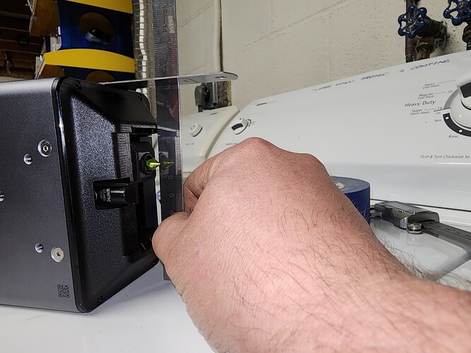

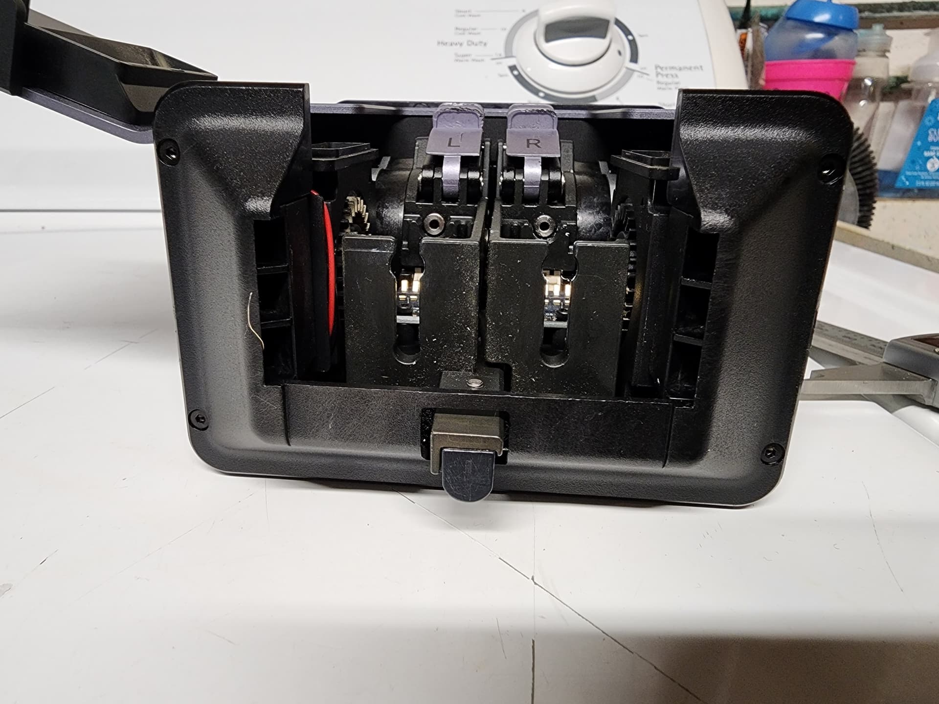

**Post date:** [July 29, 2023, 9:30am UTC](https://forum.snapmaker.com/t/klicky-probe-bed-leveling-on-anything-stealth-mod-for-single-extruder/32229/12 "2023-07-29T09:30:15Z")
Looking for dual extruder detailed pictures and dimensions to adopt the klicky probe for it.
**Post date:** [August 11, 2023, 7:40pm UTC](https://forum.snapmaker.com/t/klicky-probe-bed-leveling-on-anything-stealth-mod-for-single-extruder/32229/13 "2023-08-11T19:40:10Z")
Very nice. I can probably get you some pics and dims since i just removed mine.
**Post date:** [August 11, 2023, 8:07pm UTC](https://forum.snapmaker.com/t/klicky-probe-bed-leveling-on-anything-stealth-mod-for-single-extruder/32229/14 "2023-08-11T20:07:29Z")
Would be nice 🙂
If you have an opportunity to scan the back side of it with a ruler and get some info on how current probe attached to the housing would be nice.
It seems to be tight in there but duable.
Also distance from housing to the nozzle tip without cover…
**Post date:** [August 12, 2023, 12:12am UTC](https://forum.snapmaker.com/t/klicky-probe-bed-leveling-on-anything-stealth-mod-for-single-extruder/32229/15 "2023-08-12T00:12:06Z")
I have here a quick little video of some of the characteristics to consider and a series of photos to give some basic initial dimensions
[](https://www.youtube.com/watch?v=q3VoiuZ9ksc)
(Video is processing may take a bit)…
If you want something specific, i will be glad to work with you to get what you want
The nozzle tip is kind of a complicated topic as youll see from the video, but one of the photos does show this
I suspect the existing sensor mount location would be an ideal place to try it at but id be interested to see what you come up with.
