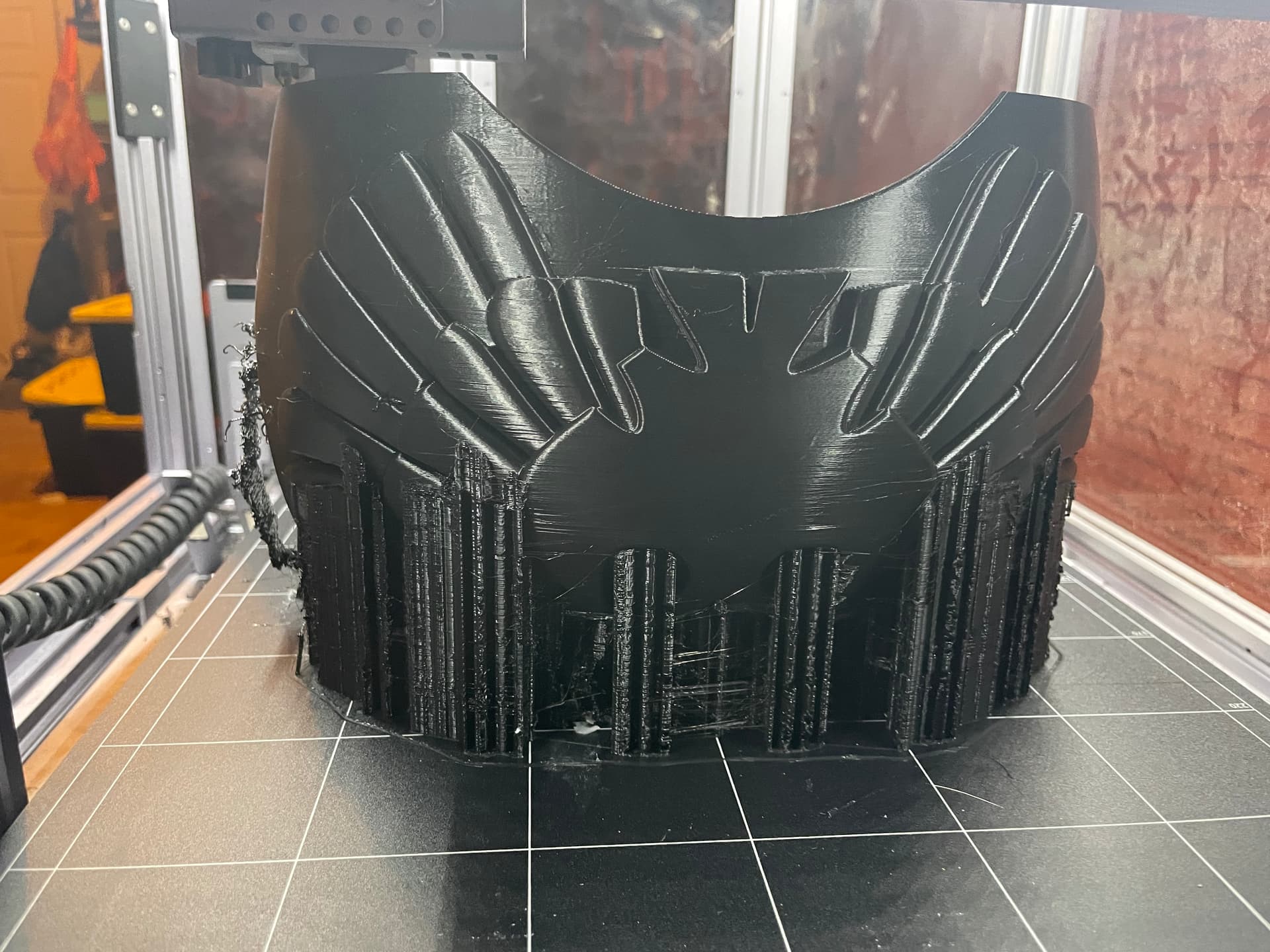

**Author:** ![Mads0100](https://avatars.discourse-cdn.com/v4/letter/m/4af34b/32.png) [@Mads0100](https://forum.snapmaker.com/u/Mads0100)\
**Post date:** [September 9, 2021, 10:20pm UTC](https://forum.snapmaker.com/t/is-a-consistent-first-layer-across-whole-of-a350-build-plate-actually-possible/20740/18 "2021-09-09T22:20:28Z")
The firmware update definitely makes a difference. I’m doing full size prints registry now.
