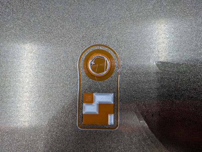

I got a reply from Support and they said that from the logs I sent, the default XYZ offset value of the dual extrusion module was changed.
I need to connect the machine to something called pronterface and type in a command.
Going to try and figure this out during my lunch break. I’ll update the thread with what happens.

The pictures do not show anything out of the norm - your nozzles are physically aligned well enough IMHO.
A Facory reste on Artisan I never did (I’m a 2.0 user). On the 2.0 there are two options:
[https://wiki.snapmaker.com/en/Snapmaker\_2/troubleshooting/reset](https://wiki.snapmaker.com/en/Snapmaker_2/troubleshooting/reset)
The touchscreen option may or may not be the same on Artisan. The second option M502/M500 should work on any Marlin device, incl. Artisan. It will only reset the Marlin part, not the touchscreen, but my assumption would be that it is exactly the Marlin part that has the wrong values stored. Unless you have something special configured on your printer that requires saving before, I’d do the M502/M500 steps. And after that a reboot to be safe.

After the Factory Reset
 ![PXL_20250428_165120430](https://us1.discourse-cdn.com/flex022/uploads/snapmaker/original/3X/b/8/b891d4c2d8de282db446912e3324bb8df7fc425c.jpeg)
Exactly the same. Going to see if I can get Pronterface working before my lunch break is over.
