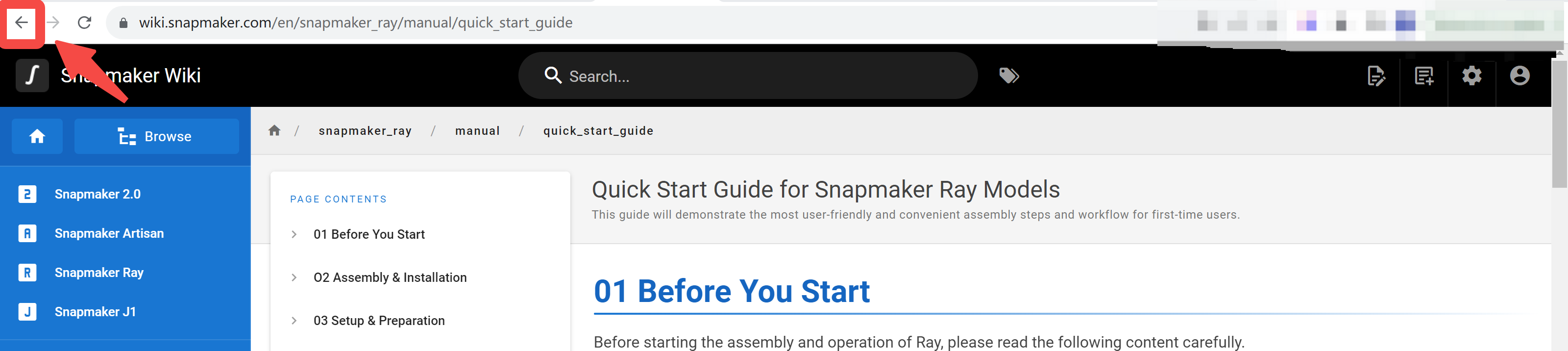

- Each Wiki article generally covers a specific topic. Therefore, while reading, you may need to click on article links multiple times to expand further and use the back button to return to the initial content.
- To go back to the previous page, click the arrow at the top left corner of your browser.
 ![](https://us1.discourse-cdn.com/flex022/uploads/snapmaker/original/3X/8/2/825a0544737523fa5253edc3f46fde2e025608a5.png)
- The directory navigation at the top of the Wiki page indicates the current article’s path. Clicking on it may not take you back to the previous page you were reading. This is because our Wiki articles are independent and can be referenced in manuals for different machines. They are not necessarily located on specific paths within a particular machine’s manual.
