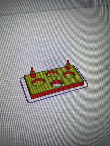

The more interesting part is this:
I found a G code on the forum: Heat Tower. When I run it, the width of the heat tower is exactly 10 mm. Could you please create a G code for a 50x50x50 cube using the standard settings you always use?
 ![IMG_3129](https://us1.discourse-cdn.com/flex022/uploads/snapmaker/original/3X/d/9/d99f898be44ba0d8e4a82c5f756a40b2ba9b3030.jpeg)
**Author:** ![Ahmet](https://avatars.discourse-cdn.com/v4/letter/a/ac91a4/32.png) [@Ahmet](https://forum.snapmaker.com/u/Ahmet)\
**Post date:** [July 12, 2025, 7:51pm UTC](https://forum.snapmaker.com/t/i-print-0-2-mm-smaller-than-the-solid-measurement/39655/8 "2025-07-12T19:51:39Z")
I’d like to try getting a G code from someone who has printed without any problems. Maybe I can figure out the problem by comparing it this way.
During my experiments, the exterior walls, shown in red on the Luban screen, consistently appear 0.2 mm too short. I suspect there may be a problem converting to STL format with SolidWorks. So, I’m testing again in AMF format.
Standard PLA settings are 215°C. The default print setting is normal.
**Post date:** [July 13, 2025, 8:28am UTC](https://forum.snapmaker.com/t/i-print-0-2-mm-smaller-than-the-solid-measurement/39655/9 "2025-07-13T08:28:37Z")
I tried different formats, but the result is the same.
I downloaded the Snapmaker Orca beta and tried it. The result is the same. I’d like to ask someone who performs precise measurements with PLA in Luban to create a G-code for a small part.

**Post date:** [July 14, 2025, 8:54pm UTC](https://forum.snapmaker.com/t/i-print-0-2-mm-smaller-than-the-solid-measurement/39655/12 "2025-07-14T20:54:25Z")
OK, had a bit of unexpected time at my hands and sliced and printed your model - used Cura, not Luban, hope that is still OK.
Setup:
- SM2 A350 (Kickstarter version)
- Dual extruder
- 0.4mm brass nozzle
- White PLA ([Formfutura rPLA](https://www.3djake.de/formfutura/reformtm-rpla-white))
- 200°C nozzle
- 60°C bed
- 0.2 mm layer height
- 60 mm/s speed
- 4 bottom/top layers
- 4 wall lines
- 25% grid infill
Here are my dimensions (measured with a good ol’ mechanical caliper with nonius, 0.05mm scale resolution):
- width: 49.95 mm
- breadth: 30.00 mm
- height (base) 5.05 mm
- pin diameter (thick part): 4.95 mm - both
- pin diameter (thin part): 2.00 mm - both
- pin height (total): 14.95 - 15.00 mm (left/right)
- Through hole: 9.85 mm - 9.90mm (x/y direction)
- Half-through hole: 10.00 mm
- Depth of half-through parts: 3.05 mm (all three the same)
- Hex breadth across: 9.90-10.00 mm, dependent on direction measured
Honestly surprised and pleased how precise this came out. GCode attached. Should also work with single extruder.
The round holes are the most problematic, I have a bit of inconsistent extrusion there, perhaps my retraction settings need tweaking.
[S2ADE\_TestParcası.gcode](https://forum.snapmaker.com/uploads/short-url/b78wkgSEOkcY0RnfF7VNKB9F8eZ.gcode) (837.2 KB)
