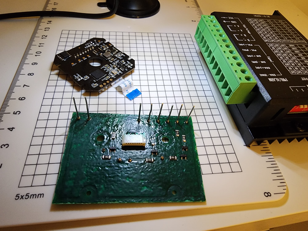

The other board (with the microcontroller on it) inside the linear module doesn’t seem to interact with the motor in any way and is undamaged, so I kept it. Here’s everything ready to be connected.

**Author:** ![cyb0124](https://sea2.discourse-cdn.com/flex022/user_avatar/forum.snapmaker.com/cyb0124/32/25275_2.png) [@cyb0124](https://forum.snapmaker.com/u/cyb0124)\
**Post date:** [January 8, 2024, 1:25am UTC](https://forum.snapmaker.com/t/i-have-successfully-repaired-my-dead-linear-module-fried-driver-chip/34459/6 "2024-01-08T01:25:25Z")
Here’s everything put together:
 ![5](https://us1.discourse-cdn.com/flex022/uploads/snapmaker/original/3X/0/9/09fcfb79000625de9f1616c8bad6e88d26f42766.jpeg)
**Post date:** [January 14, 2024, 11:49pm UTC](https://forum.snapmaker.com/t/i-have-successfully-repaired-my-dead-linear-module-fried-driver-chip/34459/10 "2024-01-14T23:49:01Z")
I’m not sure about the chip because I replaced the whole board rather than the chip. There might be other components damaged on the board too other than just that chip. Also the new board has better cooling (the entire back of that board is heat sink fins) while the original board doesn’t have a heat sink at all, so I worry if I just replace the chip the board may fail again due to heat reasons.
