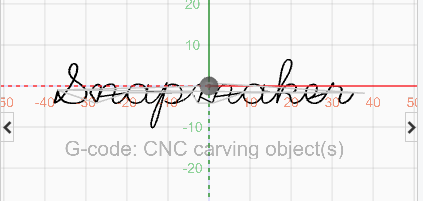

I installed and tried a few TTF single line fonts in SnapmakerJS (most single line fonts are other file types) to skip the Inkscape step. The characters are made closed loop again resulting in connection lines:
afbeelding
Can Snapmaker or someone else select or create a suitable font?
