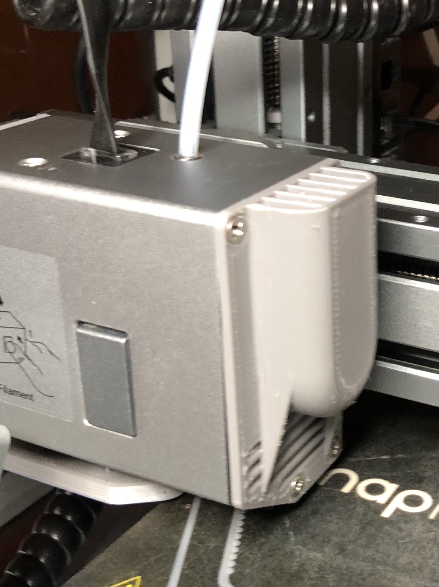

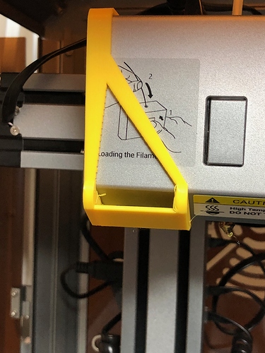

Hi @X_Pilot
I printed your Fan Diverter. Great design, fits on the print head very well and stops the fan blowing across the nozzle. I have yet to buy some ABS but my
 ![IMG_1402](https://us1.discourse-cdn.com/flex022/uploads/snapmaker/original/2X/7/795e974a797dd7fe1acd20b1be907e5c51a5657e.jpg) ![IMG_1401](https://us1.discourse-cdn.com/flex022/uploads/snapmaker/original/2X/c/cdacd4272bdcd76185ce7eb58b6915b830a97c59.jpg)SnapMaker is ready to go!
**Author:** ![X\_Pilot](https://sea2.discourse-cdn.com/flex022/user_avatar/forum.snapmaker.com/x_pilot/32/1497_2.png) [@X\_Pilot](https://forum.snapmaker.com/u/X_Pilot)\
**Post date:** [August 9, 2018, 4:40am UTC](https://forum.snapmaker.com/t/how-do-i-print-abs-properly/2504/10 "2018-08-09T04:40:19Z")
I hope it works as well for you as it did for me 😃 You will need some hairspray or something to keep the ABS stuck to the build plate, but apart from that it made it much easier for me to print ABS 😃
Let me know how it goes!
I was going to make another iteration that directs the air towards the nozzle. That should technically help PLA and overhangs, but I haven’t gotten around to trying it yet.
Also, what filament is that? It looks really nice!
-Greg

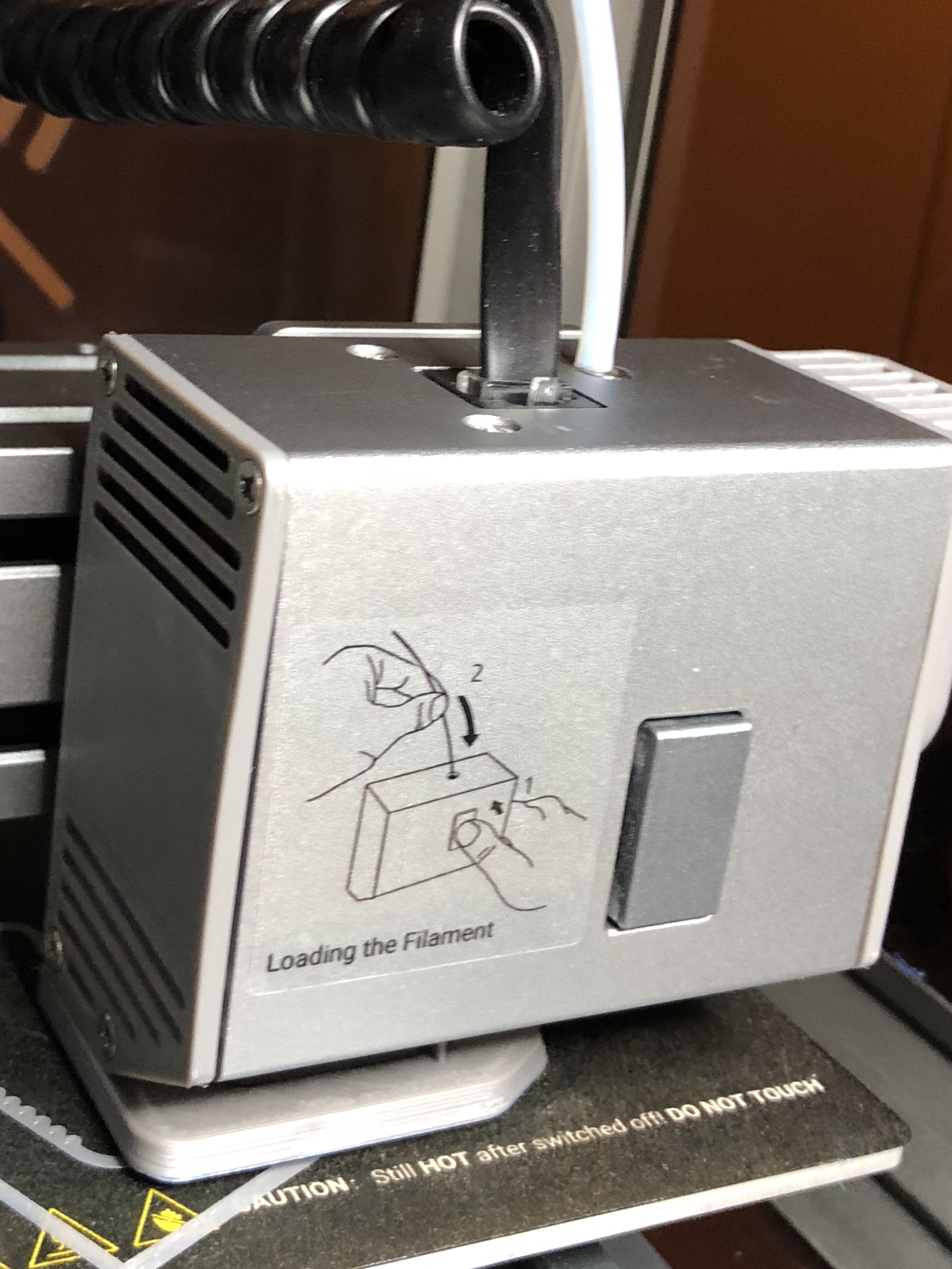

**Author:** ![rick](https://sea2.discourse-cdn.com/flex022/user_avatar/forum.snapmaker.com/rick/32/1923_2.png) [@rick](https://forum.snapmaker.com/u/rick)\
**Post date:** [August 17, 2018, 6:48am UTC](https://forum.snapmaker.com/t/how-do-i-print-abs-properly/2504/15 "2018-08-17T06:48:17Z")
@Tone, I’ve mounted the version 2 shroud. On home it’s hitting the build plate. You might want to check the dimensions - it could be the way I’ve printed and/or mounted it. It’s interfering with the plate by only a mm or so. I’m investigating and I’ll let you know if I find the cause.

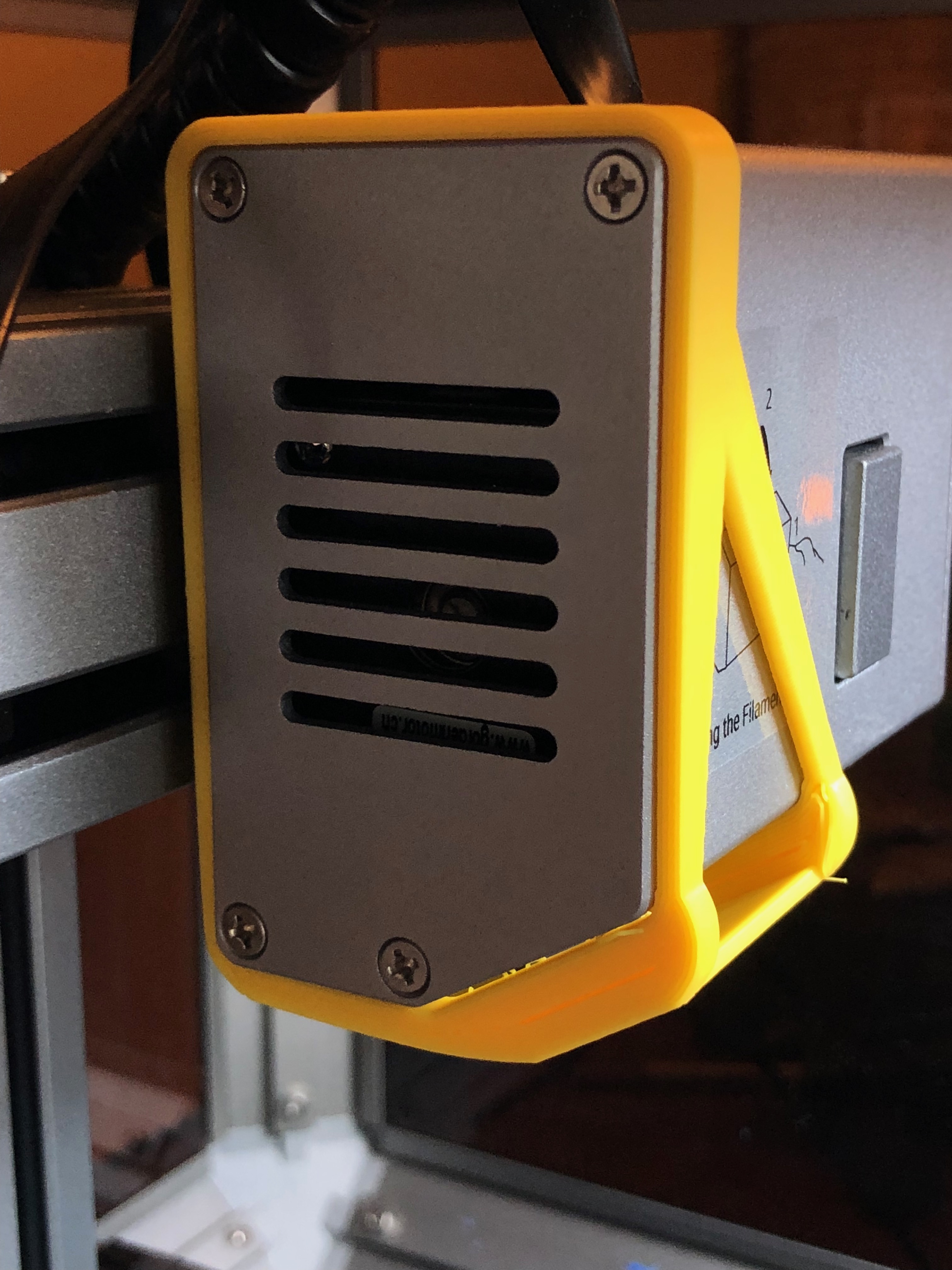

**Post date:** [August 17, 2018, 6:54am UTC](https://forum.snapmaker.com/t/how-do-i-print-abs-properly/2504/16 "2018-08-17T06:54:11Z")
@Tone. Here’s a few pictures of the complete installation.
