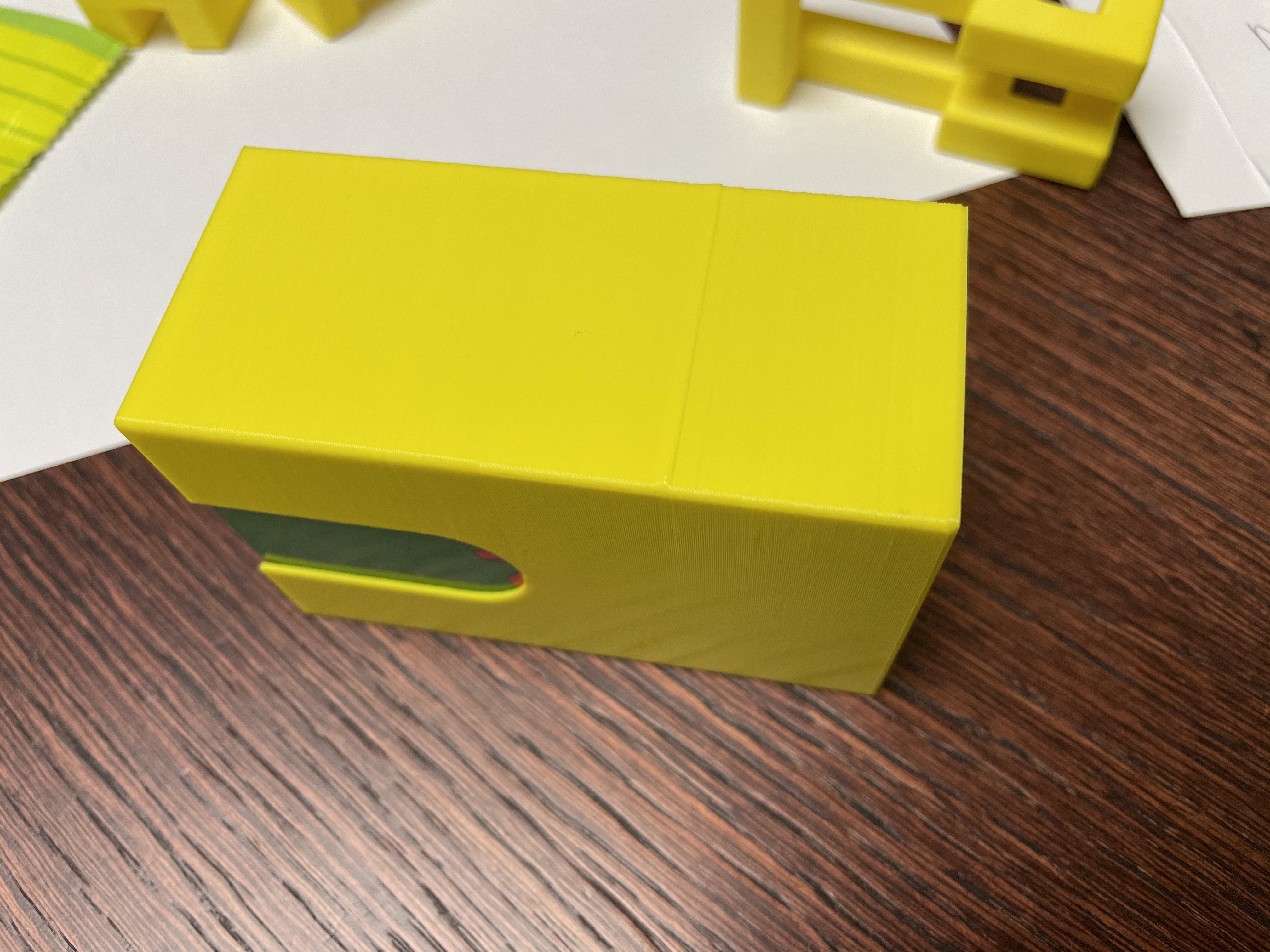

Horizontal Waves
Ich sometimes see some sort of a line in an outside wall. As if the printhead didn’t quite move to the right position. Anybody know if that is normal?
That looks like you could stand to try adjusting linear advance and estep calibration as well.
Teaching Tech 3D Printer Calibration (teachingtechyt.github.io)
sometimes internal geometry will cause lines like that, but i bet you will see a great improvement from both of those.
the line thickness will be closer to what is intended and will be more consistent
