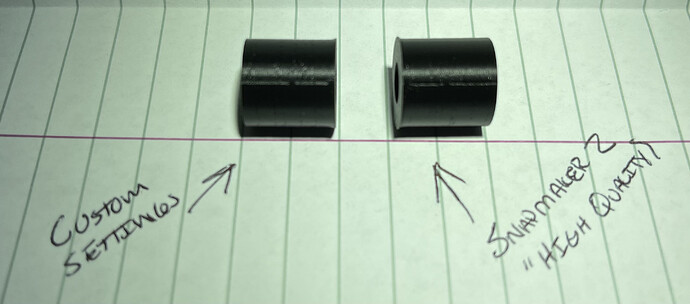

I am attempting to print round spacers for a project using PLA from Snapmaker and Hatchbox. They are ~12mm round, 12mm tall, so all the movement is pretty well focused and contained to a small area of the bed.
The prints are completing successfully, though I am running into a wall, having ran through nearly 12x 1h prints and they each have the same two issues.

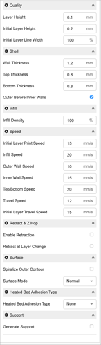

1. Horizontally, decreasing layer height results in line visibility decreasing at the expense of increased time to complete, though throughout the print there are either several empty “dots” (about the size of a dead pixel) or extended horizontal lines about 2-3mm – both appear empty about 1-2 layers deep.
2. There is a divided vertical line split only by a small filled gap on the back of every print – almost as if the print is being marked at the 50% mark. Watching the print from the back, the position of the line is exactly where the extruder stops before it continues the print. I don’t understand why between the end of the first line and the next, 4-6 layers fill without any issues.
**What I’ve Done**
1. Calibrated the bed. I first heated the nozzle to 205 and the bed to 80, quickly tightened down the screws for the frame, and then brought the nozzle down to a 0.05 gap. Originally, I tried zeroing fully, however, the first print resulted in dragging on one side of the print be, so I brought it up a bit.
2. Checked the consistency for the PLA from Snapmaker and Hatchbox using a micrometer – all in range for their tolerances. The Snapmaker filament is Black, the Hatchbox is glow in the dark.
3. Tested Snapmaker recommendations for Fast Print, Normal, and High Quality before moving on to my own settings to further reduce layer size and speeds, reduce print temperature from 200-205 to 190-195 (see attachment for the settings of the last run).
4. Tried printing outer walls before inner walls – this doesn’t seem to make a difference. Increasing or decreasing the wall or top/bottom thickness doesn’t seem to help either.
5. Checked for wobble in the bed – it’s solid and there’s no visible movement during the print, and it would take a good bit of force to make it wobble by hand.
6. The printer unit is tightened down well; no movement during prints or when pushing on it.
Any ideas on what I am doing wrong, or where I can improve to remove the vertical lines and further reduce or remove the horizontal gaps?

Are you having the problems with both hatchbox and SM filament?
Did you calibrate extrusion?

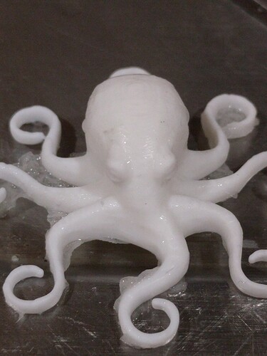

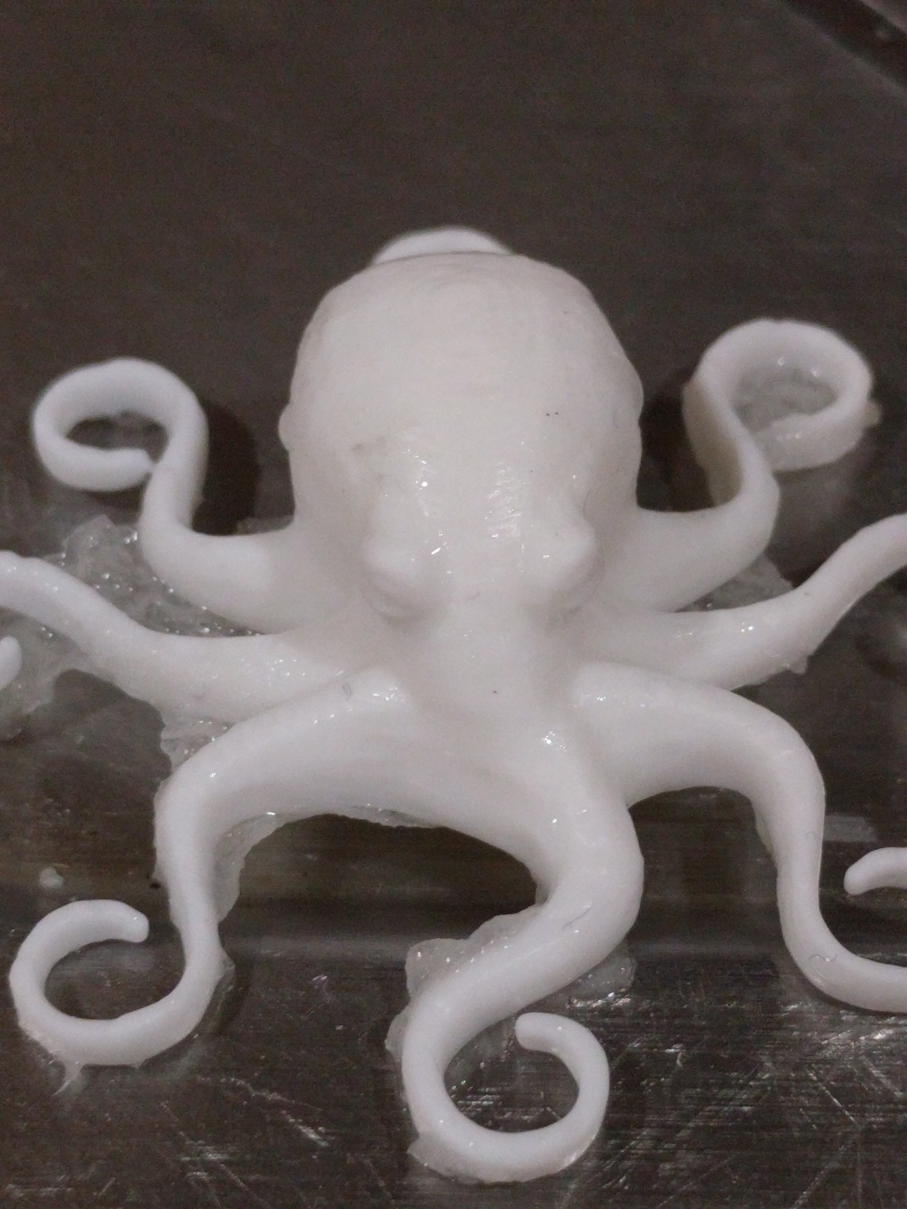

Holes that occur at the same location as you add layers could be related to retraction. For this print, stringing shouldn’t be a problem. I’d try turning off everything in the “Retraction and Z Hop” section.
The vertical seam is caused by the slicer starting each new layer at the same location. It’s easy to see when it’s printing infill. It’ll print the infill, then go to the same spot on the wall to start the wall print. As far as I know, Luban doesn’t have any settings to address this. I think Cura and others do, but I haven’t played with them yet.
Is that some over extrusion on the first layer, or did you deliberately give it that flange? At first I thought it was over extrusion, but it’s usually a single layer, not several layers with a radius. If you intended for the diameter to be consistent through the whole cylinder, there are some things you can do to adjust that first layer.

@sdj544
Yes, both SM and HB, as well as a few other brands. I have not calibrated, yet. I avoided this step first as my projects are small in nature–I don’t intend on printing anything large. Most prints are spacers or work holding for my CNC machine (and as long as it’s sturdy and holds, I don’t mind what those look like).
Do you believe calibration would fix these specific issues? The middle of the project prints round, as it should, which makes me believe extrusion is doing good, but I am very open to testing calibration so I don’t waste PLA.

The vertical lines are only on the back of the project, exactly where the extruder pauses on the z axis. With the middle of the project printing correctly (round, no vertical lines), I don’t believe there would be an issue with alignment or mounting, though I did re-mount and ensure it’s level and does not move.

Retract is off for these projects to keep the nozzle on the project as much as possible. Given the travel distance, even if strings were visible, quick sanding would break them quickly, so this ended up being the first thing I turned off 🙂
On the flange, there’s not one present on the 3D model. I originally had the bed temp too high for PLA–at least, based on what I’ve read. On one, I also had the z height down 0.05 too far, which ended up causing some flattening as well as dragging on the bed.
I am now testing the project in Cura. It seems the random z is exactly what I need looking at the 50% mark for the current spacer. Right now, there’s no vertical line, though we shall see once the project is complete.
The goal here would be to scale this up so I am not having to print one at a time. I’d like to run 10-20x, though the time per is about 50 minutes. The first attempt to print 8 also resulted in major warping and only 1 of 8 were usable (though I will be cutting the warped section so I can reuse for smaller spacers).
If Cura is the fix, is there a good way to optimize both time to print (while keeping solid structure) and preventing warping?

Yea, in my opinion, if the seam is leaving a gap that’s a sign of underextrusion. It should at least be flush or proud so that it can be sanded off.
Bare minimum do the e-steps calibration and flow calibration from moose juice’s link above.
If things are going well, I’d recommend doing the lin advance test too, my machine was way off what it should be, and that can result in weird over / underextrusion as well.

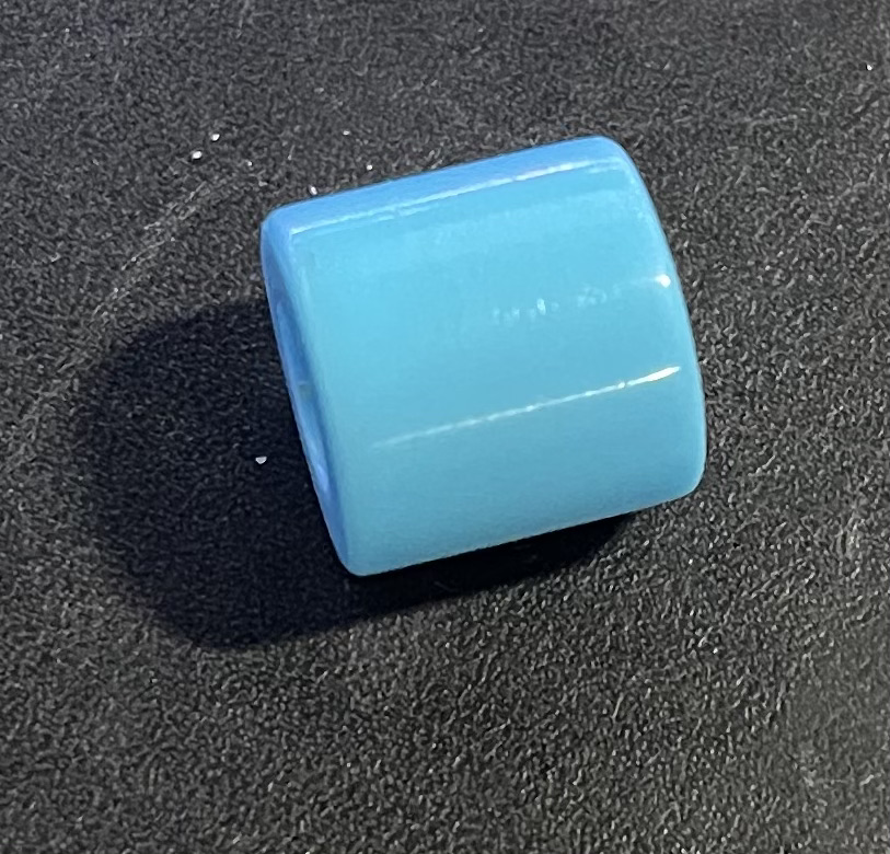

Cura definitely solved the vertical line issues; they are non-existent now. It seems in solving one issue, another popped up though.
Close to the center of the print there appears to be a fracture or shift of z height, which is introducing a band. As with the vertical line issue, this band only appears on half of the print and that half appears to be on the back (which is where the vertical line appeared prior to using Cura).
That said, I did opt to use ABS on this print as UPS dropped it off right before I started the other. Nozzle temps were solid around 230, with the bed heated to 90 (which appears to be peak for my unit; I can’t get it to 100 in any reasonable amount of time).
I’ll swap back to PLA and test again soon, though ABS was much easier to sand. The image below is one with the band, though the sanding time for this was about 2-3 minutes (put it on a small lathe with a pen blank rod).

So I have to admit, I was wrong to avoid calibrating the extruder. After calibration, the print was as close to near perfect as I could expect. No lines vertically, the horizontal lines were very difficult to pick up w/o touching and running my nail over the layers, and no fracture/uneven layer.
I was able to pull the print, sand with 1000-2000 grit, and then polish with Novus on the buffing wheel. All in all, the final stage took about 6-7m, though the print took about 45m.
Now I need to find a way to cut the time to print down while keeping the print structurally dense, if that is possible 🙂
All in all, this is NovaMaker Sky Blue ABS, 1.75mm and the bed was painstakingly heated to 90, with the nozzle at 225 throughout the entire project.
The base was a bit uneven prior to sanding, though not warped. I am going to try lowering the temp on the bed to 75-80 as hitting 90 is both time-consuming and I feel the bed is not well-equipped to get to and maintain 90 consistently. The option to set 100 is there, though Luban will kick it back to 80 first chance it gets.
The only issue I ran into was with the calibration. The first run to extrude worked perfectly and I was able to set the new value (mine was off by 12mm), though attempting to run the extrude command again via console resulted in the filament being unloaded instead of pulled through.
