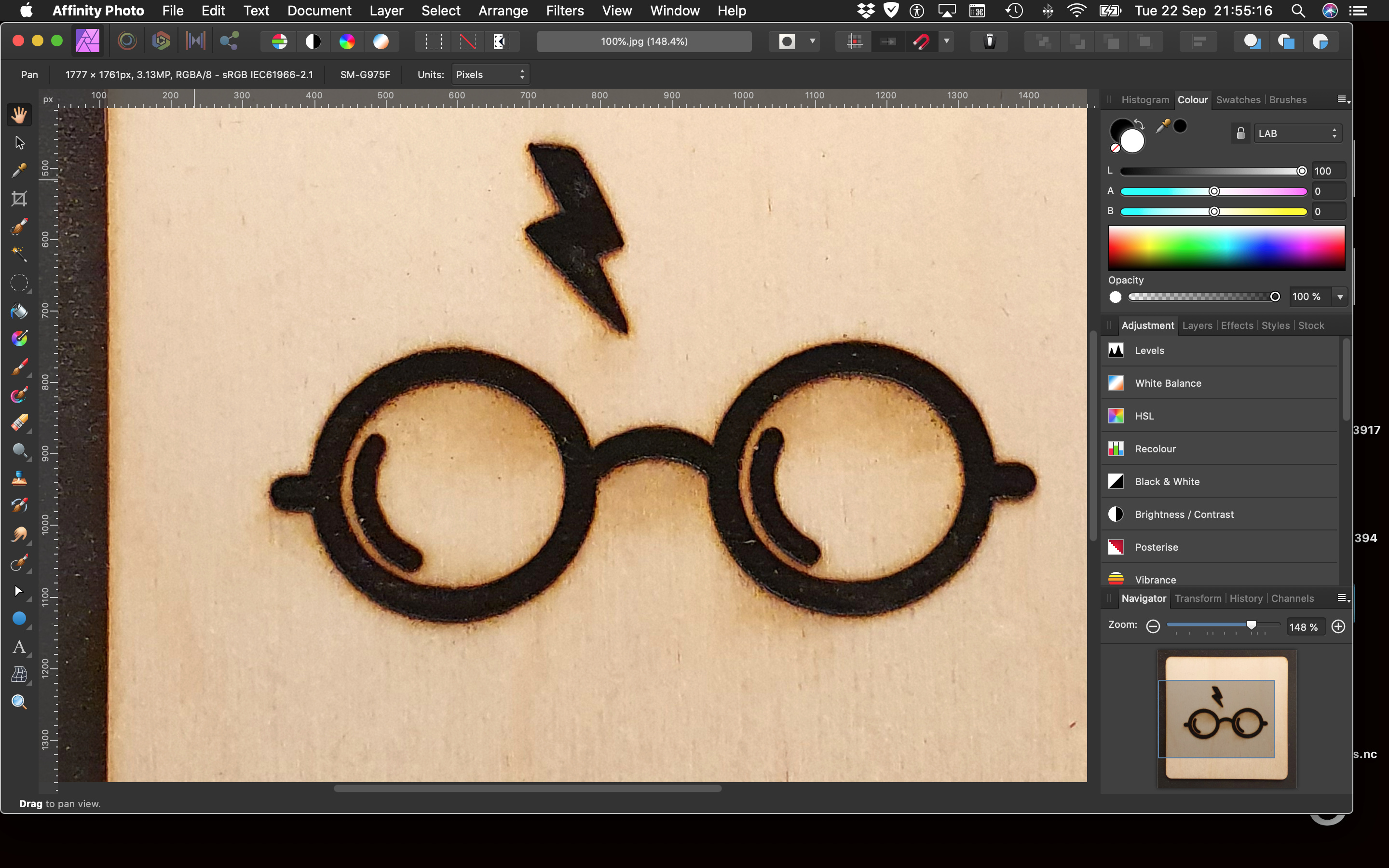

Some preliminary testing of the .svg file. I see nothing wrong with the file and my tests show that it is the settings you have made that are responsible for its appearance. I ran two tests at different power settings and densities. You should remember that my laser is 1600mW and your 200mW laser will need different settings.
Here are two test images made on 2mm plywood with Luban software 3.8.0
1. 100% power single pass density of 7 speed 140mm/min (no dwell time set)
 ![100%](https://us1.discourse-cdn.com/flex022/uploads/snapmaker/original/2X/b/b96f4382cd23514ed5bfc768c3c6923e7a46e68d.jpeg)
This image is far too dark and the edges are scorched around the pattern. There is a lot of smoke staining too. The depth was set to 0.5mm and this is the depth that was cut/burned. You will not in the enlarged version how the edges of the image are completely fried. So the conclusion is too much power or not moving the laser module or the workpiece fast enough.
1. Enlargement of 100% power cut.
 ![Screenshot 2020-09-22 at 21.55.16](https://us1.discourse-cdn.com/flex022/uploads/snapmaker/original/2X/2/2ebdd3a1d4a1f8dea6cabb010d5735e6744bff18.jpeg)
1. 30% power single pass density of 7 speed 140mm/min (no dwell time set)
 ![30%](https://us1.discourse-cdn.com/flex022/uploads/snapmaker/original/2X/e/e98f69e0144032e4ac6ba9b652371cc9d7ac5826.jpeg)
The 30% power cut has much cleaner edges even though it was cut at the same speed. On this basis I would try 40% power, up the density to 10 and try again. In some respects, I prefer not to add to the density setting because this will add more time as it burns more lines closer together.
This is not really interesting just yet but I have another couple of tests running. One is with different software and I suspect that the results will be easier on the eye. One more Luban test will be at 45% power with a density of 7 and the same 140mm/min to see how that works.

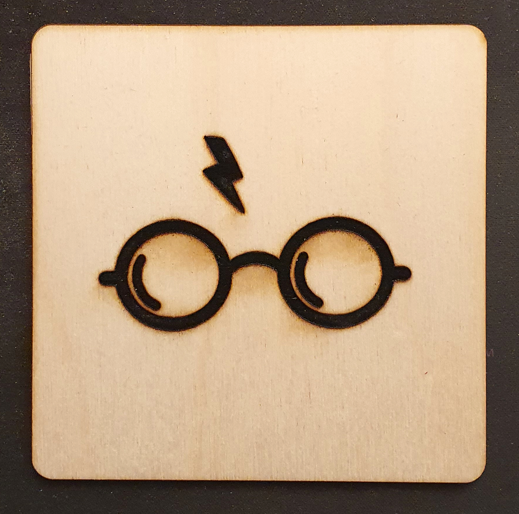

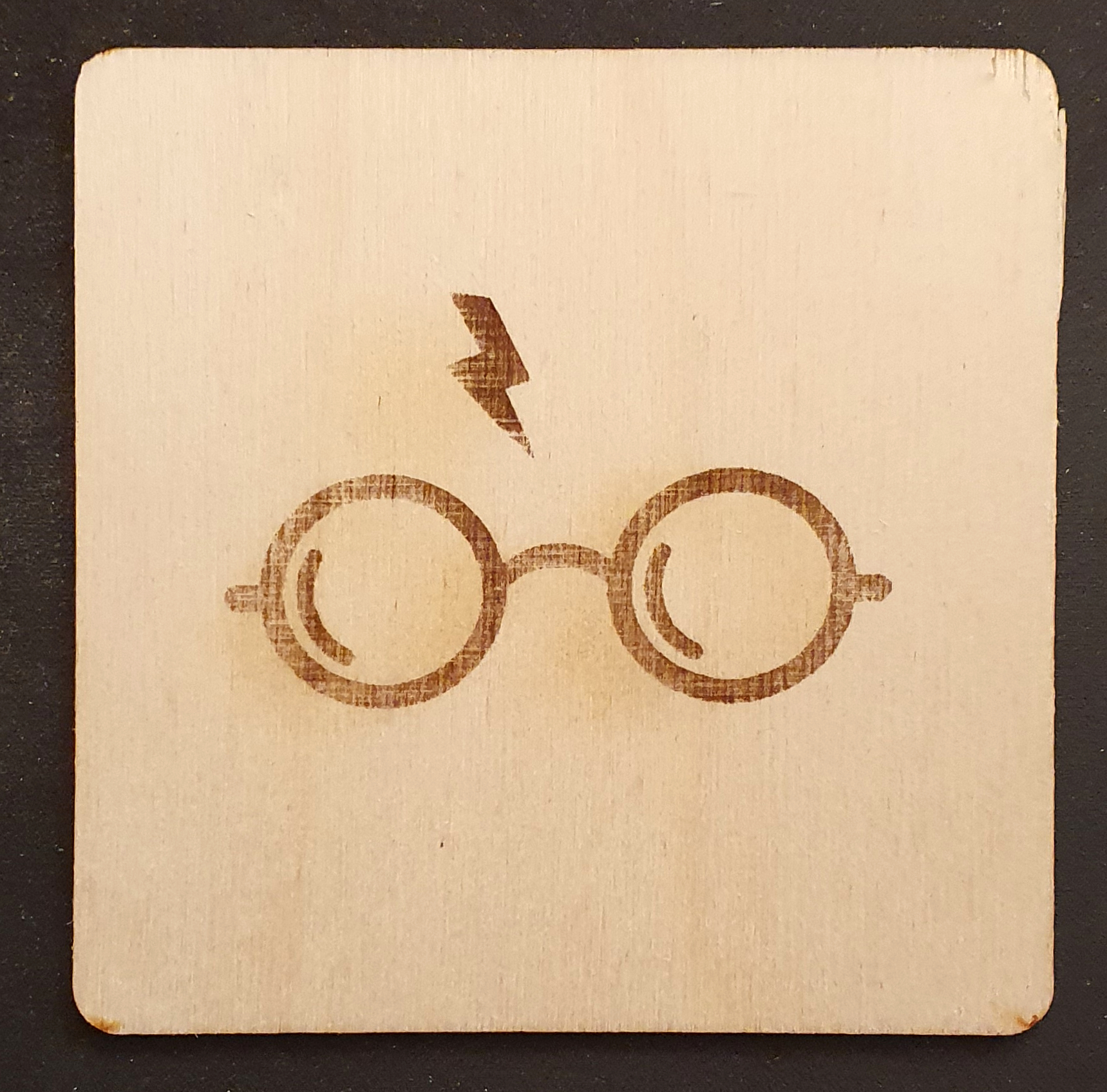

 ![Lightburn vs Luban](https://us1.discourse-cdn.com/flex022/uploads/snapmaker/original/2X/5/5bc084fc6be8767b8709b90c0e142405aef3b5f3.jpeg)
This image of two burns says a lot about Luban. to keep within the 98mm square 2mm plywood borders, I set the size of the .svg file to 85mm in Luban and Lightburn. The Lightburn image is on the left and it is much larger than the Luban image, despite both being cut from exactly the same .svg file. The Luban image has a lot of smoke staining but the cut is reasonable. It has a much neater edge than the file you showed at post 21 and I enlarged in post 22. My conclusion there is that the wood was very open grained and this caused the image to not look particularly clean.
The Lightburn image has filled as much space as it can with the 85mm square image file and the cut is much cleaner. There is a small amount of smoke staining but I think that could easily be removed by moving the laser a little quicker.
The Luban image was cut at 45% power and a density of 7 with a workspeed of 140mm/min and a single pass. It was cut in just over 1 hour.
The Lightburn image was cut at 75% power and a speed of 306mm/min with two passes. It was cut in a time of 30 minutes.
For my money, it is no contest. The Lightburn image is better in every respect and would not require much tweaking to improve it and cut it in a single pass. I would leave the power where it is and add another 150mm/min to the speed of the cut. This would be to reduce the smoke staining seen.
The Lightburn density setting is a lot more complex but I set it to 100 lines per inch. It could stand being a little higher at 150 lines per inch and that would eliminate the horizontal lines you can see. Lightburn cost around 60 dollars but you can try it free for 30 days. I have been writing a little about it since I discovered it. It appears to be much kinder to Snapmaker and I love the files it produces. It looks a little more complex than Luban and takes a bit of learning. It is very well documented with lots of tuition videos as well. It is designed to run any type of laser machine.

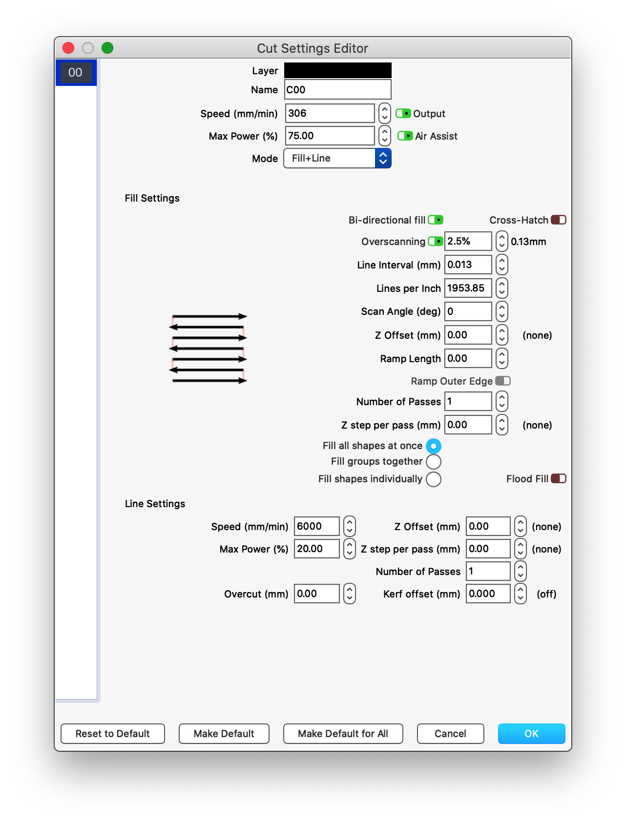

For clarity I am posting an image of the settings in Lightburn that relate to the density of the filling of an enclosed space within a design.
 ![Screenshot 2020-09-23 at 05.22.56](https://us1.discourse-cdn.com/flex022/uploads/snapmaker/original/2X/e/e0579e5deee9462e38a31fdbf3b4e388d3f04434.jpeg)
I used a setting of fill + line (I could have used fill or flood fill only or just line only) Workspeed and power of laser beam are what you would expect to be able to set. I chose a bidirectional fill because it is quicker and I could have chosen a crosshatch fill. I also overscanned the design by 2.5%. This permits the laser to switch off as it leaves the design boundary and on again as it approaches the design boundary. It provides consistency by accounting for velocity changes when the laser beam head slows down, accelerates or changes direction.
_**(at this point the facilities and control are already considerably different to Luban and we are still only discussing controlling the burn rate and type)**_
Line interval and lines per inch are interdependent and you can set one or the other to achieve the same endpoint. Scan angle is simply to determine the direction of any scan lines on your design.
Ramp length for inner and outer edges can be set. Used for setting a slope on the edges for rubber stamp making. Pass number and step is self explanatory. How shapes are filled. I like the individual shapes to be filled as in my owl demonstration in a recent post. Line settings can be different again from fill settings. Where there is a case for using variable power settings, you can set minimum and maximum power outputs.
The forgoing underlines why I did not choose identical settings… the same file was sized differently in each application and no meaningful density equality could be derived.
