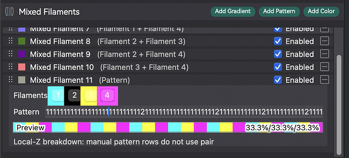

**How to use [https://gradients.garden](https://gradients.garden):**
If you want to create vertical gradients like these, just use the top sections of the app (not the horizontal gradients / G-code modifier section):
 ![3dpreview1](https://us1.discourse-cdn.com/flex022/uploads/snapmaker/original/3X/c/8/c8f22dc54081bf7113055671eb331b5d51692a49.jpeg)
(model in photo is [Tucano\_brazilian bird by William\_Additive](https://www.thingiverse.com/thing:2013157) on Thingiverse / CC BY 4.0)
The gradient lines are shown harshly in the preview so you can see the results in detail, but when printed at 0.08mm layer height the filaments will blend together, which is the core idea of ratdoux’s full spectrum orcaslicer fork (related: see Wombley’s great videos [https://www.youtube.com/watch?v=uE1Su-FUvls](https://www.youtube.com/watch?v=uE1Su-FUvls "https://www.youtube.com/watch?v=uE1Su-FUvls") and [https://www.youtube.com/watch?v=tKfpaVk8jEw](https://www.youtube.com/watch?v=tKfpaVk8jEw "https://www.youtube.com/watch?v=tKfpaVk8jEw") for a exploration of what filament types to use and how to get the best layer mixing).
To create these kind of gradients, first you need to set your filament colors at the top of the page. You can either do this by using the color picker, or by clicking the magnifying glass icon on each slot to search for a real filament (data from filamentcolors.xyz). Set all the filaments you are going to be using in the gradient, and make sure they are in the same slot you are loading them in your machine.
 ![colorpicker](https://us1.discourse-cdn.com/flex022/uploads/snapmaker/original/3X/8/3/836db688a5d3f70aa6afd96b5fb43f7f334ddfaa.jpeg)
 ![filamentsearch](https://us1.discourse-cdn.com/flex022/uploads/snapmaker/original/3X/8/6/862413dbdb73a457fb974d7b0519edcd849231e3.png)
After that you can skip past the blend color creator and 3D preview for now, go down to the gradient creator. Here, by default, it will have a smooth gradient between two filaments (the left side will be the base of the object).
 ![gradientcreator](https://us1.discourse-cdn.com/flex022/uploads/snapmaker/original/3X/c/a/caf9b52e7190b5456a9baceb3c6a30d40f0b7e6a.jpeg)
You can change the filaments at each point in the gradient, and add extra colors to the gradient to create multi-color transitions (like the 3d preview earlier in this post).
To customize the gradient further you can drag the hollow circular nodes on the gradient display to move the position of each color within the gradient. The handle to the right of each node controls the transition speed between colors, drag the white handle down on the cyan node for example to make the gradient mostly cyan and only reach magenta near the end.
While you’re doing this you can use the 3D preview to see how the gradient will look on a real object. You can upload your own 3d model/3mf file to get a better idea of how the gradient will look when printed.

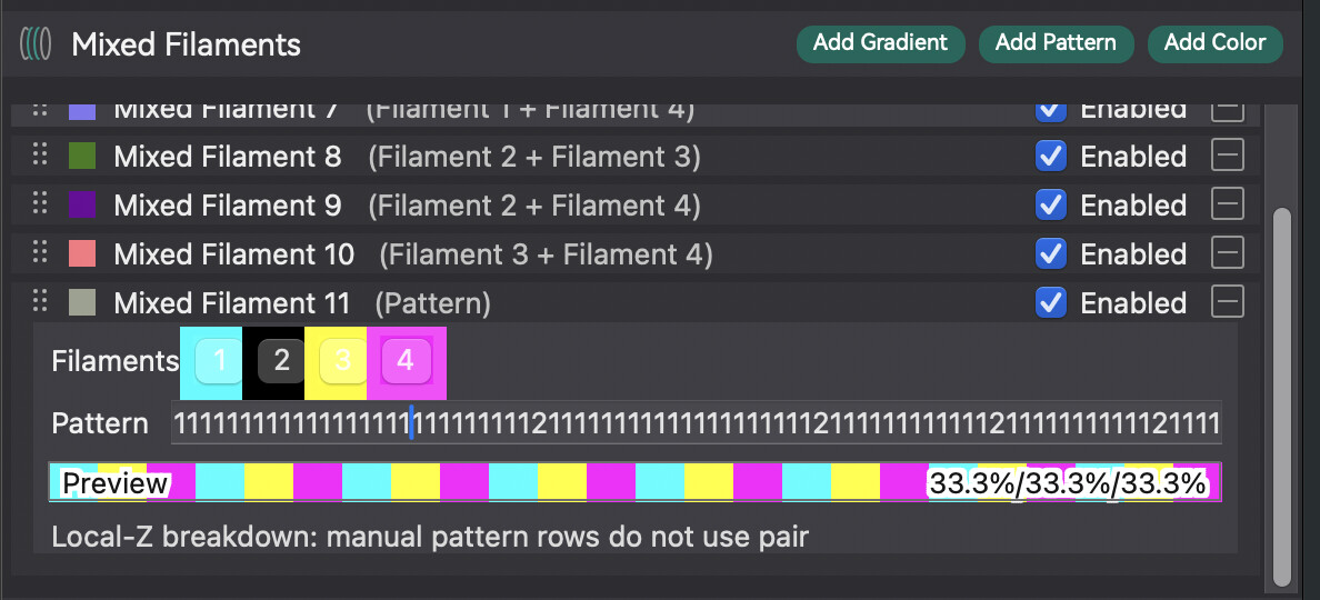

Then when you’re happy with the gradient you have created, go down to the Gradient Output Code panel (you’ll want to leave the dithering strategy panel set to its default unless you’re experimenting).
 ![outputpanel](https://us1.discourse-cdn.com/flex022/uploads/snapmaker/original/3X/1/d/1d9f8da4a50c8d4ec173ecf00bdf67eda40485c1.png)
Here in the output panel you can set how long the dithered output pattern should be. Either type in the height of your model and the layer height you’re printing with and it will calculate how long the output code should be, or you can click ‘Layer count’ and type it in manually (if you know how many layers your model has from your slicer).
Alternatively if you imported your 3D model/3mf in the 3D preview panel you can click ‘Set output to fit model height’ there, and it will calculate the code output length automatically (assuming you’ve still set the layer height you’re printing with in the output panel).
Next you can click ‘Copy to Clipboard’ and bring this code into ratdoux’s Full Spectrum fork of Orca Slicer. In the ‘Mixed Filaments’ section first click ‘Add Pattern’ to create a pattern filament. Then click on the new pattern filament to expand it, and paste the output code into the ‘Pattern’ field.
 ![fullspectrumorcaslicer](https://us1.discourse-cdn.com/flex022/uploads/snapmaker/original/3X/d/1/d13307bdffef49faa9cf2f50c5ca661b4e44bd73.jpeg)
Now you can assign the gradient filament to your model the same way you would any other filament. Either paint it on, remap an existing color, or right click an object and click ‘Change Filament’ in the dropdown menu if you want to color the whole object. You can use as many gradients in the same object/print as you like.
 ![2dgraddragon3](https://us1.discourse-cdn.com/flex022/uploads/snapmaker/original/3X/1/4/1451dc42f3fe5dbd1afdcba9b8a008a123dc3905.jpeg)
There are also some extra options around the UI you can play with to get slightly different results. For example the ‘repeats’ option in the Gradient Creator allows you to loop the gradient pattern multiple times in the same output length (and the ‘flip repeats’ checkbox will mirror each repeated gradient). ‘Reverse’ in the output panel flips the code, you could use that if you wanted to have the same gradient twice in a print but flipped vertically.
