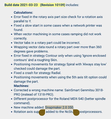

**Post date:** [June 7, 2024, 11:05am UTC](https://forum.snapmaker.com/t/generating-cnc-g-code-that-doesnt-do-unnecessary-work/36068/5 "2024-06-07T11:05:50Z")
Seems like the last update was when they added it back in 2021. Does it have support for quick swap, bracing and 200w?

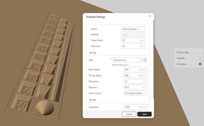

I think you are using a big 3D hammer for a simple, almost 2D carve/cut? Have you tried MS paint or gimp and distinct grayscale layers to create your design?
This is a hub that I CNC’d out of 20mm thick plastic for a 1/4 scale RC Sprint Car:
![image](https://us1.discourse-cdn.com/flex022/uploads/snapmaker/original/3X/f/e/feae57a60f011655f04875b867f27adc3651561d.png)
The white is the top surface, the grey is 50% depth, the black is 100% depth.
This is a nice guide for depth and greys:
 ![image](https://us1.discourse-cdn.com/flex022/uploads/snapmaker/original/3X/4/4/447bc18eeb198696e70bc0aa73489664c3499ecd.png)
Simulated, I always put a small allowance so the Luban software will present it correct but it looks like with the latest version it may not be needed. Luban 4.12 renders things much better it seems:
 ![image](https://us1.discourse-cdn.com/flex022/uploads/snapmaker/original/3X/2/e/2e464389f674768eef1909c9f9d872e1df3fbce4.jpeg)
Hopefully this helps you out…

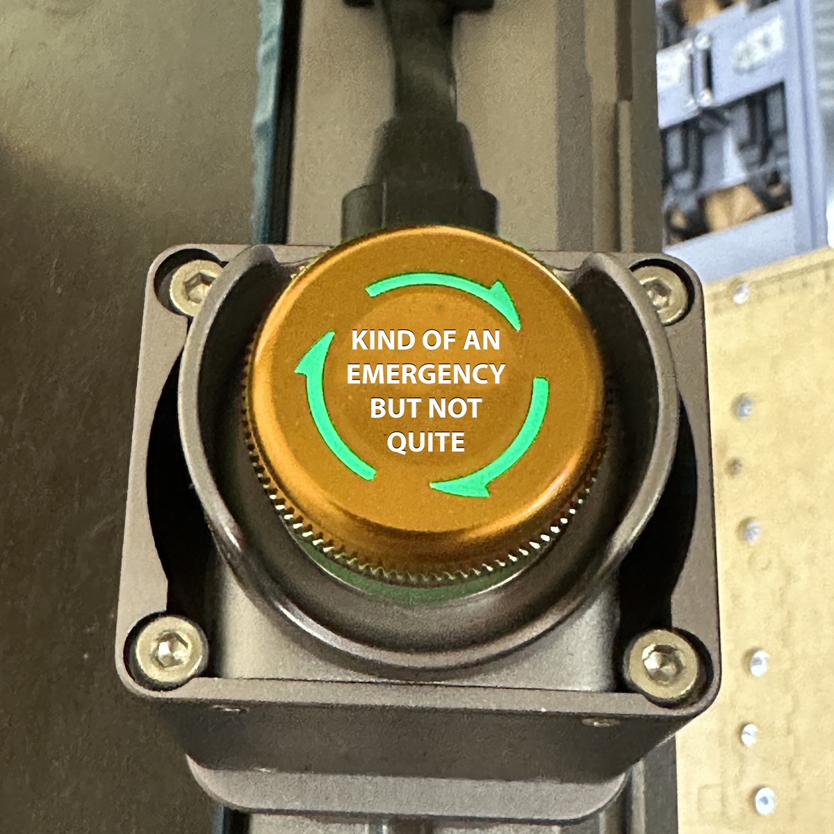

And a third mistake I made was mounting the emergency stop button in the center on the front, rather than off to the side. I, of course, hit the thing accidentally, and bizarrely, there’s no way to resume after that. I really don’t understand why you can shut the power off, and it will be able to know the state it was in and resume, but if you hit the emergency stop button accidentally, it won’t let you try to resume. It’s an arbitrary and glaringly wrong UI design decision.
It’s not like the emergency stop shoves something into a saw blade and breaks off teeth, where you would have to repair the machine afterwards. There’s really no good reason not to have it ask if you want to resume when you power it back on, just like it would if you had accidentally tripped over the power cord. 🙃
Anyway, it seems to be working. And now that I’m not plunging really, really slowly for 10mm after every tiny little cut for the screw head holes, it is only going to take 14 hours instead of 3 days. That’s much more survivable. 😂

On all the emergency stop we have at the factory, there isn’t one that must be reset by power off. All have a reset button on the SCADA screen or physical a button to reset. Why SnapMaker makes it this way, I don’t know.
**Author:** ![snapUser](https://avatars.discourse-cdn.com/v4/letter/s/e19b73/32.png) [@snapUser](https://forum.snapmaker.com/u/snapUser)\
**Post date:** [June 15, 2024, 1:25pm UTC](https://forum.snapmaker.com/t/generating-cnc-g-code-that-doesnt-do-unnecessary-work/36068/16 "2024-06-15T13:25:17Z")
There’s a reason one hits the emergency stop, I’ve had to several times, and have NEVER found the need to resume (as something has gone terribly wrong). I pretty much always have to reset/scrap the work. Power cycling is somewhat inconvenient, but there’s a reason for it, so one doesn’t “resume” into an unsafe operation.
If you feel the need to resume a job, you probably could have just used the Pause button.
**Author:** ![dgatwood](https://sea2.discourse-cdn.com/flex022/user_avatar/forum.snapmaker.com/dgatwood/32/19596_2.png) [@dgatwood](https://forum.snapmaker.com/u/dgatwood)\
**Post date:** [June 15, 2024, 4:05pm UTC](https://forum.snapmaker.com/t/generating-cnc-g-code-that-doesnt-do-unnecessary-work/36068/17 "2024-06-15T16:05:53Z")
> [@snapUser](#):
There are **two** reasons one hits the emergency stop. One is because something is horribly wrong. The other is because it is mounted at the edge of the enclosure, and when your enclosure is on the floor and you’re leaning over the machine, it’s really easy to accidentally brush it with your arm and trigger it.
> [@snapUser](#):
If the pause button were mounted on top of the enclosure where it could easily get bumped accidentally, I probably would have. 😁
**Post date:** [June 16, 2024, 9:06am UTC](https://forum.snapmaker.com/t/generating-cnc-g-code-that-doesnt-do-unnecessary-work/36068/18 "2024-06-16T09:06:35Z")
So, can’t the emergency stop button be mapped as a pause button by some clever firmware dabbler?
