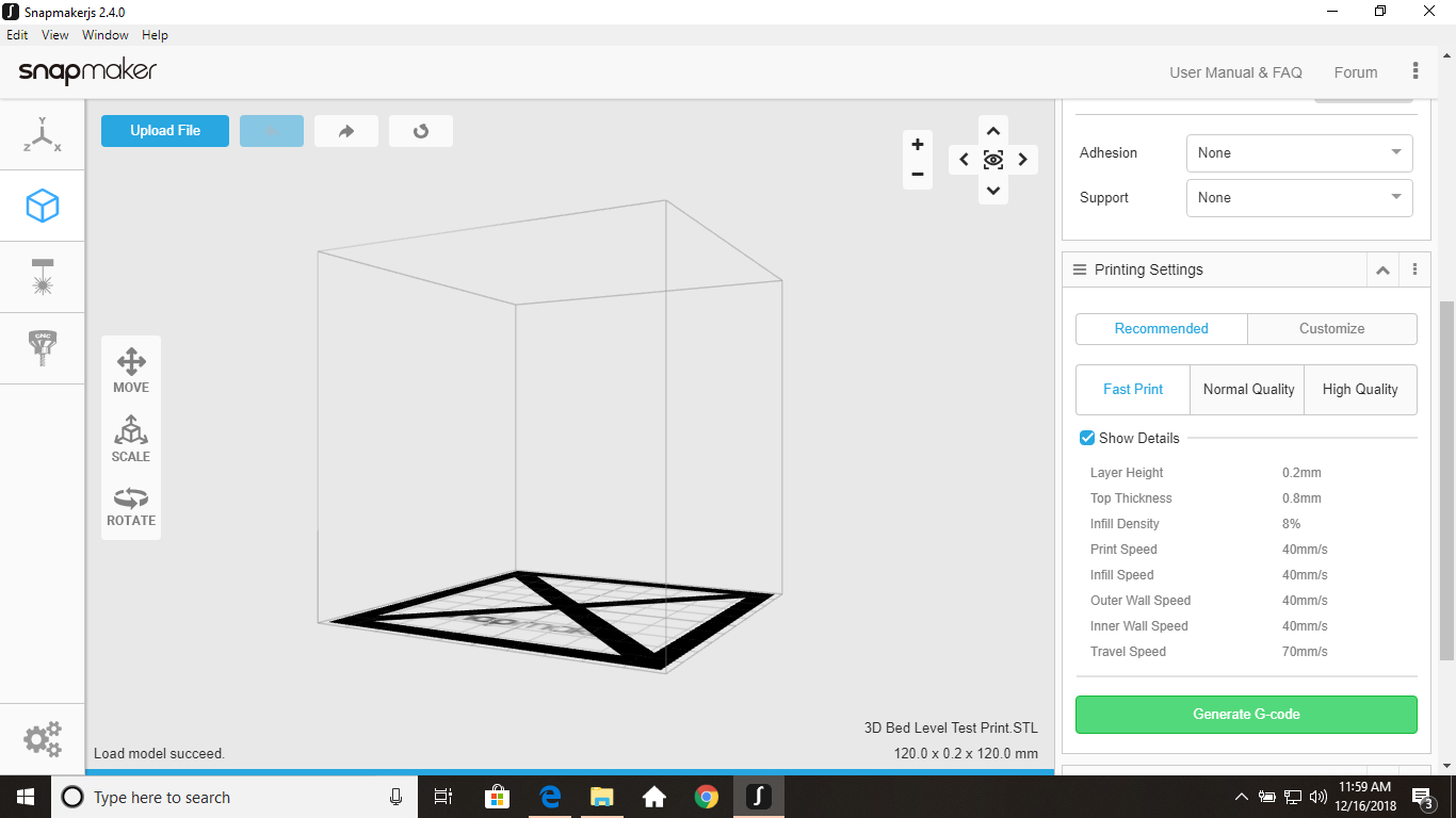

I’m having trouble generating then uploading g-code within SnapMakerjs software. When attempting to print this bed level test file:
 ![image](https://us1.discourse-cdn.com/flex022/uploads/snapmaker/original/2X/4/4c1b7df0fe34df2f76def4e84086b875b902a883.png)

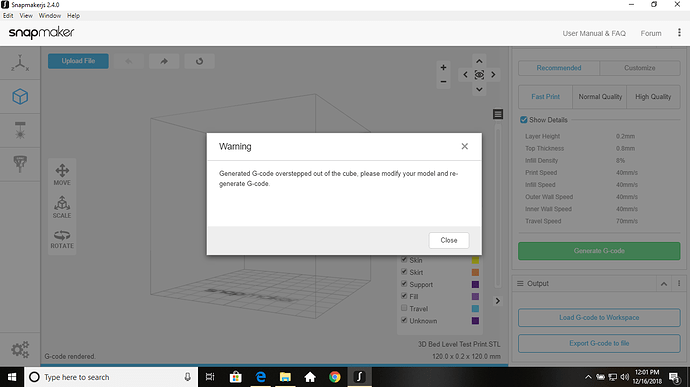

After I generate the G-code the image in the cube disappears. I click on “Load G-code to workspace” and get this error:
 ![image](https://us1.discourse-cdn.com/flex022/uploads/snapmaker/original/2X/3/38bc745648bfc368033cbefc079ff5e8f03ebc80.png)
I’m not using a skirt or raft that setting is set to NONE.
The workspace should print to 125 x 125 mm correct? So why am I having problems generating this g-code and loading it to the workspace to print?
Thanks for your help!

**Author:** ![Jade](https://sea2.discourse-cdn.com/flex022/user_avatar/forum.snapmaker.com/jade/32/30672_2.png) [@Jade](https://forum.snapmaker.com/u/Jade)\
**Post date:** [December 18, 2018, 4:15am UTC](https://forum.snapmaker.com/t/g-code-generation-error-for-bed-level-test-file/3677/5 "2018-12-18T04:15:18Z")
Hi, could you please send me the STL file that causes this problem?
And did you try to use the latest version of Snapmakerjs?
**Author:** ![Borinkito](https://avatars.discourse-cdn.com/v4/letter/b/bb73d2/32.png) [@Borinkito](https://forum.snapmaker.com/u/Borinkito)\
**Post date:** [December 18, 2018, 4:29am UTC](https://forum.snapmaker.com/t/g-code-generation-error-for-bed-level-test-file/3677/6 "2018-12-18T04:29:00Z")
Hi Jade, it’s the test STL file from the SnapMaker Getting Started 3D printing post found here: [[Official] Ready to MAKE for 3D printing](http://forum.snapmaker.com/t/official-ready-to-make-for-3d-printing/147)
To my knowledge I’m running the latest version for SnapMakerjs, as you can see from my screen shots I’m running version 2.4.0. Thanks for any help you can send my way!
**Post date:** [December 18, 2018, 7:12am UTC](https://forum.snapmaker.com/t/g-code-generation-error-for-bed-level-test-file/3677/7 "2018-12-18T07:12:10Z")
Thank you. I know what’s wrong with it now. The height of the model is 0.2mm. However, the default initial layer height is 0.3mm and the layer height is 0.2mm when you choose Fast Print mode. So it is unable to generate the G-code file for this model.
To generate G-code file for it, you need to customize the initial layer height as well as the layer height to a value smaller or equal to 0.2mm.
Hope it helps.

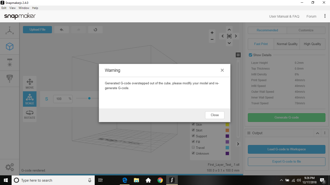

**Post date:** [December 20, 2018, 1:22am UTC](https://forum.snapmaker.com/t/g-code-generation-error-for-bed-level-test-file/3677/9 "2018-12-20T01:22:14Z")
Awesome! Thank you @Jade!! I was able to do my first print! Now on my second print the filament isn’t sticking to the bed. The brim sticks beautifully but when the actual object starts to print it doesn’t stick to the bed. I know that’s for a different section of the forum. I’ll look for that now and see if I can find other similar posts to help me out. Thanks!
