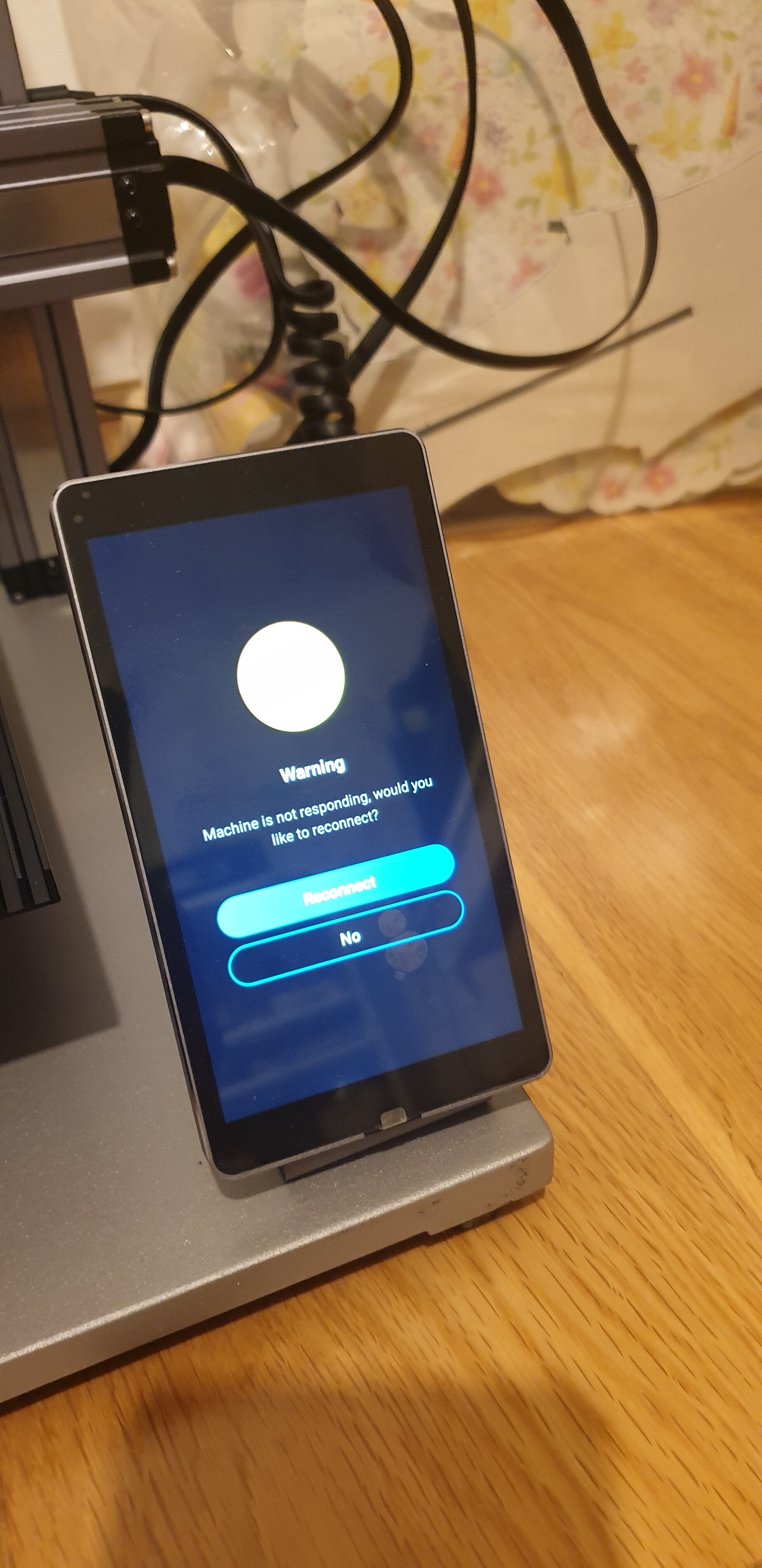

**Author:** ![HasanDj](https://avatars.discourse-cdn.com/v4/letter/h/e79b87/32.png) [@HasanDj](https://forum.snapmaker.com/u/HasanDj)\
**Post date:** [March 2, 2021, 8:23pm UTC](https://forum.snapmaker.com/t/fuse-in-power-cable/16493/3 "2021-03-02T20:23:49Z")
Thank you for your reply brent. Im trying to troubleshoot my machine. Im getting to the point of returning the whole unit.
Im getting this error from the point i got it out the box.
 ![20210302_201800](https://us1.discourse-cdn.com/flex022/uploads/snapmaker/original/2X/1/1afec5714301888e84f81106dd6dcebbcf0d08de.jpeg)
It was happening everytime the machine initialized
and i was told to replace the power supply.
Which help but now the error is occuring inbetween jobs.
Its a shame because ive been watching snapmaker progress from the beginning and having these problem is such a anticlimax.
Ill have to keep on with the support but due to the time difference its takes a long time.
**Author:** ![ElloryJaye](https://sea2.discourse-cdn.com/flex022/user_avatar/forum.snapmaker.com/elloryjaye/32/13979_2.png) [@ElloryJaye](https://forum.snapmaker.com/u/ElloryJaye)\
**Post date:** [March 2, 2021, 8:28pm UTC](https://forum.snapmaker.com/t/fuse-in-power-cable/16493/4 "2021-03-02T20:28:08Z")
My guess would be either a problem with the cable connecting to the screen, or with the connector it slots into at the screen end (which I seem to recall others having problems with).
