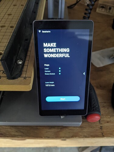

I will start out by saying, I do NOT recommend this. This was mostly for me to test _could it be done_. Since I’m writing this guide… guess it can! For those who want to try it anyway, I’ll layout how to do it, but be warned. _ **This is an advanced process.** _ It will require a lot of double-checks, a bit of initial setup for origins, and a bit more gcode editing (nothing _hard_ though, and most can be done with a batch script if someone chose to write it). That being said, onward I guess!
 ![PXL_20221225_182309622](https://us1.discourse-cdn.com/flex022/uploads/snapmaker/original/3X/8/7/876eea9765de8ddd8bc18c9926e24193fc70fa67.jpeg)
This is an extension of my Lightburn + Rotary Guide found here;
> [@Lightburn + Rotary Guide](https://forum.snapmaker.com/t/lightburn-rotary-guide/28542):
> This is going to be a quick guide on the settings/required modifications to use the rotary module with Lightburn. I am sorry, but it will require following the beginning of my full lightburn control guide. Mainly flashing the custom firmware (as of writing, make sure you’re on the latest 1.14.3 before loading the custom firmware and do NOT turn the machine off until it’s done). Follow along until the GCode header/footer section, for the rotary you only need M3 S0 in…
However, do note, there IS a specific gcode header/footer that needs to be inserted. I suggest making a new device in Lightburn so you can swap between them easily.
In this guide, my equipment used is as follows;
Machine: Snapmaker 2.0 A350
Tool: 1.6W Laser
Accessory: Rotary Module
Material: Cherry wood.
Software: Lightburn 1.3.01 (current as of writing)
Since this is a bit advanced, I’m assuming you’re familiar with the custom firmware from my Lightburn guide, so we’ll assume you have that already, and you already enabled the rotary module with the proper settings/diameter in Lightburn.
To start, we’re going to have to find a repeatable, unchanging origin. This assumes you’ve setup the rotary module and calibrated before. The snapmaker sets your laser height to the center of the rotary module, so instead of the plate like in my standard guide, our Z0 is the center of the rotary module. This seems to be about _84mm_ taking the current laser height, minus my focal length. 107 - 23 = 84. However, this is technically irrelevant. As last time, we’re using the _Laser Height as Z0_ from the homescreen. Mine is 107mm.
 ![PXL_20221225_154559902](https://us1.discourse-cdn.com/flex022/uploads/snapmaker/original/3X/2/0/2064190599e9b97f22d94b99f5fc541eff7741c4.jpeg)
Next, you will need to get a zero point on the rotary, I like to make one of the jaws directly up and center it using one of the chuck keys. Just slightly open the chuck enough that it sits infront of the key, but not hitting it, and rotate until centered.
 ![PXL_20221225_172713611](https://us1.discourse-cdn.com/flex022/uploads/snapmaker/original/3X/c/9/c93dd8d088ea070634427ab3615c671ce16ebc44.jpeg)
Afterwards, set B origin on the touchscreen to make this `B0`. I would suggest power cycling the machine here, because for some reason, the Snapmaker likes to move whatever degrees you moved to set it before a job for no apparent reason. So if the machine starts here, it stays here. Rehome after reboot and move on.
Since we know this is where the laser focuses in the center of the rotary (where the chuck jaws meet in the center), we can figure out how to focus the laser on the chuck to get an origin. I measured the jaws and each one is _25.5mm_ so add that to your _Laser Height_ to get the focus height ontop of the jaw. So on my machine that’s 107 + 25.5 = 132.5. Jog Z down to this height in _Machine Coords_, column on the left. Now you’ll want to move the laser to where it lands directly on the center front of the top jaw, you’ll have to move, turn the laser on, move, turn the laser on. Afterwards, gently bump it so the laser just goes off the edge infront of the jaw. _This is going to be our Origin._ You can use my locations to get close, then dial it in on your machine. **WRITE THESE LOCATIONS DOWN FROM YOUR MACHINE.**
 ![PXL_20221225_154549846](https://us1.discourse-cdn.com/flex022/uploads/snapmaker/original/3X/0/3/03dfac5a90c33e6aeda6b52533147a2ada36f990.jpeg)
Should look like this:
 ![PXL_20221225_154553620](https://us1.discourse-cdn.com/flex022/uploads/snapmaker/original/3X/8/b/8bbe65ac163f80b03a78d350c50dc01ca928a79e.jpeg)
Note I do not use the shroud on my 1.6W laser, so yours might look closer than mine, but the laser should be focused directly on the very tip of the jaw.
