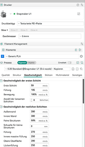

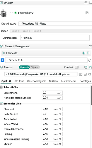

What filament type & brand?
First layer Height?
First layer Width?
First layer speed?
First layer infill speed?
Please 🙂
**Author:** ![Artur777](https://sea2.discourse-cdn.com/flex022/user_avatar/forum.snapmaker.com/artur777/32/32182_2.png) [@Artur777](https://forum.snapmaker.com/u/Artur777)\
**Post date:** [July 22, 2026, 1:59pm UTC](https://forum.snapmaker.com/t/first-layer-issues-after-installing-original-hardened-steel-hotends/42607/3 "2026-07-22T13:59:53Z")
![Screenshot 2026-07-22 at 15.57.35](https://us1.discourse-cdn.com/flex022/uploads/snapmaker/original/3X/e/b/ebc70fad9ca7cf0f61386e33b370276f36c1d270.png)
 ![Screenshot 2026-07-22 at 15.57.52](https://us1.discourse-cdn.com/flex022/uploads/snapmaker/original/3X/0/8/0808c0668196afa5b3aa10f63ec0d3b152aed511.png)
PLA, Bavafil

OK, so the new full bed prints show you were (for whatever reason) under extrusion
keeping the flow at 1.02 & Zoffset at -0.02 if you now change the first layer width to 0.6 does that help/worse?
**Post date:** [July 23, 2026, 10:40am UTC](https://forum.snapmaker.com/t/first-layer-issues-after-installing-original-hardened-steel-hotends/42607/20 "2026-07-23T10:40:39Z")
It’s currently set to 0.6.
I saw a significant improvement when I increased the flow ratio from 1.00 to 1.02.
Right now, I’m testing the original Snapmaker SnapSpeed PLA. I’m leaving the Z-offset at -0.02. The default flow ratio for this filament is 0.966.
The first test still showed slight under-extrusion in exactly the same areas. I’m now running another test with the flow ratio increased to 0.999.
 ![Bildschirmfoto 2026-07-23 um 12.34.23](https://us1.discourse-cdn.com/flex022/uploads/snapmaker/original/3X/6/6/66f2719885f7ca1bce5d153268c05e8ad3aadf69.png)
 ![WhatsApp Image 2026-07-23 at 12.39.14](https://us1.discourse-cdn.com/flex022/uploads/snapmaker/original/3X/9/5/953edc5eb5810a72865b04a22c27daae07dc47ae.jpeg)
