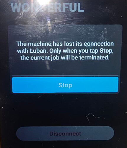

**Post date:** [May 24, 2023, 12:37pm UTC](https://forum.snapmaker.com/t/file-transfer-via-wifi/5270/73 "2023-05-24T12:37:24Z")
Interesting, In my case machine displays a message
> The machine has lost its connection with Luban. Only when you tap Stop the current job will be terminated.
I first noticed it with Lightburn sending files over wifi with api calls for laser jobs. And now just checked it with Luban for 3DP.
Machine will finish the job tho, unless you press stop button.

We loose the status update on the touchscreen
On the other hand, I assumed Octoprint would be responsible for heartbeat connection not PS.
I guess I have to ask how do you run the sm2uploader in connection with PS, do they start and stop at the same time when you start and stop PS?
**Post date:** [May 24, 2023, 12:49pm UTC](https://forum.snapmaker.com/t/file-transfer-via-wifi/5270/74 "2023-05-24T12:49:08Z")
The way the snapmaker works if you use the API, is it fully uploads the gcode to a temporary storage on the controller. Then when the `start_print` API is called, it begins feeding that file into the motion system to begin printing.
The heartbeat (which is just a status call every second or so) is only required to keep the machine in a ‘connected’ state and the live updates in Luban. If you disconnect, it will keep going just fine, just don’t press the stop button on the touchscreen. You can reconnect Luban later to check the status as well.
I personally use my drag/drop files to run files, simply export the gcode, drag it ontop of the batch file, and it automatically uploads it to the snapmaker and starts it. Funfact; you can actually retrieve the files uploaded in this manner from the controller using the `print_file` API.

**Author:** ![macdylan](https://sea2.discourse-cdn.com/flex022/user_avatar/forum.snapmaker.com/macdylan/32/18460_2.png) [@macdylan](https://forum.snapmaker.com/u/macdylan)\
**Post date:** [May 24, 2023, 1:38pm UTC](https://forum.snapmaker.com/t/file-transfer-via-wifi/5270/76 "2023-05-24T13:38:24Z")
> [@nweolu](#):
You’re right, that prompt is very very stupid 💩 💩, you can’t go back to the previous screen until the work is done.
