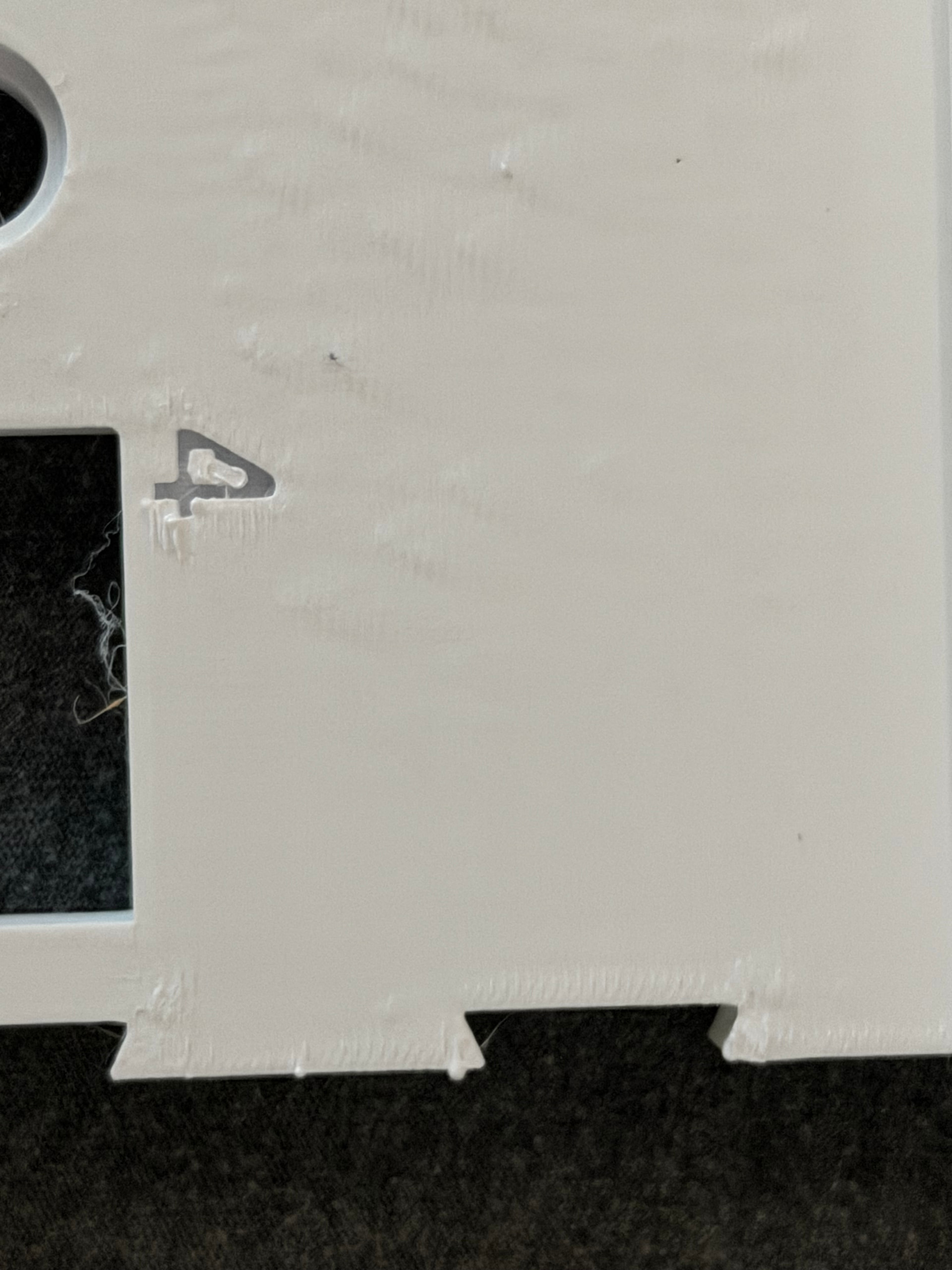

It doesn’t happen all the time, but it happens often enough to make me reconsider buying this printer. The extruder nozzle grinds into the prints as it works, causing either patterns etched into the print that resemble the inverse of the infill pattern or the print to fail outright. At this point I have more failed prints than good ones. I am completely at my wits’ end with this printer, which is now nothing more than an overpriced paperweight. Does anyone have any suggestions?

How is that a solution? Oh, I know it’s not. I am going to re-run one of the prints that exhibited the problem to see if what I currently think caused the problem is, in fact, the issue. If it is, I will share it here and on Reddit; however, saying “submit a ticket” is not solving anything until then.

May you show us your print defects?
I guess you need to add a z-hop to your slicer settings but it’s not clear for me.
What’s your 3dprint skill level, are you aware of settings like z-hop?

I’ll try adjusting my Z Hop from 0.4 to 0.6, but I’m unsure what that will do for this. It’s only grinding BECAUSE of this. Round prints like those fidget balls and characters like the baby dragon print perfectly. It’s just long flat prints that give me grief.

Bottom, it’s a bit hard to say but it seems your nozzle is too near to the bed. ( I don’t know if there is a possibility. Probably on the touchscreen live z-offset while printing?)
Top surfaces are rough because of support structure or not enough top layers.
Increasing the top layers would help, less top layer speed could help too.
Hope it helps.

Looks to me like it could be over extrusion. Also agree with the over extrusion comment. What did your 1st layer look like?

I checked with our print-process guys and combined other tips from the thread—what you’re seeing looks like Pillowing defect. The core idea is to use the process of elimination:
 ![img_v3_02tf_89816b36-5d0b-4b10-a617-e397c4427aeg](https://us1.discourse-cdn.com/flex022/uploads/snapmaker/original/3X/f/0/f025d6d39dce3e1aa05a2ca39b922c97af249e8a.jpeg)
1.First-layer issues
(1) Filament gone bad? Re-print the same file with official PLA and compare.
(2) For third-party filament, run a one-off flow-calibration (tick the box before sending the job). If the result improves, save that flow value directly in the filament profile so it sticks with the spool.
 ![image](https://us1.discourse-cdn.com/flex022/uploads/snapmaker/original/3X/a/c/ac12a3aca77fe700d5504d1eaa4297b9635e0be2.png)
2.Check and adjust top-surface settings:
（1）Increase top layers (try 3–5) and switch internal top infill to rectilinear.
（2）Lower top-layer speed slightly.
 ![image](https://us1.discourse-cdn.com/flex022/uploads/snapmaker/original/3X/d/2/d23f7e2edc2028d20f6286eb2380b7f0977a05f5.png)
3.Your filament parameters don’t match:
（1）Third-party filament temperature is off—try raising nozzle temp (start with +10 °C; if it helps, print a temp-tower to find the sweet spot).
PS：The Z Hop is enabled by default; it’s recommended to just keep the default setting.

I’ve done that; I have used Snapmaker filament, Polymaker filament, and eSun Filament, and it’s the same issue. I have done all of the calibrations I could possibly do, both the built-in ones and ones that the fine folks in this group and Reddit have suggested, and it’s STILL THE SAME. Mind you, the printer I got was sometime in November/December, so unless you sent out the printers with bad filament, it’s definitely not that. Let’s accept that, when this happens, there might just be a hardware problem. Maybe I should have just stayed with the resin printer or gone Prusa/Bamboo. Either way, I submitted a ticket with Snapmaker, and I am sure it will go one of two ways: denial or help. I am hoping for the latter but expecting the former.

I have no idea if this is relevant but did you check the yellow knobs under the bed to make sure they’re not loose and causing the bed to wobble? Is that even a thing?
Regardless, with all the pre-production and production units out there, there’s bound to be a few that have issues before packaging, even after passing QC.
Early reviewers and forum posts suggest that Snapmaker Support has done just that, supported the users. Nothing is ever perfect so here’s to hoping they carefully consider sending you a replacement! Sucks having to wait but it seems the best alternative at this point…
**Post date:** [January 16, 2026, 5:14am UTC](https://forum.snapmaker.com/t/extruder-nozzle-grinding-into-prints/40760/21 "2026-01-16T05:14:42Z")
I remember the knobs under the heated bed are quite tight; they’re usually only used when you need to perform bed leveling. But the bed is usually leveled one time at the factory before shipping.But I don’t think this is what’s causing your issue.
Still, I’ll add the steps just in case.
After the bed is mechanically leveled, you normally only need the software-level compensation from now on (see image) and won’t touch the mechanical knobs again.

Actually, none were loose, but one (the front right, as you face it) was tightened so much that it required a tremendous amount of force just to move, even with the printable knob extension (a very good idea for everyone to print!). I discovered that when I was performing the manual bed leveling for the first time. The springs under the print bed are actually quite good and keep the bed from wobbling, so much so that I am sure that it would almost be a two-person job to replace the heated bed if you needed to. Hopefully, this can be resolved. I want to use the printer for things other than fidget balls or baby dragons.
