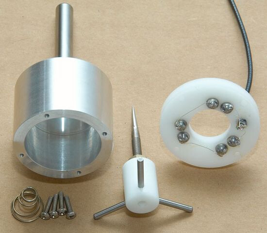

**Post date:** [January 30, 2022, 6:33pm UTC](https://forum.snapmaker.com/t/external-z-probe-sensor/9919/33 "2022-01-30T18:33:23Z")
You could try making one using ball bearings which could give better resolution
 ![image](https://us1.discourse-cdn.com/flex022/uploads/snapmaker/original/3X/4/b/4bbe1a24936a19d2e72f270edbb2c2f9f35eb953.jpeg)
Unless that’s what you’re already doing, haven’t seen the design for it.
**Author:** ![brvdboss](https://avatars.discourse-cdn.com/v4/letter/b/9f8e36/32.png) [@brvdboss](https://forum.snapmaker.com/u/brvdboss)\
**Post date:** [January 30, 2022, 7:42pm UTC](https://forum.snapmaker.com/t/external-z-probe-sensor/9919/34 "2022-01-30T19:42:35Z")
That’s exactly what I have been doing. But right now everything is printed, didn’t tweak all tolerances perfectly and even the printed probe tends to bend a bit.
I’ll create a separate topic for it in due time as I am progressing and have cleaned up the design a bit.
