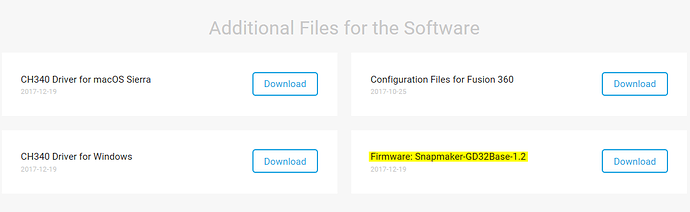

- Bug fixes for some printers with the USB Disk (we sent an email to users who must upgrade the firmware).
Download at [https://www.snapmaker.com/download](https://www.snapmaker.com/download)

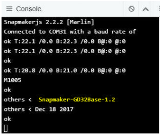

2. Please follow these steps to check if your printer is upgraded successfully: connect the printer to the computer -\> open Snapmakerjs -\> In the console section, enter M1005 -\> check the result. If the result is the same as the following picture shows, the upgrade was successful.
