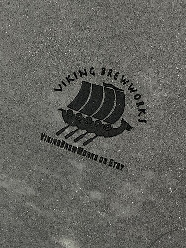

**Post date:** [November 5, 2020, 9:23pm UTC](https://forum.snapmaker.com/t/cutting-polystyrene-foam-eps/11225/15 "2020-11-05T21:23:11Z")
It might not actually take many passes.
I just put my logo on the bottom of a couple slate trays that had some foam-type cushioning on the bottom. I had intended to just lightly melt the foam just enough to leave a mark, but forgot to change my power settings. At 2000mm/m and 100% power it went through 3mm foam no problem. White might not work as well as black.
What it did:
 ![IMG_5246](https://us1.discourse-cdn.com/flex022/uploads/snapmaker/original/2X/b/bae27358dd9a17e9436afadb976433e3ec86b265.jpeg)
What I meant to do at 10%:
 ![IMG_5245](https://us1.discourse-cdn.com/flex022/uploads/snapmaker/original/2X/9/936149d33fa351d264e511a04a568edff9ebd114.jpeg)

Learned something again
**Post date:** [November 5, 2020, 9:34pm UTC](https://forum.snapmaker.com/t/cutting-polystyrene-foam-eps/11225/17 "2020-11-05T21:34:08Z")
Look at this guy, actually doing things. Didn’t you hear the discussion? Your house is on fire now 🤣
Big thanks for sharing that - that gives me a few ideas to try. That technique could be great for making foam painting stamps.
**Post date:** [November 5, 2020, 11:12pm UTC](https://forum.snapmaker.com/t/cutting-polystyrene-foam-eps/11225/18 "2020-11-05T23:12:34Z")
Just the garage. 🥵
It was a short job so I watched it (with goggles and enclosure) and I have a good ventilation system that goes outside. I figured that even if it was pvc or something else that was bad to burn it was so small it would be fine.
Keep the work speeds up and most things aren’t going to burst into flame. If they are they’re going to do it right at the start. I have a halon fire extinguisher standing by. Might smolder a bit.
