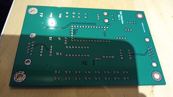

After not hearing from teh local supplier, JLC it is.
After surprising short time i got the PCBs deliverd today.
Now im just waiting on Mouser to ship my order so i can populate the whole thing. (Just orderd one set to test first then get more if there is need/interest, or if i kill parts due to mistakes. 😃

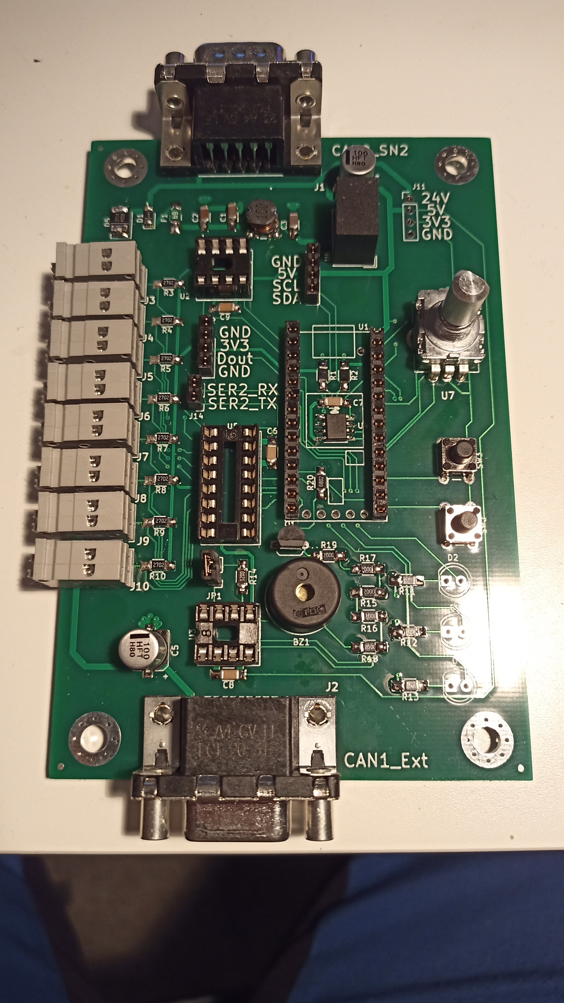

Empty 10PM
 ![IMG_20210205_220251_3](https://us1.discourse-cdn.com/flex022/uploads/snapmaker/original/2X/a/aac162812953e73963dfcbd8805b7a46d9150398.jpeg)
2h later, everything fitted, Chips arent on yet, to check powerrails and such for shorts or other issus.
 ![IMG_20210205_235328_0](https://us1.discourse-cdn.com/flex022/uploads/snapmaker/original/2X/a/afbd690965b8c7d8d07abf52892cfb1b9162ac66.jpeg)
Problems found sofar:
- GND plain makes GND pads look realy bad on solderblobiness
- My Handsoldering is questionable
- the Buzzer is the wrong footprint
- the Socketstrips the teensy will be in are nto agood diea to cut, they break and now the top right pin of them is broken and looks bad.
But, sofar so good, tomorrow ahead with Powering it up first time.
With everything on wil follow then.
maybe with the first black components shortly after 😃

**Post date:** [February 15, 2021, 9:17pm UTC](https://forum.snapmaker.com/t/custom-extension-module/13424/36 "2021-02-15T21:17:28Z")
Checked the powerrails a while ago, Teensy gets power by itself with just beeing connected to the SN2 system from the 24V to 5V regulator.
What Works:
- Buttons
- LEDs
- Buzzer
- FRAM (The selftest is good, didnt store Datayet)
- ADC (Channel 5 doesnt, investigating that currently)
What doenst work
- Rotary encoder (looses steps if rotated to fast (debouncing isnt correct yet)
- Menu for Screen (not implemented)
Things to change for Rev2:
- Discharge Resistors for Caps
- TVS diodes for CANbus
- Mountinghole positions
- DCDC-Converter and OLED header Placement
- Different Transistor for Buzzer
Anything else "obviously wrong form what you’ve seen sofar my friends?
Mountingholes may get a rework aswell to be either SN2 compatible or be a standart-ish format.
Im also open for things that should get implemented on the Module software wise. The board itself is already quite cramped.
 ![IMG_20210215_221347_6_Cropped](https://us1.discourse-cdn.com/flex022/uploads/snapmaker/original/2X/5/59ce4a45790c39aa2f5851faf89167be4e659c79.jpeg)

Maybe you can add some PWM or 0-10V to controll a new heat bed?
i guess that you might not have the space anymore for some terminals
unless those grey things are terminals i dont know what those are actually.
**Author:** ![Streupfeffer](https://avatars.discourse-cdn.com/v4/letter/s/f9ae1b/32.png) [@Streupfeffer](https://forum.snapmaker.com/u/Streupfeffer)\
**Post date:** [February 16, 2021, 8:08am UTC](https://forum.snapmaker.com/t/custom-extension-module/13424/38 "2021-02-16T08:08:53Z")
I do have 2 pins left over. So possibly could add tow pwm channels. Are Optocopplers enough? So you would need still an external driver for the actual load of the heatbed.
Although having a second module doing just the PID and heating controlle would sorta make more sens. Would have its own Option for Powersupply, own CANbus stuff, more space for bigger driver mosfet and such. should be possible with a relativly “small” MCU.
Yes the gray things are terminals. The tempsensors are going to be connected there.
