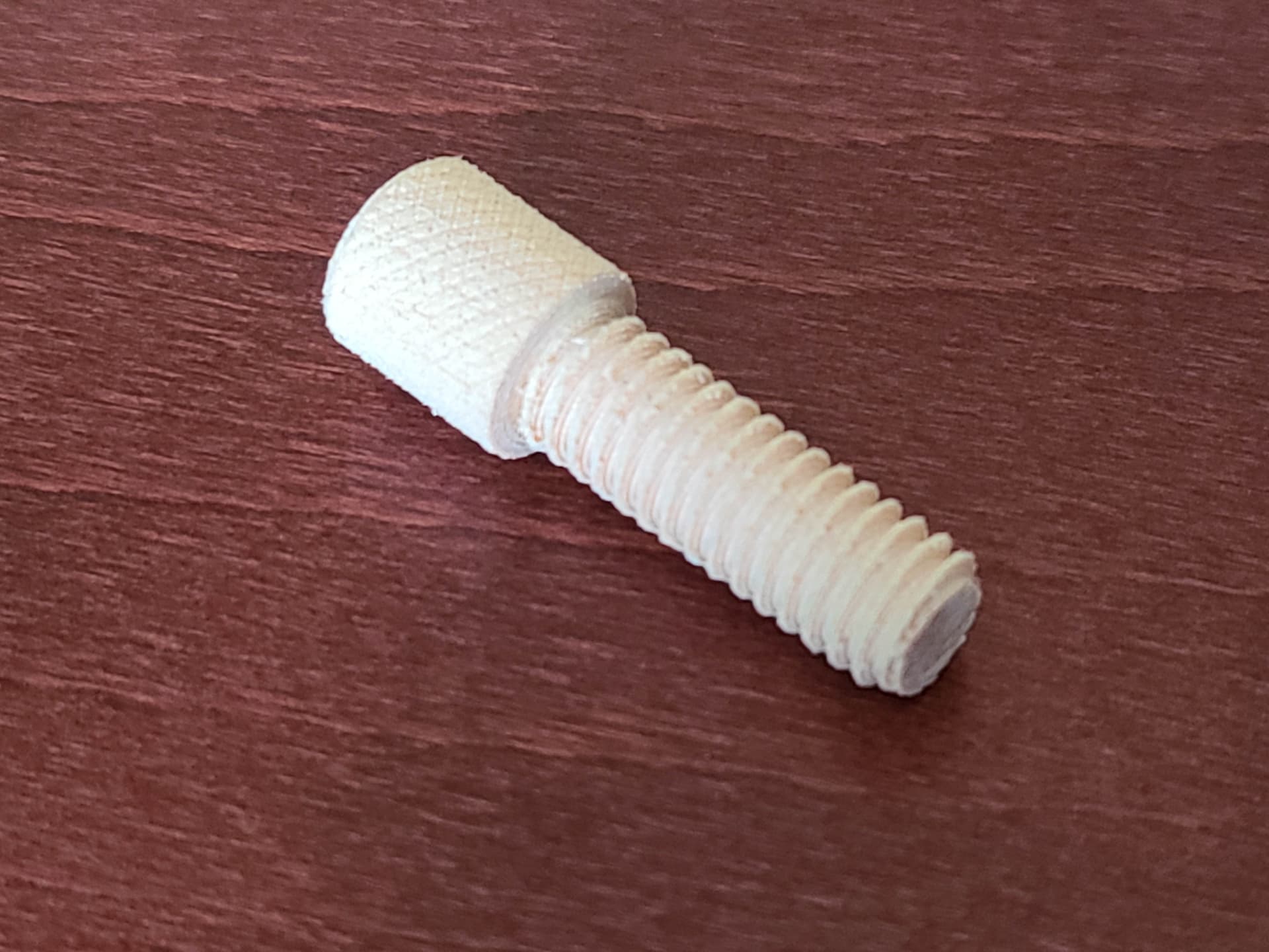

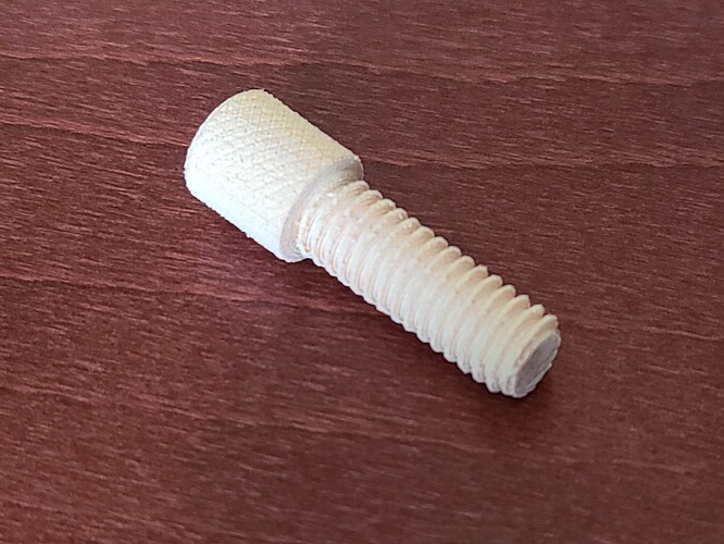

Thread milling, no problem! 😀
 ![20210627_131137](https://us1.discourse-cdn.com/flex022/uploads/snapmaker/original/2X/0/098b513a87187308ca4c517d3667adde6ee3a361.jpeg)
