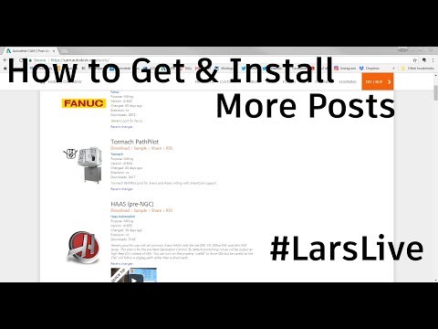

**Author:** ![Waldo](https://sea2.discourse-cdn.com/flex022/user_avatar/forum.snapmaker.com/waldo/32/1704_2.png) [@Waldo](https://forum.snapmaker.com/u/Waldo)\
**Post date:** [May 4, 2020, 7:54pm UTC](https://forum.snapmaker.com/t/cnc-spindle-speed/6474/7 "2020-05-04T19:54:36Z")
Thank you Bilzer
I’m now going through the YouTube video you pasted in another thread/topic. It is very helpful.
In terms of settings, what would you use as the Maximum Roughing Stepdown? I know it depends on the bit, but I don’t want to overload the linear modules. I’m not concerned in breaking a bit, they can be replaced, but am concerned on putting too much strain on the Snapmaker.
Apologies, second question;
How do you handle tool changes or do you currently use one bit?
Regards
[![](https://img.youtube.com/vi/KL1mNnI218U/hqdefault.jpg "Fusion 360 CAM — How to get &amp; Install more Post Processors — #LarsLive 93") ](https://www.youtube.com/watch?v=KL1mNnI218U)
