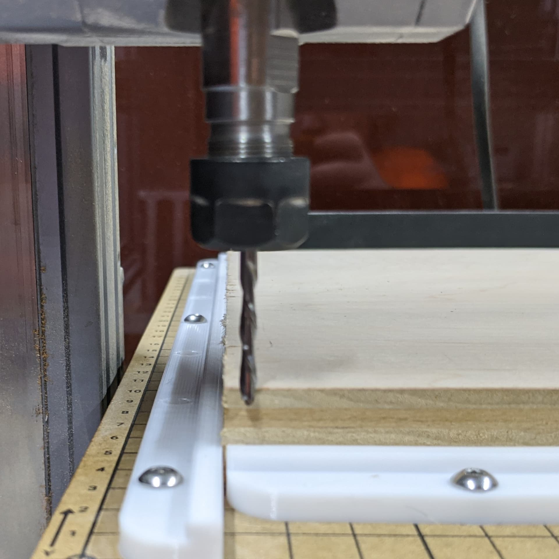

_II_: **Finding the Work Origin**
1: Load in a straight bit you know the diameter of.
1a: I’m using a 3.175mm for my roughing, so it was what I already had in. Keep in mind the size of your bit, as we’ll be using that math later.
2: Locating X origin
2a: Carefully lower the bit down to the left of the material, then slowly move it against the side using the calibration card.
2b: When you feel resistance, jog Z up higher than the material.
2c: Divide the diameter of your bit by 2 to find the radius (3.175/2 = 1.5875). Jog toward the material (X positive) 0.1mm to compensate for the calibration card, then the radius of your bit (since the snapmaker limits manual control, I use 1.6mm here).
2d: The center of your tool should be directly over the edge of the material.
2e: On the control screen, go to the set origin tab, set X origin.

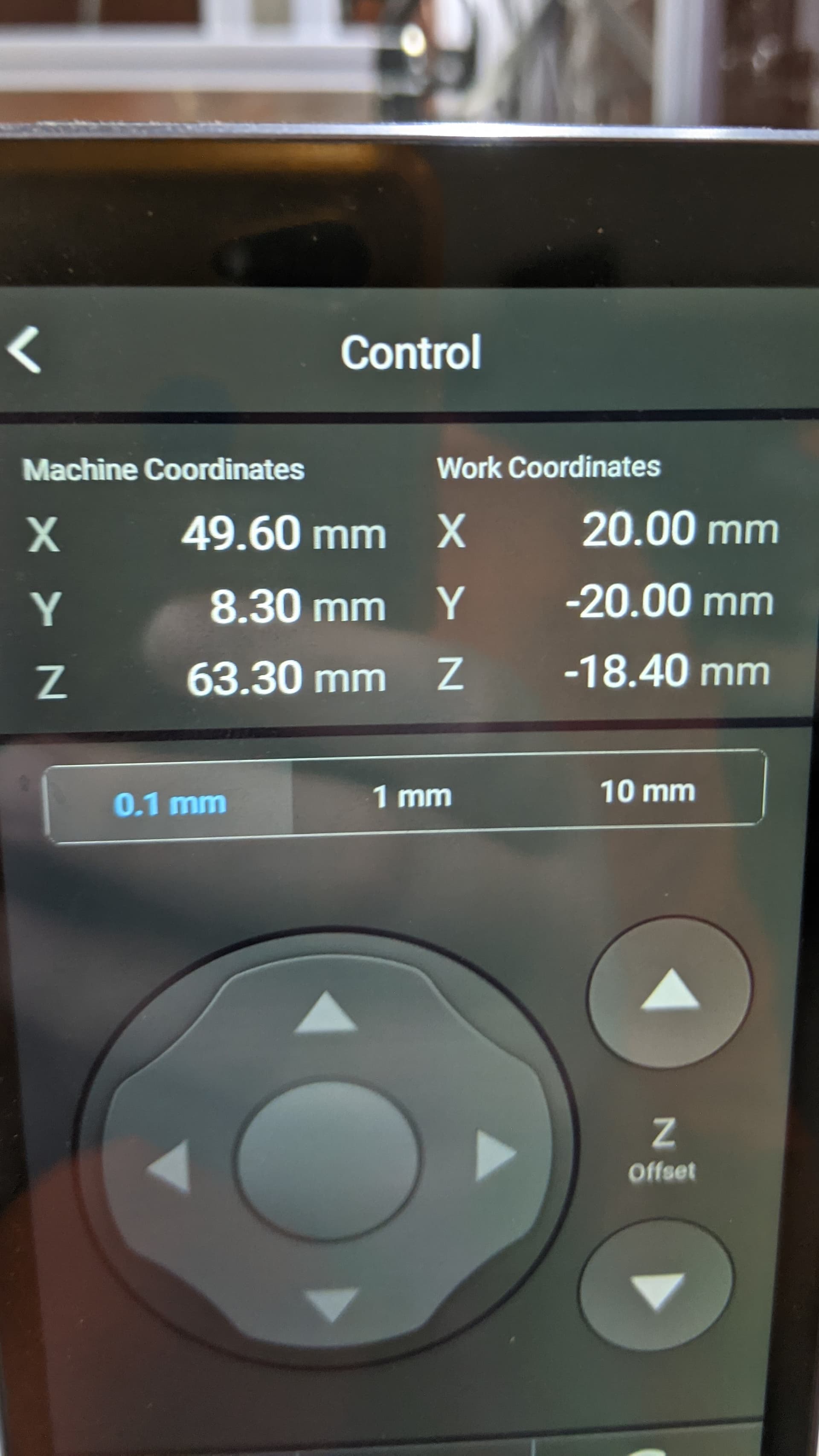

1: Take a picture of the control screen, unless you remove the rails, or change the machine to another function, this origin should remain the same and can be moved back to.
1a: This takes care of the eyeballing it on an “X” in the center of the material, and also allows you to utilize your material more effectively by knowing exactly where your bit will be.
2: If you’re doing multiples of the same project, this gives you a lineup and re-setup for finishing passes.
