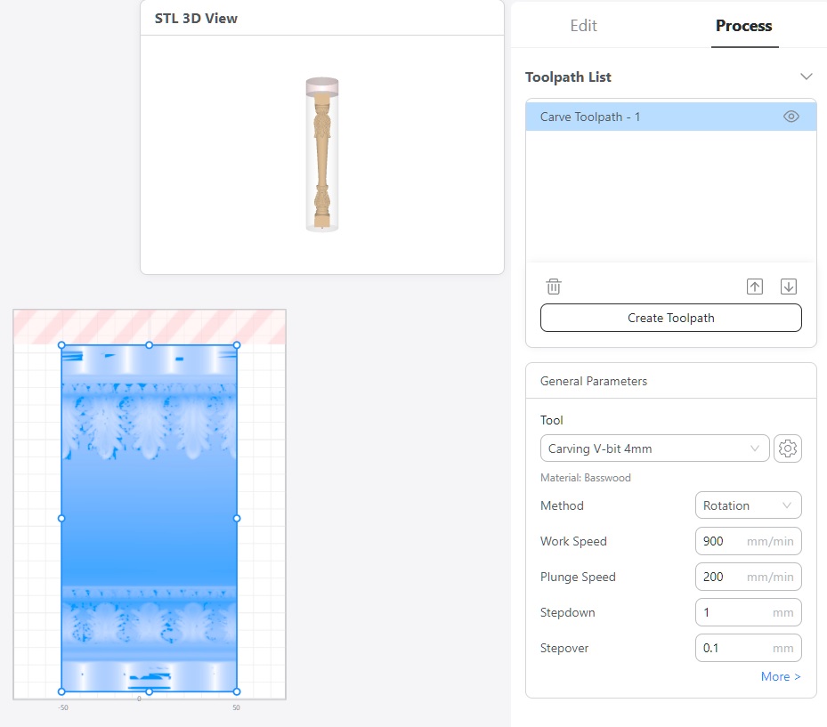

Hi all!
Today I started to create a model I want to carve out of wood, which I need 24 parts from.
The model had originally 1.2 million faces so I reduced it to around 64,000 faces and corrected the reversed faces the auhtor used to create “2 colors”. Then I exported it from Sketchup to STL and imported the result into Luban. Everything OK until here.
It tells me of course about some errors in the model which doesn’t surprise me as I could not fix each and everthing.
Nevertheless it created a nice depthmap image and also a correct 3D preview as you can see here:
[https://www.ccedv.de/download/photos/cnc/Column8472.jpg](https://www.ccedv.de/download/photos/cnc/Column8472.jpg)
Looks similar to the demo Lion from the Luban example for me.

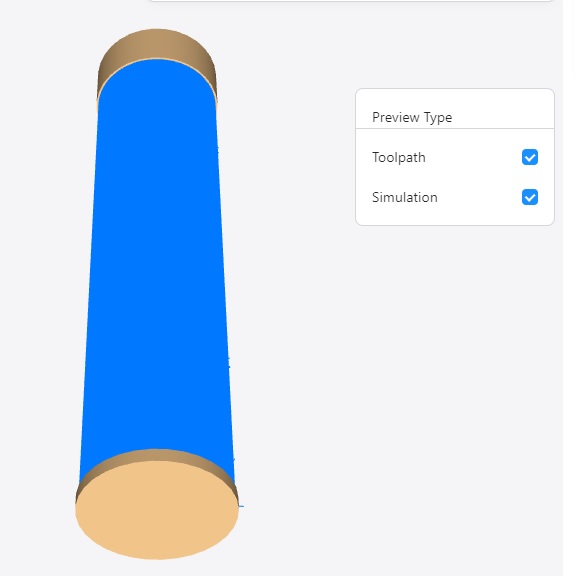

Now when I click preview and choose the V-carving tool I get this as result:
[https://www.ccedv.de/download/photos/cnc/Column8472\_Preview.jpg](https://www.ccedv.de/download/photos/cnc/Column8472_Preview.jpg)
And the estimated time is 355h?? The lion takes around 2h…
What am I missing here? Why is there only a big blue column and why does it take that long time? I mean, on my lathe I can create a straight column in 5 minutes… 😃
Cheers,
Christian

Un-tick the Toolpath or simulation boxes.

Thanks, that helps to now get the 3D model displayed (sometimes it can be so easy…).
The other problem still remains - 355h, that can’t be a realistic value vor a 20cm. column.

Depending on your material you could dig deeper than a 1mm step down.
The V-Carving bit has a step over of 0.1mm this causes the high carving time.
Do you need this high detail of 0.1mm stepover?
Maybe a other carving bit would also work?

Thanks for your answer!
Oh,I should really have tested to change these values before asking 😬
I just used the default values and thought, before I do anything wrong, let them be as they are… now, after increasing the stepover now I know of course why I got a “blue solid column”… 🙂
To answer your question: No, this is a miniature column which should be a nice feature for a bird feeding house. So I don’t need to have so many details.
The material will be yaw wood, I think, so should be easy to carve.
I changed the values to stepdown of 3mm and Stepover 1mm. With that the time is now 4h27m, which is still a bit slow. When I change it to SD4 and SO1.5 the result in the simulation still looks OK and the time is 2h28m.
But I have not done any CNC carving before, I know when I use my standard mill (which of course has at least 6 or more mm width) I usually use not more than 2mm stepdown for each step. Of course it removes a lot more material in one step.
This one here is extremely small (the original V carving bit which was delivered together with the rotary module) so maybe going deeper in one step would be OK?
The question is, which SD/SO values could be used as maximum for the bit? Simulation looks OK, but with a needle drilling into the material - will it not result in some carved discs instead of a model?
By the way, this is also the original milling module, not the 50W model.
I want to avoid that the first try just breaks the bit… 🙂

The “problem” is that Luban does not really support multiple toolpaths, i.e. you cannot easily do a roughing pass with a larger bit to get away a lot of material quickly and then a second pass with the tiny V-carve bit to work out the details. The lion you refer to earlier is supposed to be milled into the epoxy material, and there the V-carve bit is able to eat away the soft material in one go, which makes the lion relatively fast. In wood, I’d doubt that the V-carve bit will be able to do that.
There is a [guide](https://forum.snapmaker.com/t/multi-pass-rotary-guide/22121) by @Skreelink that coaxes a multi-path approach from Luban, but you need to do a few tricks. One problem is that Luban does not know rest machining, i.e. it does not remember what was already milled away in an earlier step.
Snapmaker themselves confirmed some limitations of Luban, i.e. not taking the milling bit dimensions fully info account (see [this thread](https://forum.snapmaker.com/t/luban-4th-axis-milling-is-cool-and-dumb-and-dangerous/32683)).
Long story short: The rotary module can do a lot (it will be slow, after all it is only 50W), but the software limits you. Unfortunately good 4-axis-CAM software is prohibitively expensive for hobbyists - DeskProto has a hobbyist’s license that is affordable, but has its own limitations, and with Fusion360 free edition, there at least seems to be a way to do indexed machining (never tried myself). If anyone has a good recommendation for affordable 4-axis CAM please let us know!
