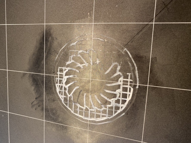

I have the problem getting of the prints for my A350, really hard to get them of and after getting of i had sticky filament at the printing bed.
I‘m using the standard printing sets from luban (70C first layer, 50C printing), before using i cleaned it always with isopropanol.
 ![image](https://us1.discourse-cdn.com/flex022/uploads/snapmaker/original/2X/4/49218aed1c185b33f69800e516ffa1665b8dc70d.jpeg)
Any tips?
**Post date:** [February 4, 2020, 6:22pm UTC](https://forum.snapmaker.com/t/cleaning-bed-tricks/5129/4 "2020-02-04T18:22:14Z")
hey @Raptor, i use a painters spatula with bent/straightened edges (i don´t know if this translation is understandable,- the profile looks a tiny little bit like a U)
for preparing the next print i take brake cleaner for the bed.
**Author:** ![Raptor](https://avatars.discourse-cdn.com/v4/letter/r/c37758/32.png) [@Raptor](https://forum.snapmaker.com/u/Raptor)\
**Post date:** [February 5, 2020, 9:16am UTC](https://forum.snapmaker.com/t/cleaning-bed-tricks/5129/5 "2020-02-05T09:16:38Z")
Ok i‘ll have a look.
I don‘t want to damage the bed… most people have problems with the bed (other printers) because the print don’t stick at the first layer.
A friend of mine using an ultrabed in have absolutely no problems. I thought about modifying my A350 and use an ultrabed too, but the problem is the autoleveling and using a induction sensor for it. The sensor wouldn’t detect the glas bed.
