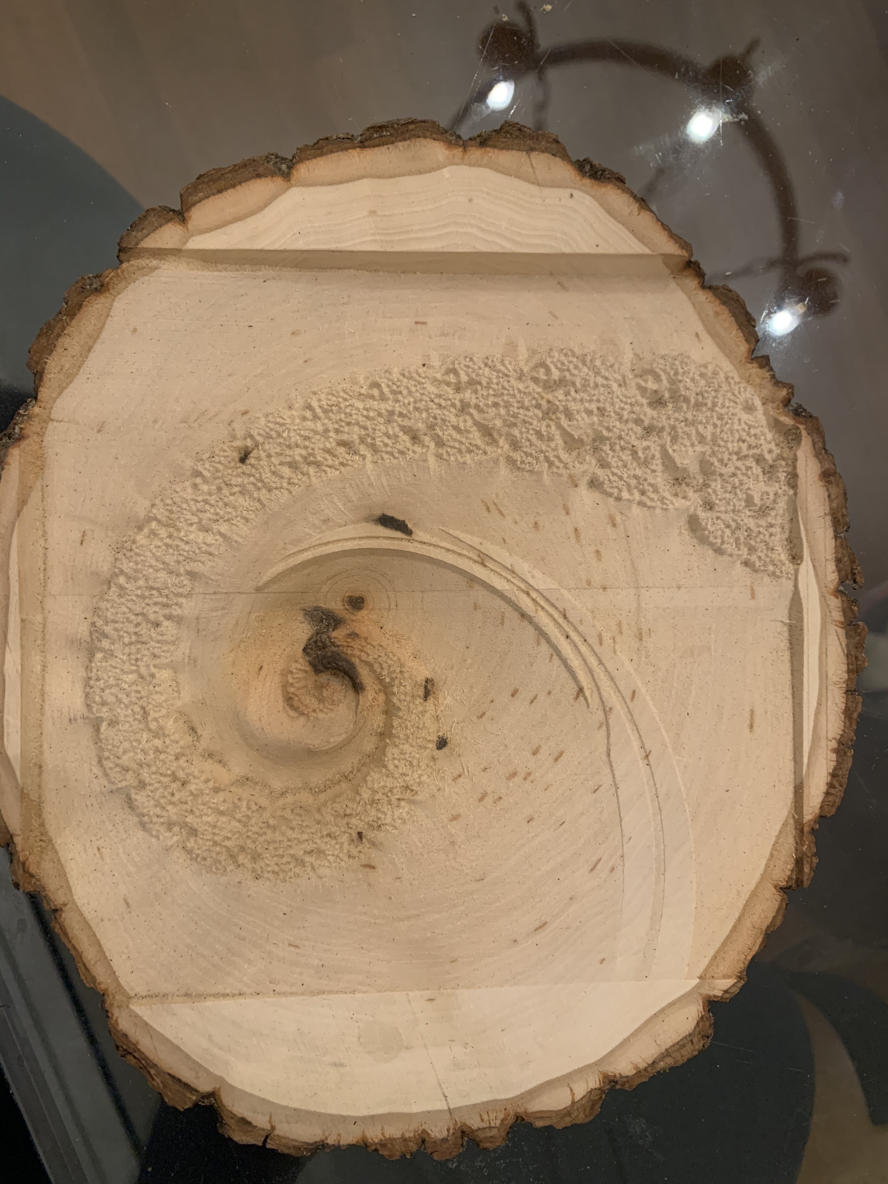

> [@StumbleRunner](#):
> the pine was the test wood
Pine is such a beautiful wood, easy to work, finishes nicely, and makes great furniture. I make a lot of stuff out of pine, possibly because I can just cut it down off my property for free 🤣
Well I know this doesn’t necessarily predict the future, but just analyzing this gcode file, here’s every unique set of commands issued (after I ran the regex I posted):
```auto
G0
G0 X
G0 X Y
G0 X Y Z
G0 Y
G1 X
G1 X F
G1 X Y
G1 X Y F
G1 Y
G1 Y F
G1 Z
G1 Z F
G21
G90
M02
M03 S
M05
S10000
I previously missed the S10000 on line 24, that needs to be changed to a M03 S command, and M02 at the very end isn’t valid in Marlin flavor as well.
Otherwise, it looks valid.

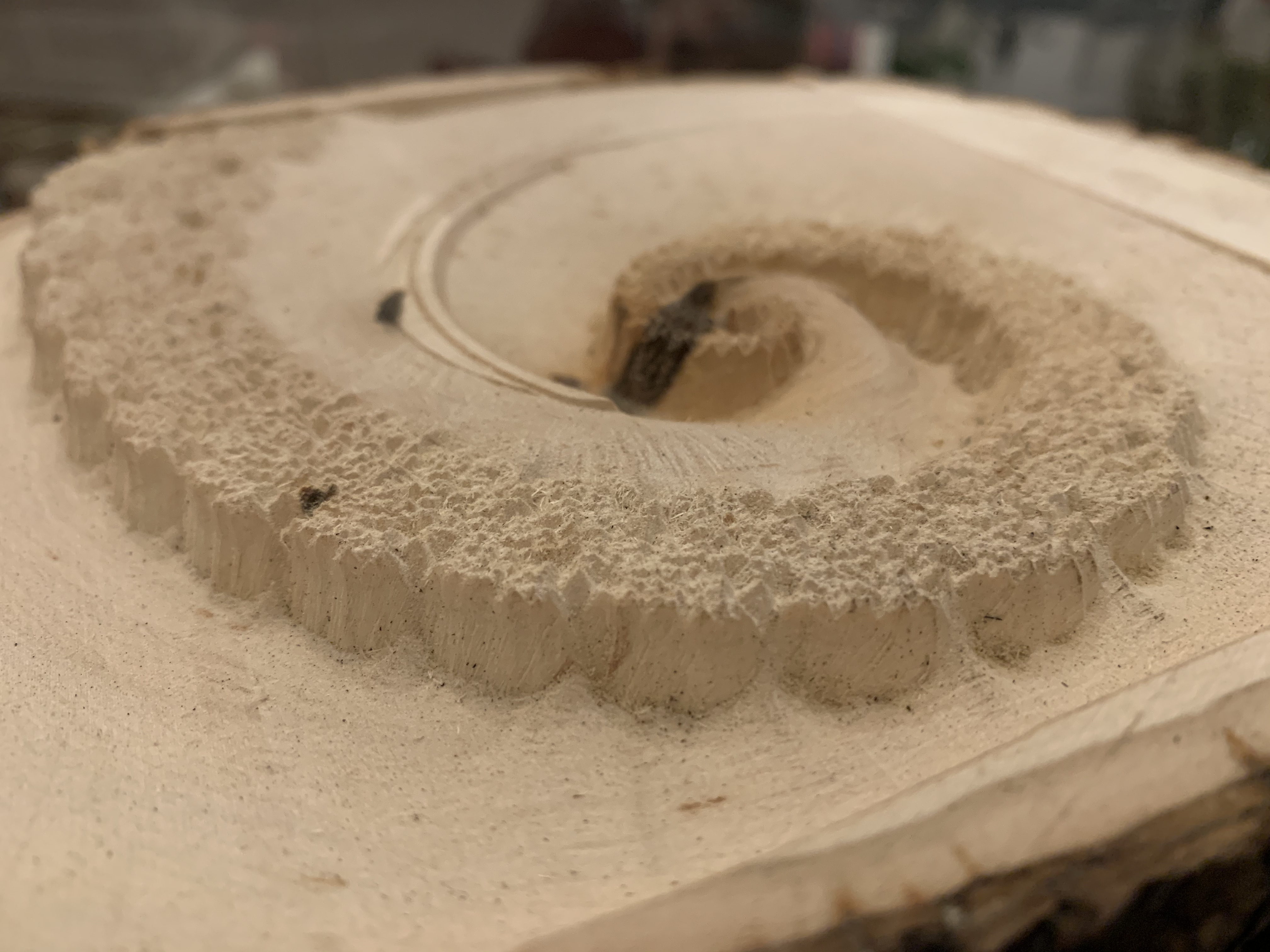

So, I did regex and replaced all the X,Y,Z’s with G1X,Y,Z’s and that seemed to work. And when I ran g-code through my SN2 (after watching it run the path +30 Z), I got this which isn’t great but that’s my fault for playing around with different tool paths. Now to go back fine-tune things and I still have 6 more test boards to play with 🙂
 ![20201001_205333#1](https://us1.discourse-cdn.com/flex022/uploads/snapmaker/original/2X/3/3f3e5ee2dc06d422bf35367f1f55eb958745c07f.jpeg)
**Post date:** [October 2, 2020, 5:33am UTC](https://forum.snapmaker.com/t/carbide-create-and-snapmaker2/9931/30 "2020-10-02T05:33:53Z")
Thanks for posting the update! Looks a lot better.
