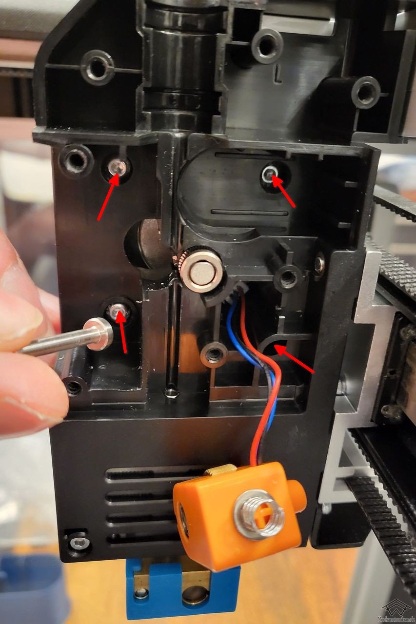

The left tool head barely loads filament then stops
I tried to inspect it, but the compartment cannot open anymore
any help appreciated

Hi, you have seven black screws in the picture which hold small cover for filament sensor (orange pin is visible) Remove (carefully!!!) all seven screws. Here is the picture of extruder with removed cover: https://www.mechanotronikum.de/wp-content/uploads/2023/10/Extruder-ausbauen-1_1280.jpg (Credit: @Mechanikus, Source: https://www.mechanotronikum.de/39154-snapmaker-j1-auf-eine-duet-umbauen-teil-2.html)
thanks a lot for your help !

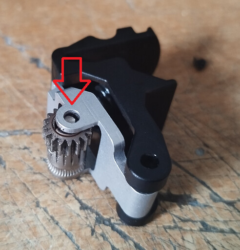

Found the root cause!
