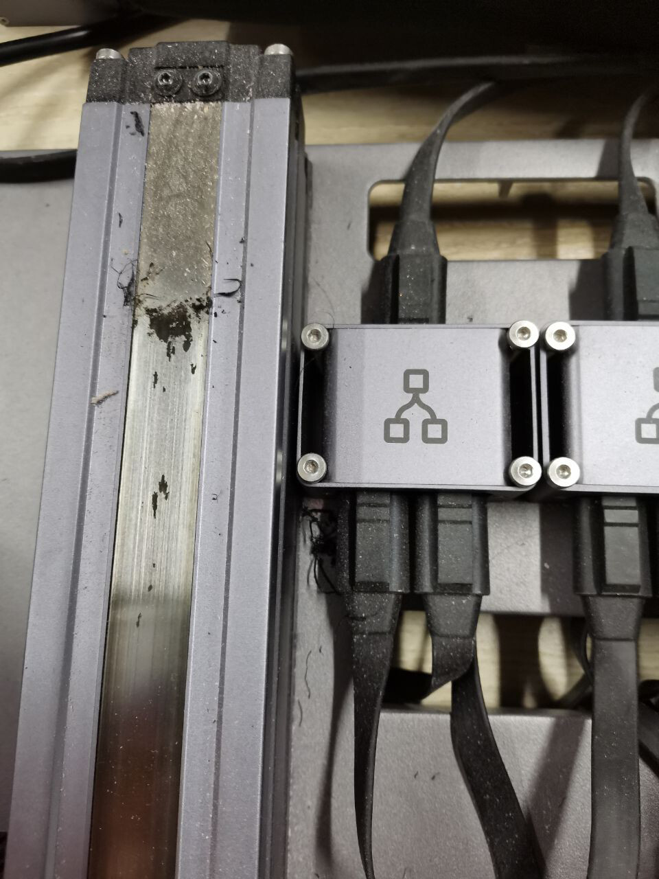

I have read a lot about switching out axis modules etc. with this issue. Since I had this Y axis clunking myself and being and old machinist/engineer I discovered the problem is debris under the steel bands that cover the lead screws.
I cleaned the surface under the bands and cured the issue. The debris in my case came from surfacing the router table creating a large amount of dust.
When the axis travels it lifts the bands an rides on the extrusion. The debris cause the axis to bind thus causing the misalignment between the 2 slides.
I used compress air to blow the debris out of the covers. All is good now, I never would have found this if I had not run my finger down the band And felt the lump in the band.

Could you please share some photos of the debris so that I can forward them to our mechanical engineers and ask them to look into this issue?

The debris came from surfacing the milling table (sawdust essentially).
It created some fine particles and I never saw them but the dust was all over the machine.
I must have gotten under the foil and between the slide.
My suggestion is to develop bellows to cover the slides.

The tightness of the steel strip can greatly affect the dust-proof performance of the linear module. We have conducted many dust-resistant tests with different degrees of tightness of the steel strips. And we found the optimal tightness to achieve the best dust-proof performance. We have also conducted this test on more materials (POM and Beech Wood) to ensure that steel strip can protect the main parts from dust and dirt in most scenarios.
As for the metallic debris, you can remove it with rags. And the debris will not fall into the linear modules.
