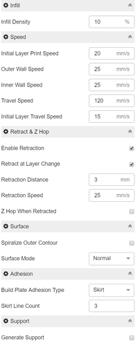

I just started with my 350A and searched for some PETG info in the forum. I just thought I share my printer settings with you. I used the red PETG filament SnapMaker offered and used the standard nozzle woth following settings:
 ![image](https://us1.discourse-cdn.com/flex022/uploads/snapmaker/original/2X/d/d6227b6834749c57dcb8f2c95e5fca1e929e53ab.png)
 ![image](https://us1.discourse-cdn.com/flex022/uploads/snapmaker/original/2X/f/f59450d114e0cdaba1149d59d6601956da57c9b6.png)
 ![image](https://us1.discourse-cdn.com/flex022/uploads/snapmaker/original/2X/e/e5f3cf501d88c11dd5c64fdd93c565d6a7f2ffba.png)
Had a small problem with the layer adhesion. The part lifted of at one point but still is functional.
Still needs some improvement but I think its close.
I hope this helps you out.

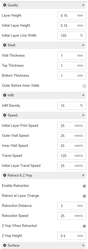

Please…
**Calibrate your extruder (E-steps) with the new filament.**
My PETG prints best at about 225°C.
With 0,20 mm layer heigth you can print at max. 50-60 mm/s.
The standard nozzles are just fine to print this material. But you will notice that you have to change the hotend more often than with PLA because of the higher temperatures ans the different material. The nozzle is not the problem but the PTFE tube inside the metal inlet tube. The tube cloggs up the hotend from time to time.

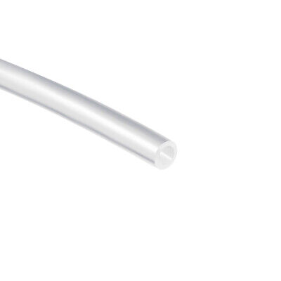

I bought a roll of 3/2 mm PTFE tube (OD/ID) to save money (by saving the metal parts of the hotend and just replace the tube).
For me a Z-hop with retraction helped a lot with the stringing problem.
I just check and remove possible build-up on the first and second layer.

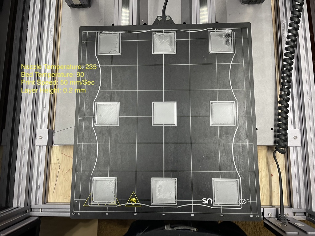

Hello friends! Sorry for the wordy post but there was a lot that went into me researching this issue. For me, it seems I found a solution, at least for this filament…
I had to walk away from this issue for a while because it was driving me nuts. Recently I began researching it again. With the help from several articles on [all3dp.com](http://all3dp.com), countless YouTube videos, and a very useful Thingiverse tool, I seem to have solved this particular issue (as well as troublesome first layer issues). My research revealed that there are many factors that affect the first-layer adheasion including nozzle temp, bed temp, cooling fans, and print speed. Also, materials from different manufacturers (and even different batches from the same manufacturer) may require different settings. For this issue, I was focusing on PETG and I’m using Cura as a slicer.
This article on all3dp was particularly useful. [The Perfect PETG Print Settings | All3DP](https://all3dp.com/2/petg-print-settings-how-to-find-the-best-settings-for-petg/). It gave me some starting parameters to which I applied manufacturer suggestions to and I set out to solve this issue. For this particular filament, the manufacturer suggested printing temps between 230 and 250 and bed temps between 80 and 90. Note: Cura automatically adjusts the first layer print speeds to 50% of the set speed. All of these were actually printed at 25 mm/sec even though the overall setting was for 50 mm/sec.
Using this bed level test from Thingiverse ([Bed Leveling Calibration Test Object (Parametric) by pgreenland - Thingiverse](https://www.thingiverse.com/thing:34558)) I got started. The following images show the result of each test with the printing parameters shown in the photo. Cooling fans were off for all of these tests and the SM printing surface was coated with a thin layer of Elmers “Disappearing Purple” glue stick.
 ![91EFB638-08BF-4FFD-AC40-F71A73C0BE5C_1_102_a](https://us1.discourse-cdn.com/flex022/uploads/snapmaker/original/2X/8/82fbcbb2ce73611dbd84071d6b05da6c9bcf5e67.jpeg)
 ![1F1E5543-053D-4D56-B6CB-5A1B2481F514_1_105_c](https://us1.discourse-cdn.com/flex022/uploads/snapmaker/original/2X/8/82dcd1ecfcc9b2edb0454ba0fdd82f64010fc865.jpeg)
 ![2B6FBEAF-EA8F-4B3B-B9F2-DD75CA5DFA9F_1_105_c](https://us1.discourse-cdn.com/flex022/uploads/snapmaker/original/2X/a/ae8d15c023485e97601319747945e28e5cba2e22.jpeg)
 ![5E9CC2FC-36C3-46C9-AC47-F64AC93819A9_1_105_c](https://us1.discourse-cdn.com/flex022/uploads/snapmaker/original/2X/c/c1cfaef8aa103da66cccdfce5db277bbe311669e.jpeg)
These tests showed me several things. First, small changes in bed temperature can make a big difference in layer adhesion. I changed these in 5-degree increments but could probably get more precise. Second, my printing surface and/or heated bed and/or bed frame on this machine is not flat. Or, the printer controller is not doing a very good job of adjusting to the inconsistencies in bed level. After performing these tests I noticed that the nozzle had actually damaged the print surface in the area shown in the upper-right of the photos.
Taking what I learned here I started a new print. A simple enclosure I’m working on that is 61mm-sq. It worked. For the first time, I got a nearly flawless first layer. And… through the almost 3-hour print, I had little to no buildup of material on the nozzle.
 ![D038721E-59EF-43F7-80AB-ED167D16DC81_1_105_c](https://us1.discourse-cdn.com/flex022/uploads/snapmaker/original/2X/c/c2c1147d9cfbd76ff5a4aceac11c15fce204c357.jpeg)
This was all done with the SM hot end and nozzle with one modification. I used a syringe with a blunt needle on it to inject thermal compound into the hole the temperature sensor for the hot end is seated into. I did this based on another thread I saw on these forums to ensure accurate thermal readings. I don’t know if it made a difference or not, all I know is that the combination of these settings seems to have resolved this particular issue.
Also, I did complete the extruder calibration as suggested earlier in this thread. Using the 100mm test mine was off by about 14mm and was under extruding. This is the process I followed: [Extruder Calibration a must - #33 by Termin8tor](https://forum.snapmaker.com/t/extruder-calibration-a-must/7724/33)
Thank you all for the input here!

Very interesting and thanks for the write up. I agree my bed is far from level and I have measured 15c difference between the middle of the bed near the corners.
One question, did you do a bed calibration between the tests as shown or did the all come from the same bed calibration and the same nozzle Z offset?
**Author:** ![JWAZ73](https://sea2.discourse-cdn.com/flex022/user_avatar/forum.snapmaker.com/jwaz73/32/7627_2.png) [@JWAZ73](https://forum.snapmaker.com/u/JWAZ73)\
**Post date:** [May 11, 2021, 4:43pm UTC](https://forum.snapmaker.com/t/build-up-on-the-nozzle-when-printing-with-petg/11598/18 "2021-05-11T16:43:24Z")
I did the 25 point bed calibration only once before I started the test prints. When doing the final adjustment to the nozzle height I adjusted it so there was just noticeable friction, not all the way to where the card would bend when pushing towards the nozzle. Throughout the test prints I did not repeat the bed calibration nor did I adjust the Z height any.

I’m having trouble finding PTFE tube in those dimensions. Would you mind sharing where you got it?
Also, I noticed that the stock MK8 nozzle also has this PTFE tube going into it from the heatbreak/throat (metal inlet tube) - it has a wider ID than MK8 nozzles I can find. Do you know where MK8 nozzles of that type can be found?
I feel like those might work better since the filament gets heated at the tip. Just a guess really and wanted to experiment.
**Author:** ![ElloryJaye](https://sea2.discourse-cdn.com/flex022/user_avatar/forum.snapmaker.com/elloryjaye/32/13979_2.png) [@ElloryJaye](https://forum.snapmaker.com/u/ElloryJaye)\
**Post date:** [September 15, 2021, 5:30pm UTC](https://forum.snapmaker.com/t/build-up-on-the-nozzle-when-printing-with-petg/11598/20 "2021-09-15T17:30:49Z")
> [@cafuentes](#):
Seems widely available:
[https://www.amazon.com/uxcell-Tubing-Printer-RepRap-16-4ft/dp/B07F64KQR1](https://www.amazon.com/uxcell-Tubing-Printer-RepRap-16-4ft/dp/B07F64KQR1)
> **[2mm ID 3mm OD PTFE Tubing Tube Pipe 2 Meter 6.56ft Length | eBay](https://www.ebay.com/itm/233173306012?hash=item364a364a9c:g:V-QAAOSwgwNhQC5h)**
> PTFE Tube Tubing Lengh Pipe White.
> **[PTFE tube 2mm x 3mm √ Shipped within 24 uur](https://ptfetubeshop.com/en/product/ptfe-tube-2mm-x-3mm/)**
> 2 x 3mm PTFE tubing ( id x od ) ǀ LOWEST PRICES ǀ Full rolls or Cut-to-Size pieces ǀ Order one of the 400+ diameters directly online:
