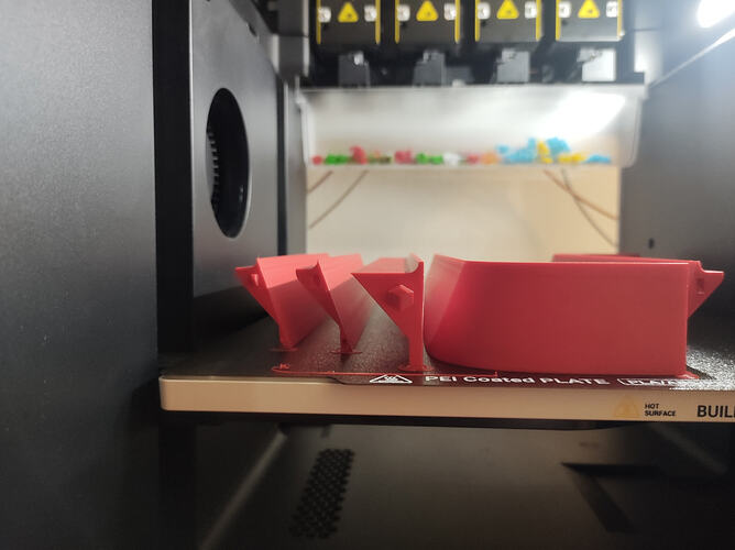

For me PETG prints stuck really well! I only experience over bonding when printing brims (as the brim itself is impossible to remove at times for me) so when I worry about having too little adhesion (rarely happens), I use mouse ears.
 ![EnclosurePETG](https://us1.discourse-cdn.com/flex022/uploads/snapmaker/original/3X/e/3/e39e1300a0c52eb5056234f01ee41941a67094c8.jpeg)
