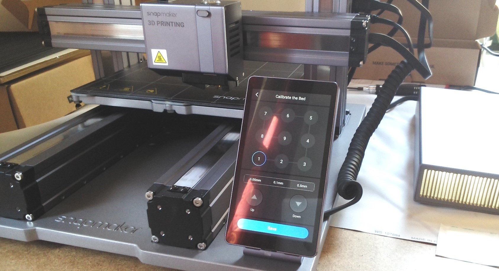

Hello , I finished the erection of the machine. But the process is not working right. Insted going up and down the y-table moves.
How can help me
You probably mixed up the cables for y-axis and z-axis. Please check your wiring and retry.
Ok thank you that was the reason. Very great service
