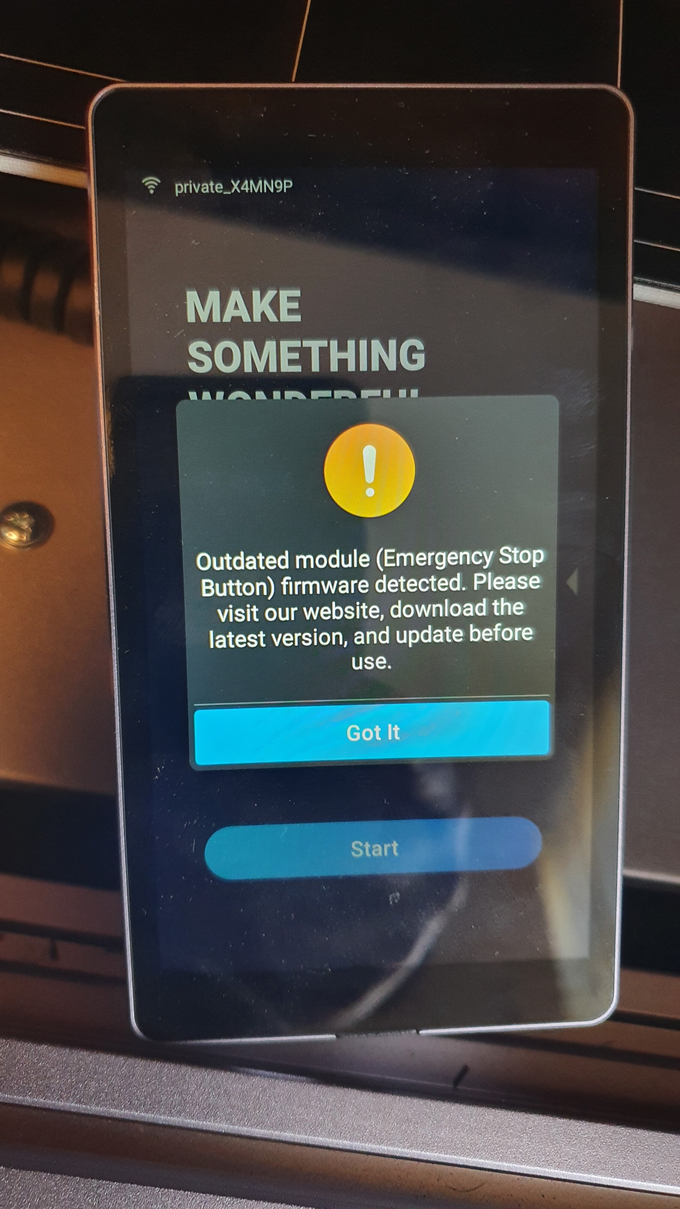

Got the rotary module + emergency stop button today. Hooked up the stop button right away as that always comes in useful and safe. Printer software version was 1.12 before starting it up, so latest version.
But it tells me now: “Outdated module (Emergency Stop Button) firmware detected. Please visit our website, download the latest version, and update before use”.
Does that mean I have to go back to the future? 😄

**Author:** ![jt55401](https://avatars.discourse-cdn.com/v4/letter/j/a587f6/32.png) [@jt55401](https://forum.snapmaker.com/u/jt55401)\
**Post date:** [April 14, 2021, 6:21pm UTC](https://forum.snapmaker.com/t/ask-me-about-rotary-module-here/16500/184 "2021-04-14T18:21:59Z")
Same for me today. “outdated module”
**Post date:** [April 14, 2021, 7:38pm UTC](https://forum.snapmaker.com/t/ask-me-about-rotary-module-here/16500/185 "2021-04-14T19:38:51Z")
Sounds like you need to update the module firmware, which sounds like you haven’t done. If you haven’t uploaded firmware with the module attached you need to - it doesn’t just update from the touchscreen like you would think it should. You have to manually start a firmware upload with each module attached in turn when you update to new firmware that changes module firmware.
**Author:** ![bastiaanslee](https://sea2.discourse-cdn.com/flex022/user_avatar/forum.snapmaker.com/bastiaanslee/32/9740_2.png) [@bastiaanslee](https://forum.snapmaker.com/u/bastiaanslee)\
**Post date:** [April 14, 2021, 9:43pm UTC](https://forum.snapmaker.com/t/ask-me-about-rotary-module-here/16500/186 "2021-04-14T21:43:59Z")
That’s not what the manual says (that says you FIRST have to install the v1.12 firmware before connecting the new modules), but it works and that is what counts 🙂
For who needs to do this as well, these are the steps:
> [download latest firmware](https://snapmaker.com/product/snapmaker-2/downloads) (at the bottom of the page) to a USB flash drive
> Insert the USB flash drive into your Snapmaker (in the controller, last plug at the bottom)
> Turn on the machine
> Swipe left on the Touchscreen \> Tap Files \> Tap USB \> Tap the firmware file to update.
While it is loading the firmware update, it will show there are updates loaded for modules. And that is what you need!
**Post date:** [April 14, 2021, 9:47pm UTC](https://forum.snapmaker.com/t/ask-me-about-rotary-module-here/16500/187 "2021-04-14T21:47:59Z")
> [@bastiaanslee](#):
Agreed, unfortunately. There was a post on the forum about it though that I remembered:
> [@Upgrade the Toolheads Separately with Snapmaker Firmware V1.12.0](https://forum.snapmaker.com/t/upgrade-the-toolheads-separately-with-snapmaker-firmware-v1-12-0/17402):
> To use the Emergency Stop Button and the Rotary Module, you need to upgrade all modules to [Snapmaker Firmware V1.12.0](https://s3-us-west-2.amazonaws.com/snapmaker.com/download/firmware/Snapmaker2_V1.12.0.bin), the tool-heads included. With this version of Snapmaker firmware, the Touchscreen will ask you to upgrade three tool-heads with the USB flash drive. You will see the Touchscreen notification “Outdated firmware (Modules) detected. Please visit our website, download the latest version, and update before use.” Notice If you have used all tool-heads (3D printing module, laser eng…
