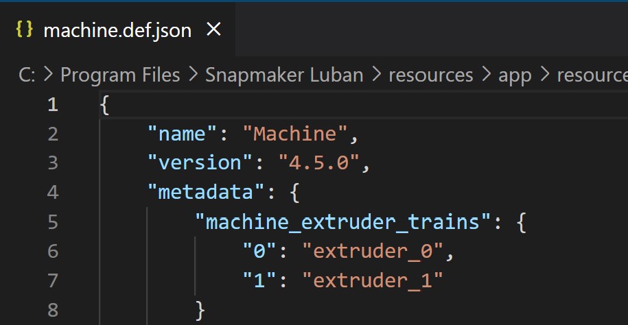

I can’t find it directly in Luban.
Luban is based on Cura. I don’t know if it’s possible to swap the 2 extruders in the settings file “machine.def.json”
left becomes right and right becomes left ???
Too dangerous to test directly. We need an expert…
 ![extrud](https://us1.discourse-cdn.com/flex022/uploads/snapmaker/original/3X/d/a/dad15524237e5f5d89d4cc1d5c8a48457ff56b3e.jpeg)
