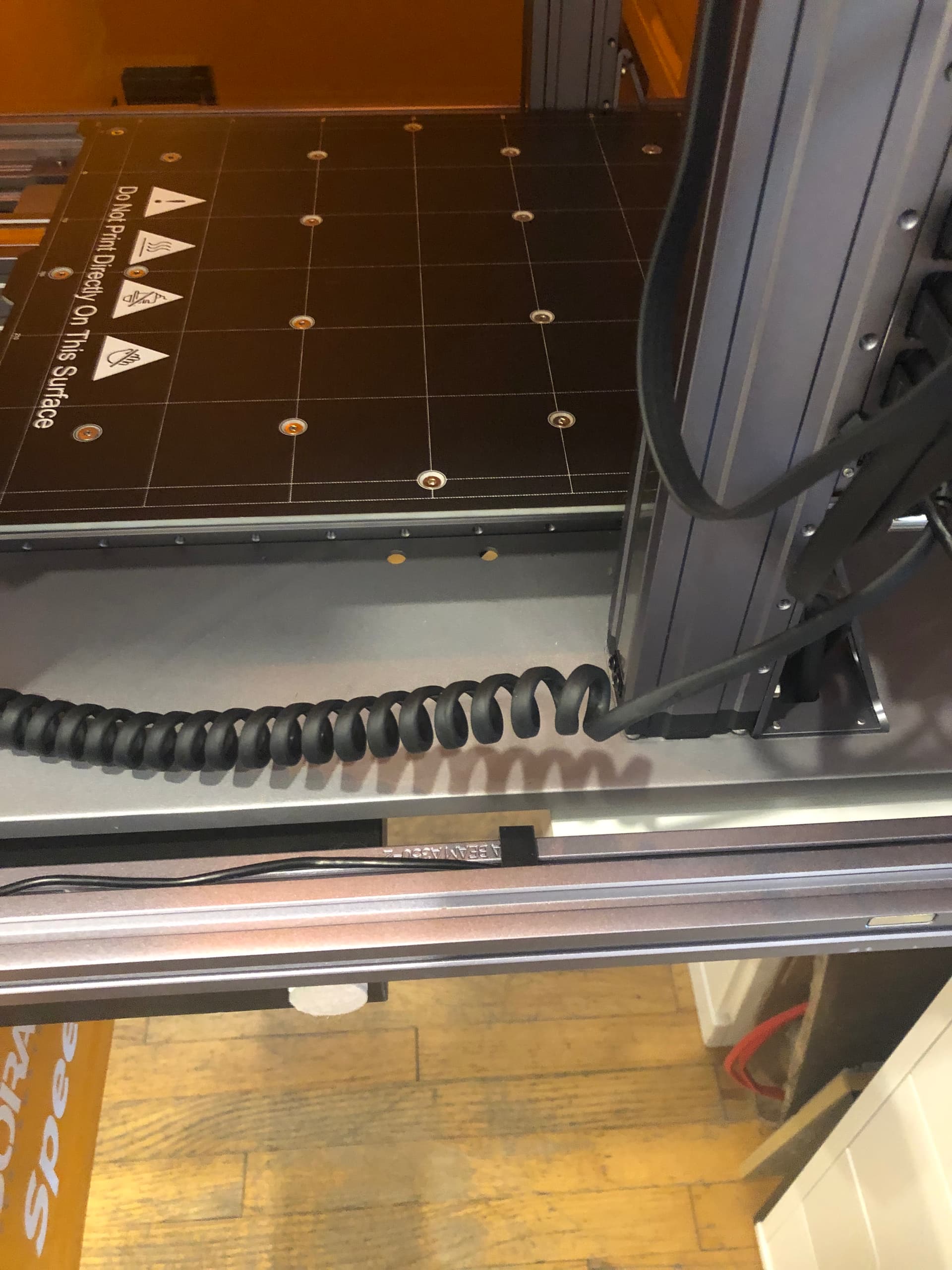

I wasn’t feeling like taking my SM 2.0 and the enclosure apart for the install of the quick swap kit as you need to access some screws through the bottom of the SM 2.0 (thank god there are access holes in the bottom plate…).
I used saw horses and a second desk plate to move the SM 2.0 partially onto and than created a gap underneath to access the screws… Work smart, not hard…

**Post date:** [October 30, 2023, 4:55pm UTC](https://forum.snapmaker.com/t/alternative-way-to-install-quick-swap-kit-if-you-have-an-enclosure-and-dont-want-to-take-everything-apart/33415/2 "2023-10-30T16:55:55Z")
With my A350, I can lift the printer out of the enclosure without dismantling it or the enclosure. I do not even dismount the brackets that fixate the A350 at the bottom. If you tilt the printer, you can wiggle it through the larger door. Did so when I installed my QSK.
