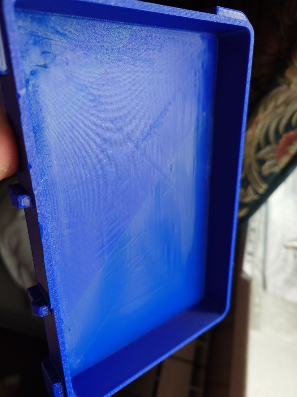

On the 17th attempt, I got the first satisfactory result. There were 3 errors of “finishing the filament”, just in case, I had to completely unload and load it again. Now it remains to figure out the settings of the slicer, which “increases” the gap from the table to the part by 0.2 mm, despite the value of the “vertical gap” of the connecting layer of PLA support from above and below = 0. At the temperature of the table, there is also a separation of the corners of the part from the surface of the table by 0.5-0.8 mm, which makes the coupling of the parts uneven. I ordered 8 more coils of filament :-))) I’ll make it print correctly… Nopassaran!
I also fixed remote access to the printer via the cloud, completely deleting all settings and re-linking the printer to the cloud + re-linked the printer in the slicer via a PIN code.

I am currently printing a “huge box” (250х250) with a 90mm square in the center, 1.4mm high.. which is also produced by “extrusion” using PLA support. It turned out very badly at standard speeds.. I reduced all speeds by 100mm/sec again, and he has already printed more than 100 layers (out of 256) just amazing! I think on a large support area, especially when it is high from the table (more than 25-30mm), the plastic cools down and the adhesion between PLA and PETG completely disappears, which is why the main filament simply twists “into a tube” 🙂
UPD: Done. However, the key to success is to reduce the speed of printing. The “overlap” area was slightly less than the part I had printed 17 times. I will finish printing the second half of the box and run the problematic part again with the same printing parameters. I also slightly raised the average temperature of the table from 70 to 75 degrees. I don’t know how this affected the adhesion of PETG to PLA. But printing on top of the cooled PLA (smoothing the binding surface of the support lasted more than an hour) was successful.

**Post date:** [June 16, 2026, 6:25pm UTC](https://forum.snapmaker.com/t/ai-assistants-and-sensors-are-not-working/42209/16 "2026-06-16T18:25:53Z")
Is your support distance set to zero?
I think it could help to print the interface from or to support with slower speeds so it has more time to bend together.

Yes, both gaps (top and bottom) from the binding layer of the support to the detail are 0. With the standard 0.20, nothing could be printed on top of the PLA even once.
The second half of the box with multiple PLA surfaces was printed amazingly. Only the walls remained. I can’t wait to repeat the experiment with my problematic part… So I checked the printing of 1,2 and 4 heads. I printed the problematic part with the 3rd head all the time. Maybe I have some kind of factory defect…

I have reprinted 2 complex boxes. The blue lid at the junction of the pad and the PLA support was poorly sealed, the plastic did not boil through. The joint was sealed with a bronze cylindrical sleeve using a soldering iron at 285 degrees. I’m out of green filament. I will try printing the problematic part again tomorrow. Overall, it looks like the problem has gone away.
 ![Без имени](https://us1.discourse-cdn.com/flex022/uploads/snapmaker/original/3X/d/d/dd2b0ab758291045373df80ac65ce2f4abb9fb29.jpeg)
 ![Без имени2](https://us1.discourse-cdn.com/flex022/uploads/snapmaker/original/3X/c/8/c8b3138eaacc9fca947c52f4d89b554fc32b9f0c.jpeg)
 ![Без имени3](https://us1.discourse-cdn.com/flex022/uploads/snapmaker/original/3X/2/2/2298798f2e974ec7b1a16b3109d1f34bfc161968.jpeg)
 ![Без имени4](https://us1.discourse-cdn.com/flex022/uploads/snapmaker/original/3X/c/c/cc5fc44a00007464b529a4c922546143d58144ae.jpeg)
 ![Без имени5](https://us1.discourse-cdn.com/flex022/uploads/snapmaker/original/3X/c/0/c0095250b6311775ef57c52ee8fbfdf550b73e11.jpeg)
 ![Без имени7](https://us1.discourse-cdn.com/flex022/uploads/snapmaker/original/3X/d/6/d6e96dd3a6e92cabc048e870d7fcb5e7e4d8db7b.jpeg)
 ![Без имени8](https://us1.discourse-cdn.com/flex022/uploads/snapmaker/original/3X/3/5/3519bf4221005325d72361a9d898f55e2c41b41f.jpeg)
