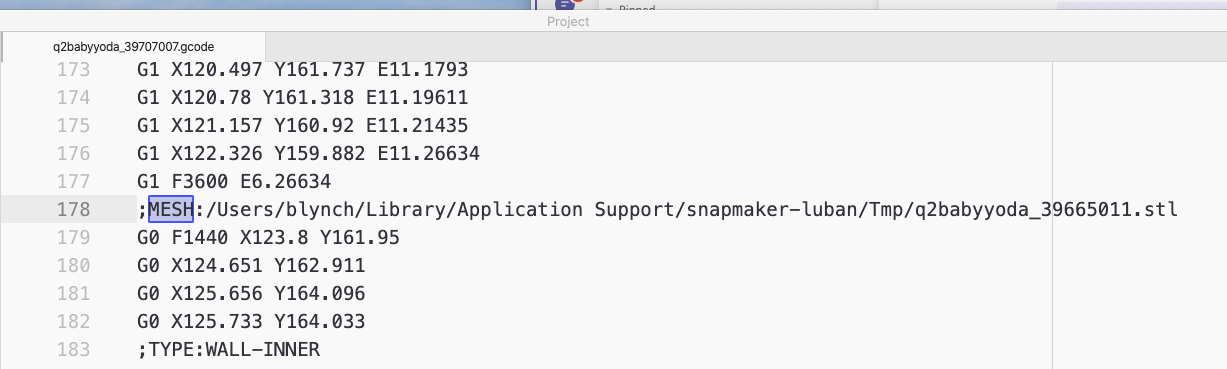

**Post date:** [March 8, 2021, 4:30pm UTC](https://forum.snapmaker.com/t/a350-printing-into-thin-air-no-filament-extruded/7760/74 "2021-03-08T16:30:02Z")
Hi - I would iike to resume my print - but I can’t seem to find the height value you point out in your post. See my Gcode below:
 ![CleanShot 2021-03-08 at 10.24.43](https://us1.discourse-cdn.com/flex022/uploads/snapmaker/original/2X/0/08eb67011be018734eff5bf497ce60863a3d650a.png)
I need to figure out where in my Gcode to restart the print. It was 18hrs in to a 27 print and I don’t want to lose the work. The printer started the dreaded printing in the air. The above example in the post shows a value of Z50.6 after the Y value and you will note I do not have a value after my Y value on that line.
**Author:** ![barryintx](https://avatars.discourse-cdn.com/v4/letter/b/c2a13f/32.png) [@barryintx](https://forum.snapmaker.com/u/barryintx)\
**Post date:** [March 8, 2021, 5:19pm UTC](https://forum.snapmaker.com/t/a350-printing-into-thin-air-no-filament-extruded/7760/75 "2021-03-08T17:19:03Z")
I clicked on Next in my Atom browser and discovered that there si a line with the Z value in it that I couldn’t find before. Am I correct in assuming that the Z value is the height?

**Post date:** [March 9, 2021, 9:08pm UTC](https://forum.snapmaker.com/t/a350-printing-into-thin-air-no-filament-extruded/7760/78 "2021-03-09T21:08:49Z")
Yes, the z-value is the current height of the nozzle.
