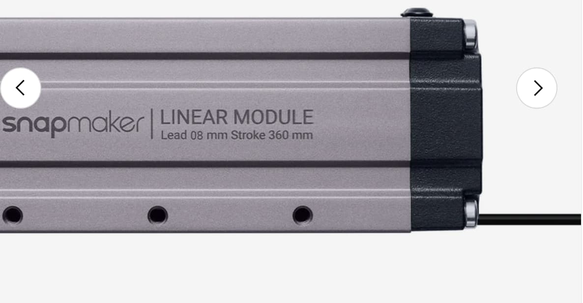

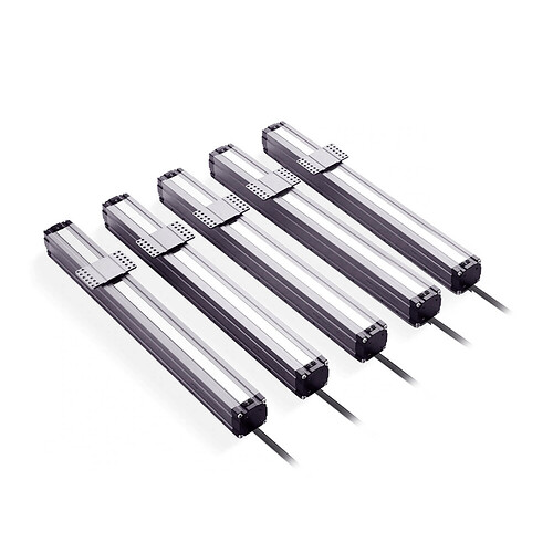

New linear modules are marked with lead:
 ![Screen Shot 2023-10-01 at 11.58.28 AM](https://us1.discourse-cdn.com/flex022/uploads/snapmaker/original/3X/0/9/094053947f966198e20e48c75b9af94aeaa36163.jpeg)
 ![Screen Shot 2023-10-01 at 11.58.17 AM](https://us1.discourse-cdn.com/flex022/uploads/snapmaker/original/3X/a/f/af41ec27ba7a3eea3f691cab0d847a4d97c61bc1.jpeg)
If yours are marked like this, you already have the silent ones.
If not, you have the older, noisier ones.
Have to upgrade all 5. Can’t mix and match old and new.
