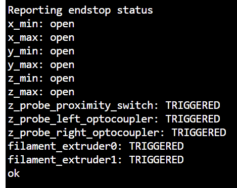

**Post date:** [November 4, 2025, 6:41pm UTC](https://forum.snapmaker.com/t/a350-40w-laser-self-pauses-immediately/40258/6 "2025-11-04T18:41:34Z")
You can’t disable the enclosure door protection with the 40W regularly and it seems to go into protection mode.
Check your enclosure door magnets or door state with M119 or M1010, honestly i am not sure if the door state is displayed with this commands..

**Author:** ![Bulp412](https://avatars.discourse-cdn.com/v4/letter/b/258eb7/32.png) [@Bulp412](https://forum.snapmaker.com/u/Bulp412)\
**Post date:** [November 4, 2025, 10:51pm UTC](https://forum.snapmaker.com/t/a350-40w-laser-self-pauses-immediately/40258/8 "2025-11-04T22:51:23Z")
![image](https://us1.discourse-cdn.com/flex022/uploads/snapmaker/original/3X/9/9/9935f13fdb6c553be88f41e1810f4d67a5ac8c55.png)
 ![image](https://us1.discourse-cdn.com/flex022/uploads/snapmaker/original/3X/3/8/38a9855051df7cfa8e7c695d14da7516750ab9c7.png)
 ![image](https://us1.discourse-cdn.com/flex022/uploads/snapmaker/original/3X/6/9/69ee17a481152b9ebd5a2113b7c1135d035a99a7.png)
