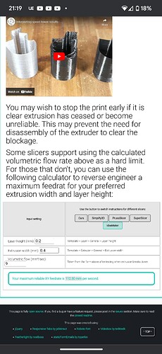

@Rwide 2mm this time
Can you please translate this?
So for example, if you’re printing with 0.2mm layers at 60mm/s you would do: 0.4x0.2x60 = 4.8mm 3/s. This is a speed that a properly functioning.
So my nozzle is 0.4, I want to print at 60 mm/s… now where to I check if the 4.8 is correct?
Normally from what I’ve read the snapmaker 2.0 single extruder has about 9mm3/s… Unless I’m mistaken…

Yea the cubic calculation looks right to me. But the slicer does that calculation for you so there is no need to bother with that unless you want to go much faster than you are…
If everything works like it should with your machine, 60 mm/s with a 0.4 nozzle shouldnt be a problem.

Not even dreaming of printing at what they say here :)))

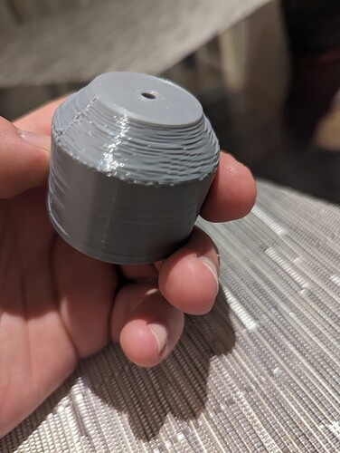

Started the print with no retraction… I guess you are right… it does look like a temporary clog… and then it sorts itself out
**Author:** ![Marius87bv](https://avatars.discourse-cdn.com/v4/letter/m/9dc877/32.png) [@Marius87bv](https://forum.snapmaker.com/u/Marius87bv)\
**Post date:** [August 23, 2023, 8:41am UTC](https://forum.snapmaker.com/t/3d-printing-problems-i-have/32551/72 "2023-08-23T08:41:19Z")

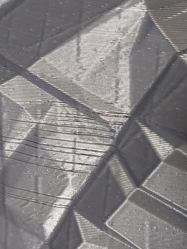

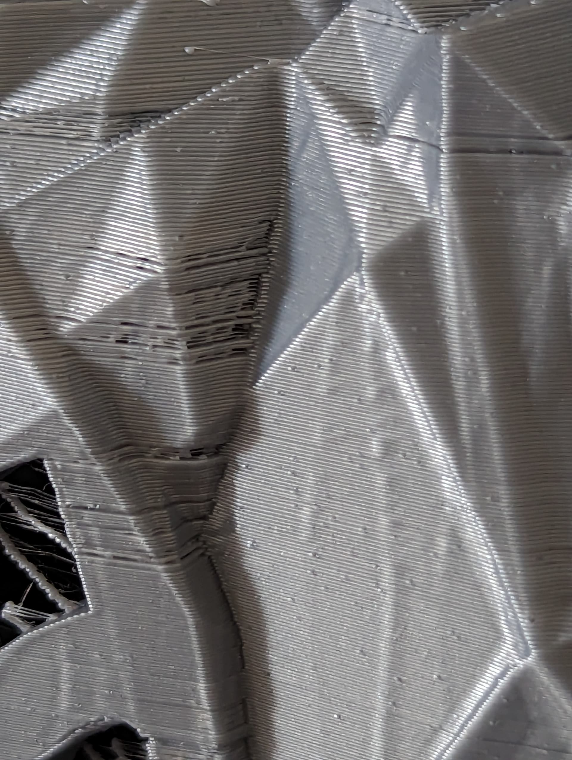

I guess no retraction didn’t work ☹
 ![PXL_20230823_083945557](https://us1.discourse-cdn.com/flex022/uploads/snapmaker/original/3X/6/7/67163fdda35467edb3817f939b3488851747d820.jpeg)
 ![PXL_20230823_084003801](https://us1.discourse-cdn.com/flex022/uploads/snapmaker/original/3X/2/4/24b109ebede450e2e2856aed31b915ee7e2c448b.jpeg)
**Author:** ![Rwide](https://sea2.discourse-cdn.com/flex022/user_avatar/forum.snapmaker.com/rwide/32/27055_2.png) [@Rwide](https://forum.snapmaker.com/u/Rwide)\
**Post date:** [August 23, 2023, 4:01pm UTC](https://forum.snapmaker.com/t/3d-printing-problems-i-have/32551/73 "2023-08-23T16:01:00Z")
@Marius87bv Seems like some type of blockage. I would probably dissassemble the hotend at this point… Maybe 250 e-steps was too much?

Don’t know anymore… the part seems alright in places
 ![PXL_20230823_161339591](https://us1.discourse-cdn.com/flex022/uploads/snapmaker/original/3X/0/1/011b5309d806bc081ff1a7b2e24d7703fbd8dde0.jpeg)
What would you suggest to do if I cake out the hot end?

Inspect the filament pathway and make sure there is no blockage. Could be a piece of broken filament or previously melted/softened plastic somewhere. However there are other things you can try first if you want to avoid dissasambling the hotend/toolhead.
1. make sure your z kinematics are ok. Do this by printing an object 2 times with the same settings and placement, but with different speeds. Then compare the objects to see if the horizontal lines match. Id they do match, your z kinematics could be the issue…
2. you could try a few “cold pulls”
3. you could try unclogging through the nozzle with an acupuncture needle.

Ah yes, so I have changed the hot end just before starting this tread… Just to eliminate the clog suspicion… The previous hot eng was new as well but took it out just for me to see how it actually looks inside…
The ptfe inside as new… The inside of nozzle full off melted filament… no leaks…
Will print a couple of calibration cubes…
Just thinking that on lower layer height these issues disappear… Or not noticeable…
Maybe I need to change line width from 0.4 to something different… just not sure on the ratio

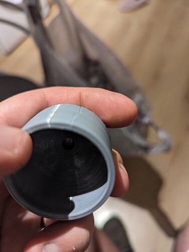

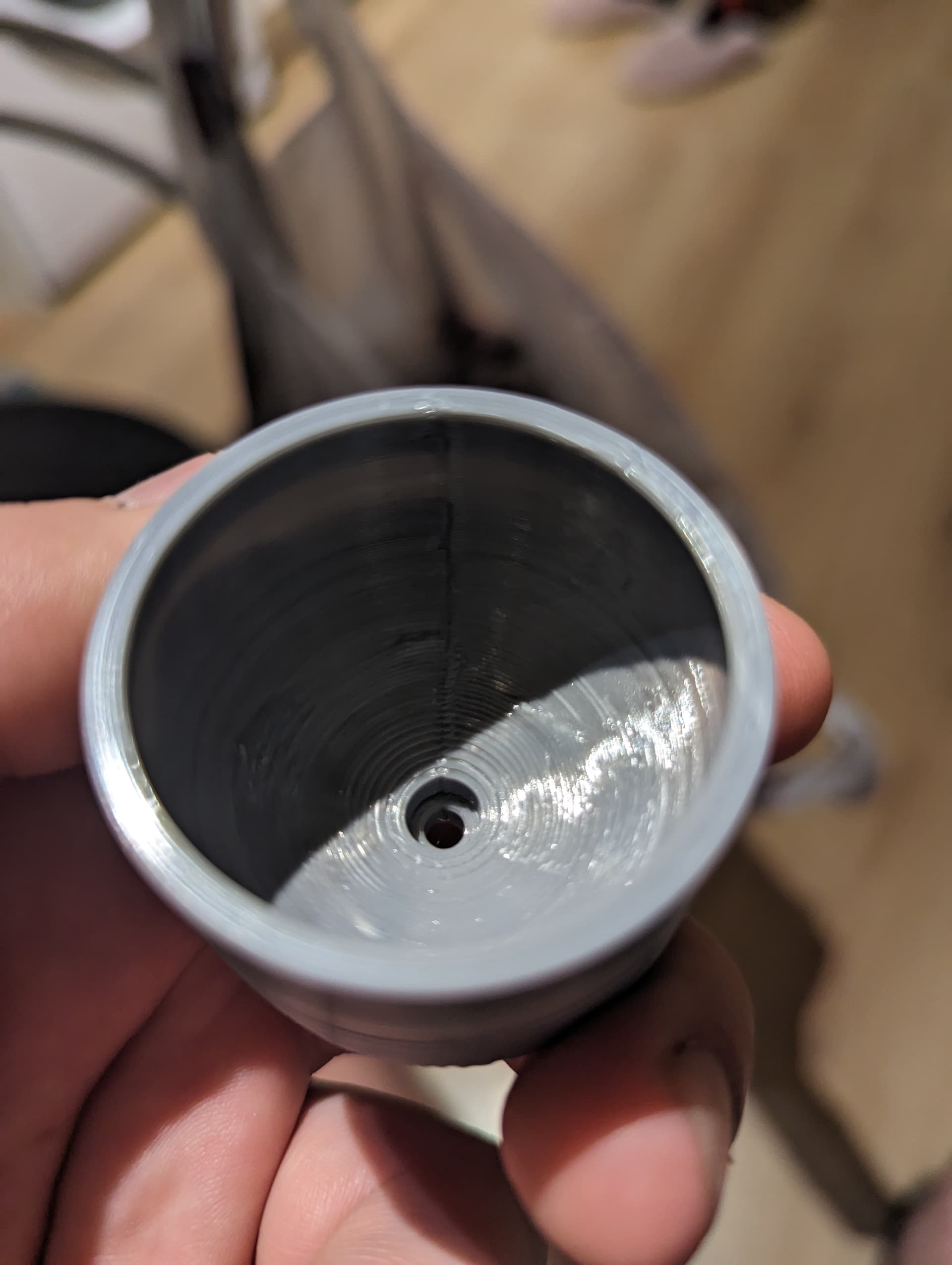

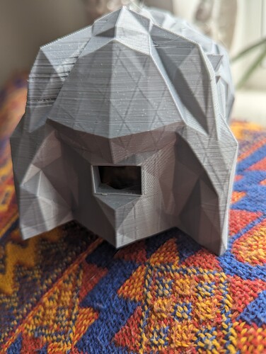

Under extrusion on long travels
And then not sure what this is
Seam supposed to be straight
 ![PXL_20230823_204737756](https://us1.discourse-cdn.com/flex022/uploads/snapmaker/original/3X/4/1/412fd8fa37f60bae70f28d5d02d71d954a9e9fa2.jpeg)
On the inside it’s straight
 ![PXL_20230823_204801836](https://us1.discourse-cdn.com/flex022/uploads/snapmaker/original/3X/0/a/0a73b9e9186d77b9415adf4be17f5027a2bb227a.jpeg)
Maybe it supposed to be in the same place?
 ![PXL_20230823_204817188](https://us1.discourse-cdn.com/flex022/uploads/snapmaker/original/3X/c/8/c84ce5cb7df3eeff3fde9579e0ad05f55ecd786b.jpeg)
Not sure what the printer tried to do here
 ![PXL_20230823_204841226](https://us1.discourse-cdn.com/flex022/uploads/snapmaker/original/3X/c/d/cde91d72da7e0b4cc0bce1959f9107d074776443.jpeg)
 ![PXL_20230823_204853331](https://us1.discourse-cdn.com/flex022/uploads/snapmaker/original/3X/a/b/ab0f91fc9c766566b7373b5ab67beed1829d3bc2.jpeg)
Looks like it tries to do a knitting job… layers on top and under others…
**Post date:** [August 23, 2023, 9:15pm UTC](https://forum.snapmaker.com/t/3d-printing-problems-i-have/32551/80 "2023-08-23T21:15:44Z")
@Marius87bv seam looks normal to me. You can see where the seam is placed in the slicer preview before you print. Are you sure your part cooling fan is working?
