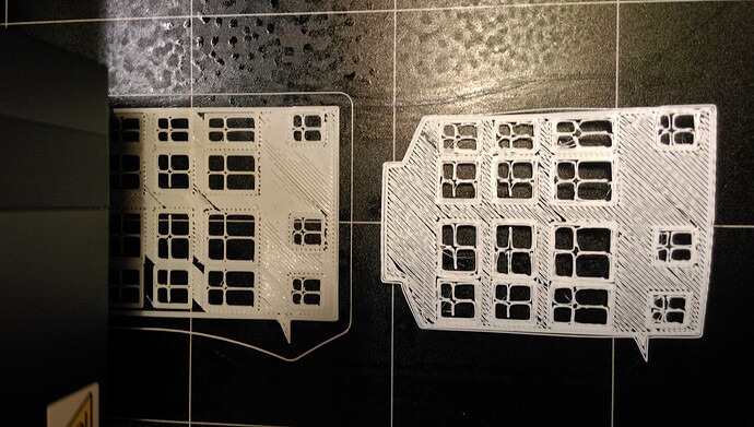

### Author: ![robin](https://sea2.discourse-cdn.com/flex022/user_avatar/forum.snapmaker.com/robin/32/7912_2.png) [@robin](https://forum.snapmaker.com/u/robin)
#### Post date: [November 10, 2020, 11:04am UTC](https://forum.snapmaker.com/t/3d-printing-home-calibration-unstable/11220/26 "2020-11-10T11:04:22Z")
I have exactly the same problem. I received the printer in mid-September.
 ![IMAG3269](https://us1.discourse-cdn.com/flex022/uploads/snapmaker/original/2X/c/cc87f558b5bbdb4a123fbb78f79295ce95975009.jpeg)

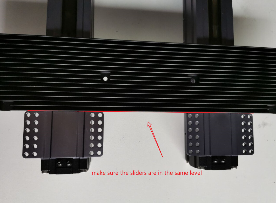

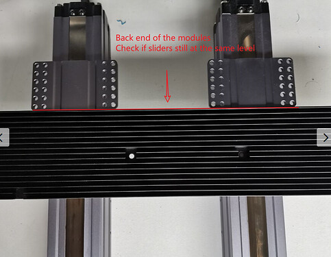

So, the first reply from Snapmaker support person had me perform some testing with the Z-towers removed and put into place of the Y-axis on the snapmaker base. Unfortunately, the Z-towers passed this test, so I am still looking for guidance from support to isolate the positioning/motion fault with the Z-axis and availability of corrective parts. For now, my A250 sits disassembled pending further input from Snapmaker support.
Following is the testing instruction and video from Snapmaker support for inquiring minds 😉 ,
I think that this issue might be caused by the speed difference between the Y axes. Could you please measure the travel length of the Z axes? I think that maybe the cause of the failure. Here are the steps for your reference:
- Dismantle the two Z axes and put them on the base as the Y axes.
- Power off the machine, push the sliders to the foremost end of the linear modules and make sure they are in the same level. Place the laser work platform across the two sliders, making sure they are on the same level.
 ![image](https://us1.discourse-cdn.com/flex022/uploads/snapmaker/original/2X/0/0fcce51d68e512d2e41090e21f92247796cf7830.jpeg)
- Here is a video for your reference:
[https://drive.google.com/file/d/19xjeb5s1dMRbnwk8myizW6YtPPk\_VasJ/view?usp=sharing](https://drive.google.com/file/d/19xjeb5s1dMRbnwk8myizW6YtPPk_VasJ/view?usp=sharing)
- Then power on the machine and click “Home” in the touchscreen. Please check if the sliders remain at the same level as the laser platform.
- And then you can control the sliders via the touchscreen. Make the two sliders 200 mm lower and check if they remain at the same level as the laser work platform.

### Author: ![Chriss](https://avatars.discourse-cdn.com/v4/letter/c/c37758/32.png) [@Chriss](https://forum.snapmaker.com/u/Chriss)
#### Post date: [December 2, 2020, 10:22am UTC](https://forum.snapmaker.com/t/3d-printing-home-calibration-unstable/11220/31 "2020-12-02T10:22:13Z")
Hey Jim,
Hello all,
that sounds familiar in a way. Perhaps my recent experience with the dual y-axis can help you any further:
I was tinkering around with the cnc function and manual written gcode for a while, when i realized that my results were sometimes way off on the y-axis. I noticed a “bump” in my y-axis, similar as described here and elsewere:
> [@Lineal modules: Non-uniform working speed](https://forum.snapmaker.com/t/lineal-modules-non-uniform-working-speed/10715):
> Hi all, I think that some of the several problems being reported in this and other forums are caused by the same issue: the non-uniform lineal modules working speeds. I will try to summarise in one post my experience and how I have “solved” (or better said, hacked) the problem. First of all a bit of background: I ordered my SM 350A in July 2019 (as part of the pre-sales batch) and received it in mid September 2020. I am using Luban 3.9 with the firmware version 1.9.0 . Since the beginning I h…
I disassembled the whole machine,
put all 5 linear rails on a table,
connected them each after the other to the controller without the y-splitter,
moved the slider with the jog in Luban to one end and 2mm back,
marked the position of the slider on the case of the rail,
moved the slider with Lubans control panel a long distance (i think it was 300mm),
and measured the distance to the initial point.
I repeated that for all modules each 10 times.
The measured distances differed from the ones entered in Luban, but the errors were nearly repeatable per module each time. I interpret that as an not really satisfying manufacturing tolerance.
I found one of my linear modules (used in the y axis before) having a repeatable difference compared to the other around 1-2mm. That caused the two modules used as y axis to build up tensions to each other when traveling distances above ~170mm , as they didn’t move the same distance. These tensions released in the noticeable “bump”, causing the y axis to “slip”.
After changing the modules for the axes and grouping them in pairs with similar errors, reassembling the machine, the control is now usable at least.
It was a low-cost and not-waiting-ages-for-support-to-react workaround after all.

### Author: ![jmeckstroth](https://sea2.discourse-cdn.com/flex022/user_avatar/forum.snapmaker.com/jmeckstroth/32/8074_2.png) [@jmeckstroth](https://forum.snapmaker.com/u/jmeckstroth)
#### Post date: [January 18, 2021, 6:49pm UTC](https://forum.snapmaker.com/t/3d-printing-home-calibration-unstable/11220/32 "2021-01-18T18:49:54Z")
@brent113, et al. I think my A250 is finally stable. Snapmaker (via Edwin) replaced two of my linear drives under warranty, and I purchased 3 more linear drives. All of the new replacement linear drives shipped from their California warehouse, I am told, are of the “revised” design (basically revised circuitry inside). With all the linear drives replaced, the A250 positioning has been stable now for several weeks and I can get back to using and tuning my 3D printing, laser and CNC projects. Potentially, the removed original linear drives can be reworked with new circuit boards at some point, as backups.
