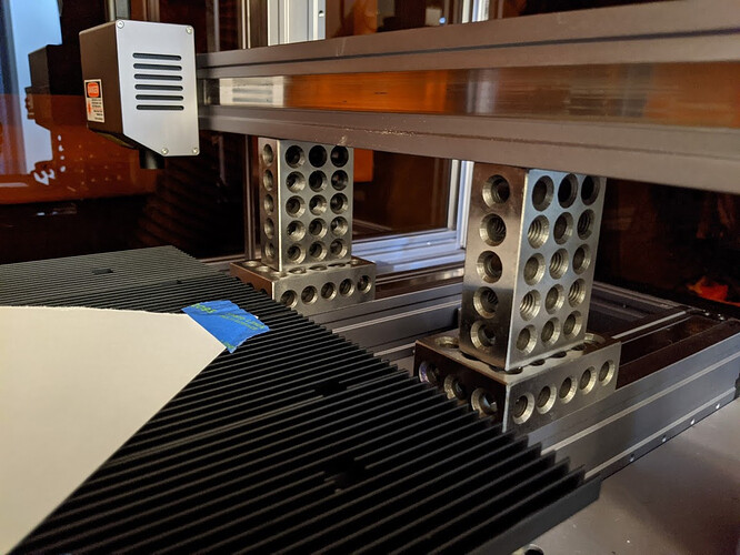

There’s another issue though - the positions of the 2 Z tower mounts. I had to do this for mine, with the machine off:
 ![image](https://us1.discourse-cdn.com/flex022/uploads/snapmaker/original/2X/2/25ffb635f97ce860ad6b8d80bff3eab7cf530de3.jpeg)
What happened was the X axis was not actually level, and also the stops at the top of the Z axis the instruction manual tells you to use were not in the same place. I had to make a new reference off the Y axis modules to get it level. That fixed a couple issues I was having - namely, from week to week the Z heights would change slightly - I think the X axis was dropping slightly on 1 side.
When the machine homes - it stops rising when EITHER z tower’s end stop is triggered. It does not wait for BOTH - a critical difference.

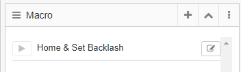

Consider turning backlash compensation on - it’s easy to do, but it won’t save, you’ll have to put it in a macro in Luban or something.
 ![image](https://us1.discourse-cdn.com/flex022/uploads/snapmaker/original/2X/1/1d91ae58b964d27f35e2d5d9394b2bc678560e25.png)
 ![image](https://us1.discourse-cdn.com/flex022/uploads/snapmaker/original/2X/2/238bcf0d3a3d1a5b8761faf3433645aeecc4ba48.png)
You can measure the Z value by jogging in Luban with a custom value of 0.02mm or so. Move down onto the card until there’s friction, and then send 0.02mm up commands until the friction decreases. If you had to issue 2 commands, then you have 0.02mm of backlash on Z. X and Y are measured differently, but I found all of mine were the same.
I say move in 0.02mm instead of 0.01mm because I found the controller will not move for 0.01mm, only every other time. Seems that 0.02mm is the smallest amount it will move. I think 0.015mm is actually the smallest, but that’s kind of silly getting into the thousandths of a mm.
