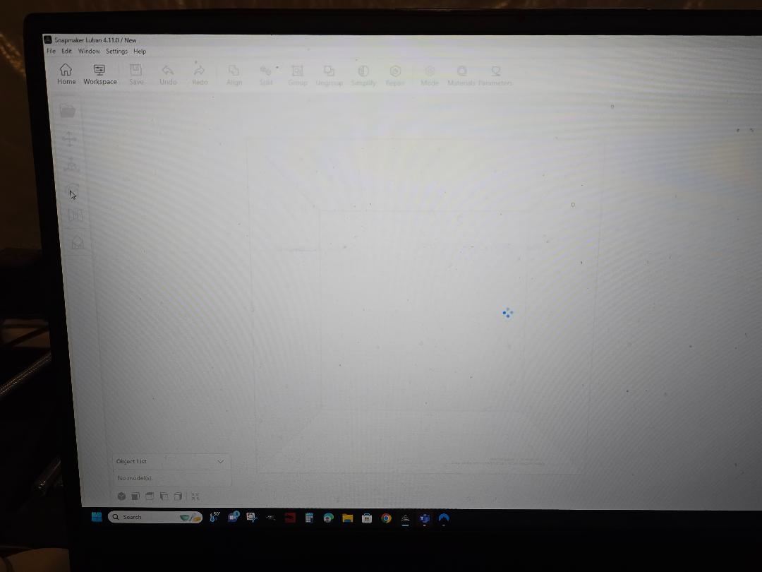

Hello, I am at wit’s end with the 3D Printer Module & Luban.
- All software/firmware is current version.
- I am using my 64-bit OS, x64-based processor, MSI GP75 Leopard Laptop running Windows 11, 16GB RAM
- I have had my Snapmaker 2.0 A350 for three years and a month and have used the Laser module and CNC module multiple times with no issues. I finally decided to try the 3D Print module last week. I hooked everything up and updated all the software/firmware.
- When I open Luban (Version 4.11.0), I can click on Laser or CNC and the workspace and controls all open as normal, but when I click on 3D Printing, It starts to open the workspace, but only allows the following items to be clicked on: File Edit Window Settings & Help, the The Home and Workspace Icons are clickable and allow you to go to the those pages, but you can’t import .stl files. Attached is .jpg’s of what happens. Any assistance would be greatly appreciated.
TY, Ron B.

Hi Ron, I noticed in the top right hand corner of the second photo you have a Snapmaker Original selected. That needs changing to the Snapmaker you have. I think it is an A350T? Give that a go and report back. Cheers - Stu
**Author:** ![imanafman](https://sea2.discourse-cdn.com/flex022/user_avatar/forum.snapmaker.com/imanafman/32/11751_2.png) [@imanafman](https://forum.snapmaker.com/u/imanafman)\
**Post date:** [March 21, 2024, 4:08am UTC](https://forum.snapmaker.com/t/3d-print-module-1st-use-luban-error/35380/3 "2024-03-21T04:08:50Z")
Yes, that is because I deleted and downloaded Luban again and that’s the original setup. I changed it to 2.0 A350 and still get the same outcome. Thank you for the advice, though. I am awaiting a response from Snapmaker Support again after updating them.
Ron
**Author:** ![craftycarper](https://sea2.discourse-cdn.com/flex022/user_avatar/forum.snapmaker.com/craftycarper/32/20513_2.png) [@craftycarper](https://forum.snapmaker.com/u/craftycarper)\
**Post date:** [March 21, 2024, 4:39am UTC](https://forum.snapmaker.com/t/3d-print-module-1st-use-luban-error/35380/4 "2024-03-21T04:39:20Z")
Hi Ron, that’s all good. So, just to recap, when you first start Luban and you get the 4 options. 3D, Laser, CNC and Workspace. Going into Workspace you can connect to your printer and see the modules, heated bad and extruder with green dots denoting them as active? - Stu

I noticed this option on the menu… run app in default browser… if you do that do you have the same problems? This won’t be a perfect fix, but could point to the problem…
![browser](https://us1.discourse-cdn.com/flex022/uploads/snapmaker/original/3X/2/0/20e66214116abb55a3bef8132e260ef0cdec7b95.jpeg)

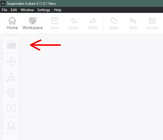

**Post date:** [March 23, 2024, 12:41am UTC](https://forum.snapmaker.com/t/3d-print-module-1st-use-luban-error/35380/11 "2024-03-23T00:41:50Z")
Another observation is this…
![luban_fault](https://us1.discourse-cdn.com/flex022/uploads/snapmaker/original/3X/3/e/3eafdd9d4ca7b63025450431b39d66d1a80ca04d.jpeg)
Choosing 3D Printing from the Home menu I noticed that the “open folder” icon is greyed out until the 3DP software module fully loads. Note: “File Edit Window Settings Help” remain available at this time. This suggests that the 3DP module is not loading correctly or at least not finishing loading. This could be a file/folder permission problem with your OS as the module is loading, or simply a corrupt software module in Luban. Is your workstation user type an Administrator equivalent? Try running the software as an Administrator. Otherwise I would be tempted to check file permssions and (again) uninstall Luban, scan and repair my registry then download and re-install a fresh copy. All shots in the dark I’m afraid…
